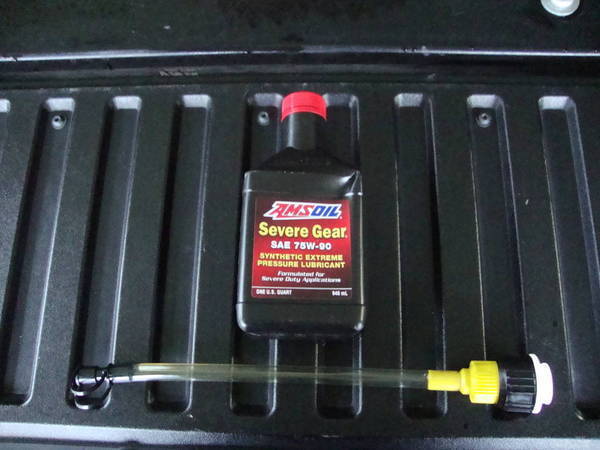

    Drain plug
    Fill plug

    Thanks for this write up it definitely saved me some cash. To those of you who haven't done this yet this tube worked great just something to consider when it's time.
