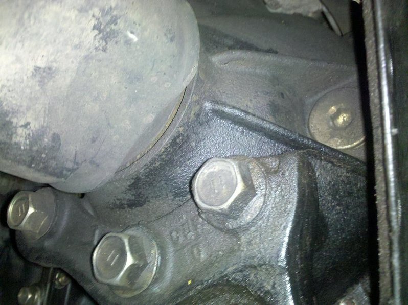

    OK two things.
    First I changed my rear diff fluid with Royal Purple and wow did it make a difference. The old oil was disgusting, and I have no idea when the previous owner last changed it. Also, by changing that and the transfer case fluid, I no longer have a loud chatter when I go into reverse in 4WD. The first time I used 4WD and went in reverse it scared the crap out of me, but now that I changed the oil it's gone. Which leads me to my question.
    I took a picture of what I think was the front diff drain, but I still have no idea which is the fill port. I apologize for asking again, but I'm seriously lost, and still very much in the learning process when it comes to vehicle maintenance. Thanks for the help.

    I'm pretty sure that's the fill plug. The drain plug should be lower.

    I finally found the front diff fill port...it was half way up the front side of the diff, and I had to take the panel below it off to make it accessible. After that I just hooked up the pump from the gallon jug and pumped it full of RP.
