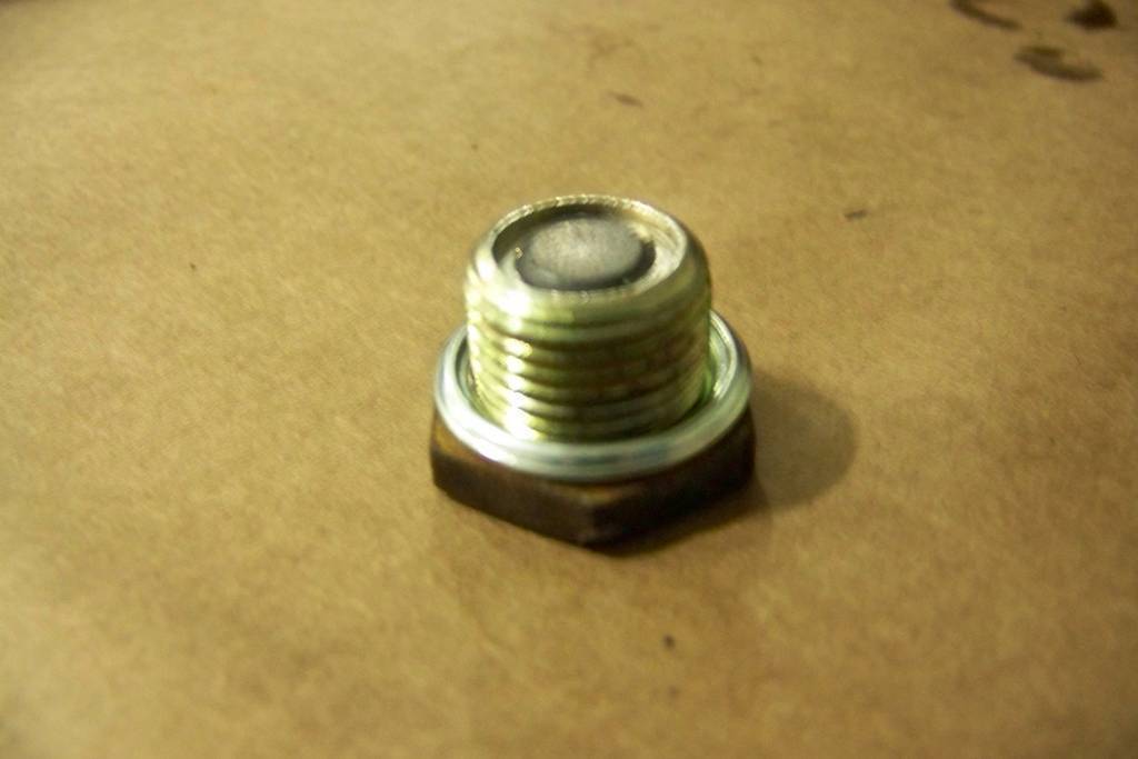

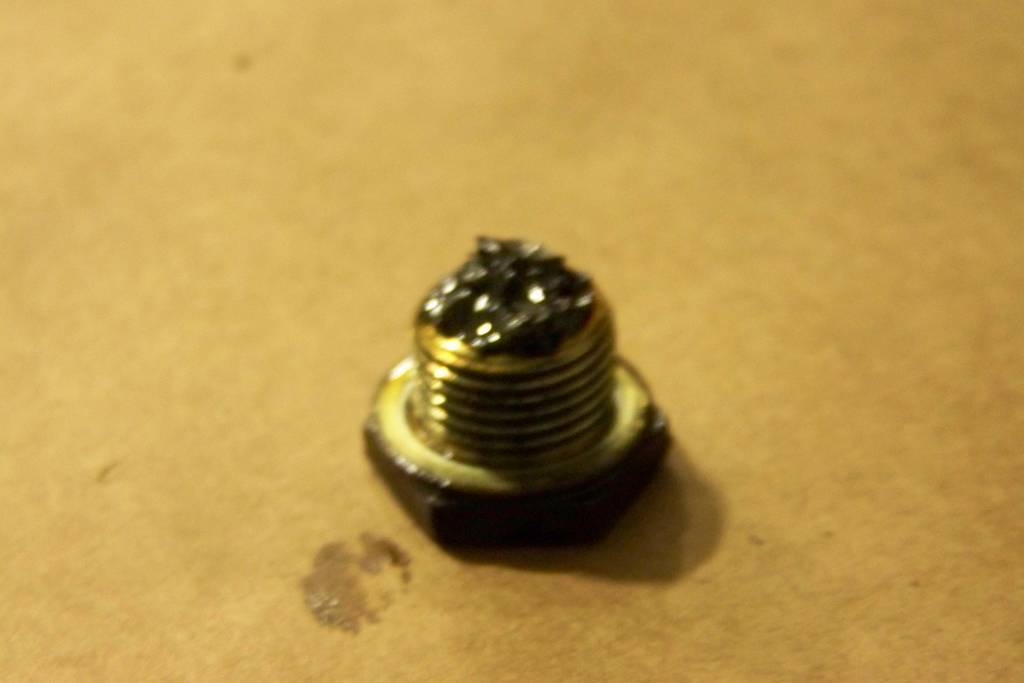

    Just finished my diff oil change,
    Here are a few pics of the plug...
    Before,
    After, It was just dirt, no big chunks.
    These are the gaskets, old and new.
    See the difference between the two, they are one trime use crush gaskets.
