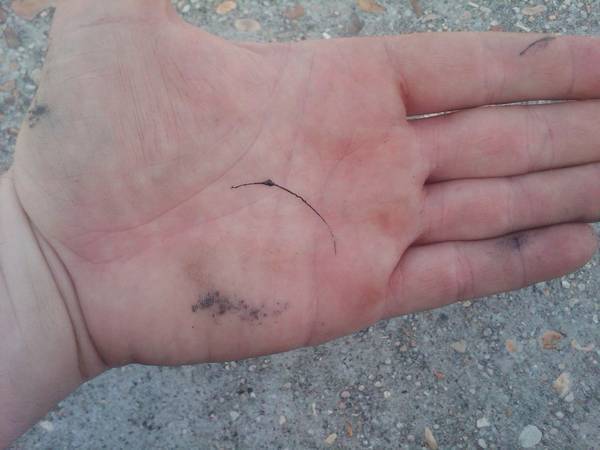

    Doing mine this morning (only 5K late...)
    How bad was the metal sludge on the mag plug for anyone with the mechanical LSD and what do you guys think of this sliver:

    Pic didn't work.

    ok so ive been reading this post for about 30-45 mins now and everyone seems to be talking about mechanical and electronic lsd's what if you are like me and just have an ole one wheel wonder? anything special i need to know before buying the diff oil? should i go synthetic or stay dino? thanks for the advice.

    mine both front and back were pretty bad.. I didn't notice any slivers, but did have a hunk of junk on the magnets

    Yea that works now. I don't see anything I would be too worried about there. Looks OK just part of the clutch material wearing. That is the reason for the magnetic plug.:thumbsup:

    For One if you making picture of particles make on white paper :D
    From picture that does not look bad at all, when you say 5 k Late , how long since the last change and what oil did you run it. I had probably much more particles after 12K running on original factory oil. But I also towed in that 12K

    Yeah...I'm pretty familiar with magnetic plugs...The helo has a few of them...
    I didn't have a white paper nearby and the hand gives you some idea of size....
    I'm at 34K and change...It should have been done at 30K. I still had the stock from the factory oil in there until now. This time I used 80W-90 Lucas Gear oil with whatever LSD addative that AutoZone had.
