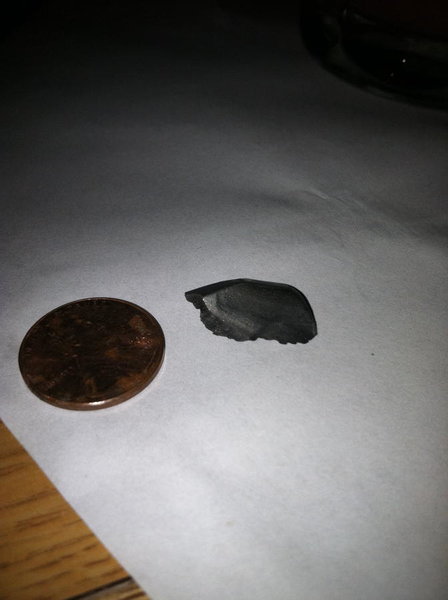

    I was changing the rear diff on my 2010 trd sport 4x4 at 28000 miles, and this was on the magnet!!!!!! I know i need to take it in but will the stealership try and screw me so as not to be liable for it themselves since i do my own maintenance? how long can i go with this big of a a peice of gear?

    That is scary:eek: Wonder how could that happen with an automatic ?

    I know! i go offroading but have never really done much that i can think of that would cause this. I did have issues with my 4wd not kicking in and the damn light flashed like it was trying to ingage, took it in and they replaced the front diff/transfercase actuator and now it works fine turns on and engages and turns off fine, but what the hell?
