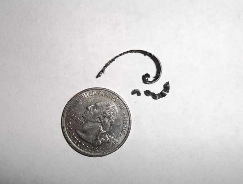

    Did my rear diff today, and found these pretty big pieces of metal shavings. Everything else looked okay. How alarmed should I be? Should I take it to the dealer immediately to be checked?
    Thanks!

    Looks like normal debris from a first diff change. The next one should be clean.

    holy crap, your serious? that's some big debris. Thanks for clearing that up though Chris, I was in a bit of a panic when I saw those metal shavings.
    Any ideas why this happens?
    Thanks again
