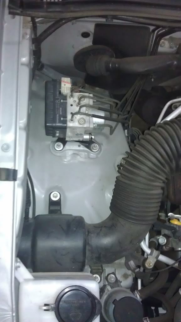

    if you open the hood, and look at the passenger side wheel well, is there a box with a bunch of brake hard line coming out of it? if the answer is yes, you dont need additive. if you have NOTHING on the wheel well, you DO need additive.
    Im not positive, but I believe its 09-current that have that box. let us know what you find.

    This is my passenger wheel well

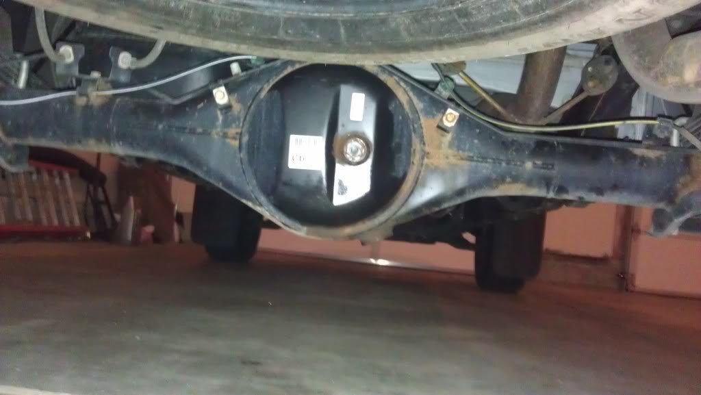

    I think I have the LSD, my truck is an 08 and it has the LSD Oil Only sticker on the diff cover shown as the white vertical rectangle below.
    I put LSD Oil in it but I was wondering if I should get the tube additive as well. I'm not sure if I'm imagining it, or if it is my tires, but it sounds like a chirp noise when I take turns at around 20+ mph

    you dont need the additive because that box uses your brakes to create the effect of a Limited Slip Diff
    (at least thats the way I understand it. Correct me if I am wrong)

    If the rear end has an LS Diff oil sticker, then it has a mechanical LS Diff, and requires the addative.

    Oil that says "LS" on it, doesnt have the addative. The "LS" means its safe for use in LS diffs. Its a marketing thing. Use the addative pictured in the first post.

    "Yesterday we (Chris4x4, and I) got together to help you all change your diff fluid.
    Here is what is required;
    -24mm socket (1st gen diff may be a different size)
    -ratchet
    -rags/shop towels
    -milk jug or coffe can... EMPTY ofcourse!
    -3 qts 75-90 weight gear oil ( I used 80-90 becasue it was readily available)
    (for you guy like me w/ the Sport model, you'll need a 4oz. tube of LSD additive)."
    From the first post - Yes, if you have the sticker you need the additive
