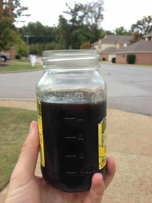

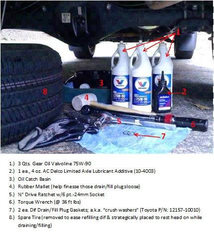

    Hey guys, thanks for the how-to...I just serviced my diff after 101,000 miles.
    Used this:
    79067ACA-D5A4-4EC8-A243-B8C182A1FDD4-107_b067a98d76ca381f6f4f356eb95c8aaf049c51c2.jpg
    Here's what the old stuff looked like after 101,000 miles:
    5AFA2A4B-D494-4AA1-8B2F-A69BCC3C73E2-107_0024208f84b4381694be2f0205d542c4e355d4d9.jpg
    Found 3 chips on the magnetic drain plug. Kinda seems like manufacturing debris to me. Anyone have any thoughts?
