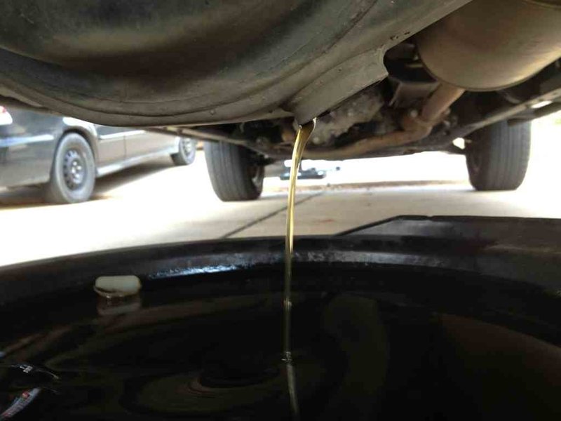

    Changed mine this morning. My oil was not black it looked brand new. Is this normal? I do tow my boat a good bit. I am at 30,000 miles. I was expecting some blackness.

    I don't know what normal is but mine was gray, nasty and foul smelling at 30,000. That was what ever Toyota put in it. I put in synthetic. The synthetic was beautiful looking and no smell at 60,000.

    Wow..... You have a 2012 with 30K miles? Perhaps that has something to do with it? With a lot of miles in less than a year....factory oil, no climate extremes??
    Mine was black. I changed it at 26K miles back in May 2010 (3 year old oil). Mechanical LSD with factory oil/modifier. I put Mobile 1 in with XL3 modifier (2 bottles). I'm curious to see how the Mobile 1 will look....I'll be changing it again this summer (I have 55k miles on the truck now).

    An open differential is not as hard on the oil as a mechanical LS Diff is. No clutch packs to heat up, and degrade the oil. Looks like normal oil for that milage.
