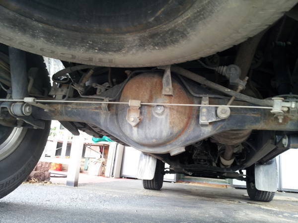

    Ok, please bear with me. I'm really trying here. I'm trying to catch up on some long neglected maintenance. (Did my plugs yesterday and took lots of pics so I might do a write up from a fairly noop perspective.)
    I have a stock '04 Pre-Runner Xtra cab with 123k miles. I'm assuming it has LSD for it's not a 4 wheel drive and it has nothing fancy other than ECT (which I've never totally understood.) So I assume it would need the LSD additive though I see nothing in my owners manual about it?
    Also in my owners manual it shows the following amounts with or without differential lock system. Not terribly sure what that is but I'm going to guess I don't have that. I'm also going to assume I have the short wheel base and not the xtra long wheel base.
    Rear - without RDLS = 2.7 qts.
    Does that sound correct? And would that be 2.7 plus the additive? Or do I even need the additive?
    Thanks, and apologies in advance. I haven't read all 50 something pages of this. I read the first few and the last few.

    Look at the rear end and see if there is A white sticker that says LSD in black letters.

    Ok, I see no such sticker.

    3 quarts of an 80w90 or 75w90 will do good for ya. not sure if you have an lsd or not, but you can add a little additive and its not going to hurt anything either way.

    he doesnt have an LS Diff. Its an Open diff, and needs no addative.
