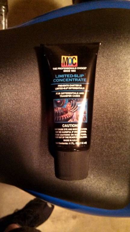

    FYI, I was just at the stealership to get the gaskets and LSD additive and they said that Toyota recommends their additive or the GM one. Here is what I picked up:

    Nice write-up, makes me feel confident enough to do this myself when I change my oil in 800 miles.
    Just to be clear, I have a 2008 TRD OR, so I'm guessing I need the LSD additive, right? And is there only one type of gear oil? For example, synthetic vs non-synthetic?

    No you dont need LSD additive, you have a locker and i would use Mobil 1 synthetic in 75-90. May as well do front diff and transfer case also, they are just like the rear. Same concept.

    "(for you guy like me w/ the Sport model, you'll need a 4oz. tube of LSD additive)." from the very first post in the thread. ONly the sport's need the additive.

    ^^^^^WUT!^^^^^ If you have a OR with a locker you do not need LSD additive. Thats some complicated shit you just wrote right there!
