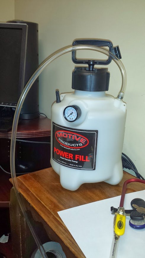

    Thanks for the link. I have their Power Bleeder. I bet I can adapt it to fill the dif/t-case and trans. Thanks for the idea.

    no problem. Going to pull the trigger to get one tired of making a mess everywhere :facepalm: :annoyed:

    yea i have messed with one of those and the plastic was so brittle after while, I was pumping and the entire pump went into the bottle :eek:

    :gossip: he means put it back in, as in don't forget ;)
