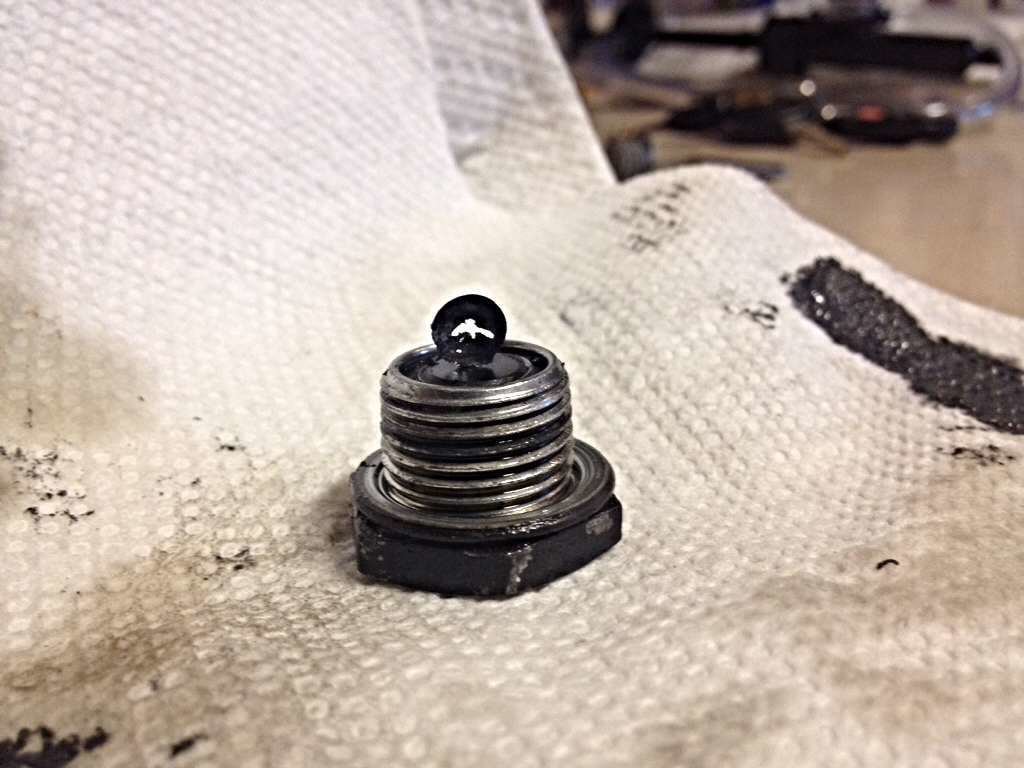

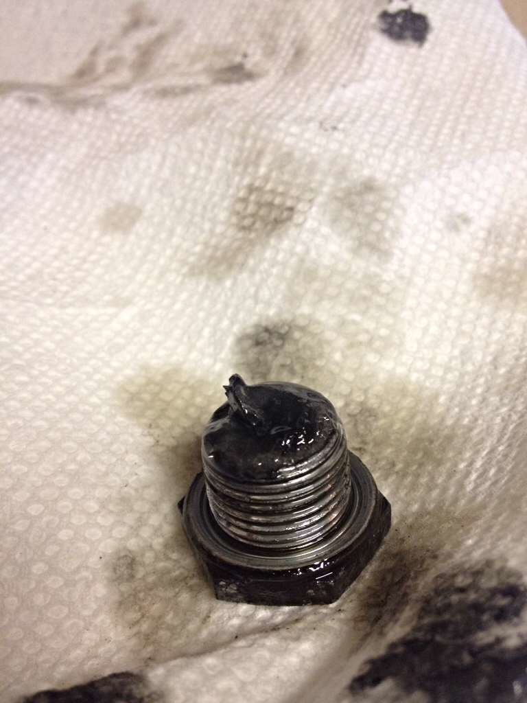

    Changed the rear diff oil, very easy to do! Put in 3 quarts of 75w-90 valvolene non synthetic was used and I'll start changing it yearly instead of every 30k
    Should I be worried about that small circle of metal stuck to the magnet? Cleaned off the normal looking metal from the magnet.

    chris4x4 With sufficient thrust, pigs fly just fine. Moderator
    May 8, 2008
