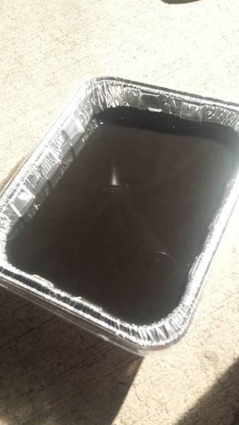

    Nice straight forward process. Wasn't sure if mine had ever been changed since I purchased it users. Has 68k miles on it now and I put 15k on it. Changed it today and it looked like milky caramel. Figured it was best to change it regardless.
