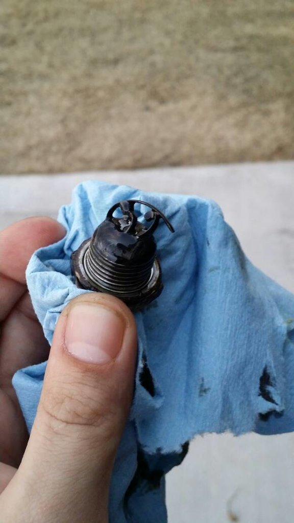

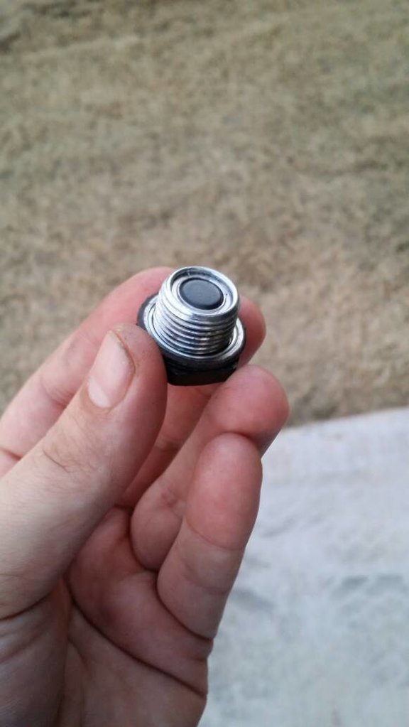

    Any thoughts on of this is okay? I don't know when the last time the fluid was changed and I'm almost at 100k.
  18. Jan 20, 2015 at 11:56 AM
    #1738
    chris4x4
    chris4x4 With sufficient thrust, pigs fly just fine. Moderator
    May 8, 2008
    #6497
    112,751,684
    FlimFlubberJAM
    Tenoe, AZ
    2019 Rubicon 4 Door,
    4.10 gears, sliders, and lots of buttons.
    If that's the original oil, I would say that looks normal.
  19. Jan 20, 2015 at 1:40 PM
    #1739
    BeaverYota
    BeaverYota Oregon State Edition
    Apr 15, 2014
    #127721
    2,541
    Josh
    Lake St. Louis, MO
    Sold...
    Awesome. Thanks for the reply. I just wanted to make sure I didn't have shards breaking off my gears or anything
