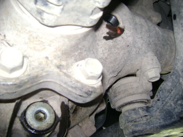

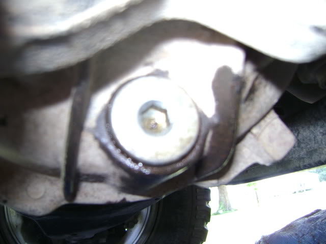

    Pic of front diff, drain and fill plugs.
