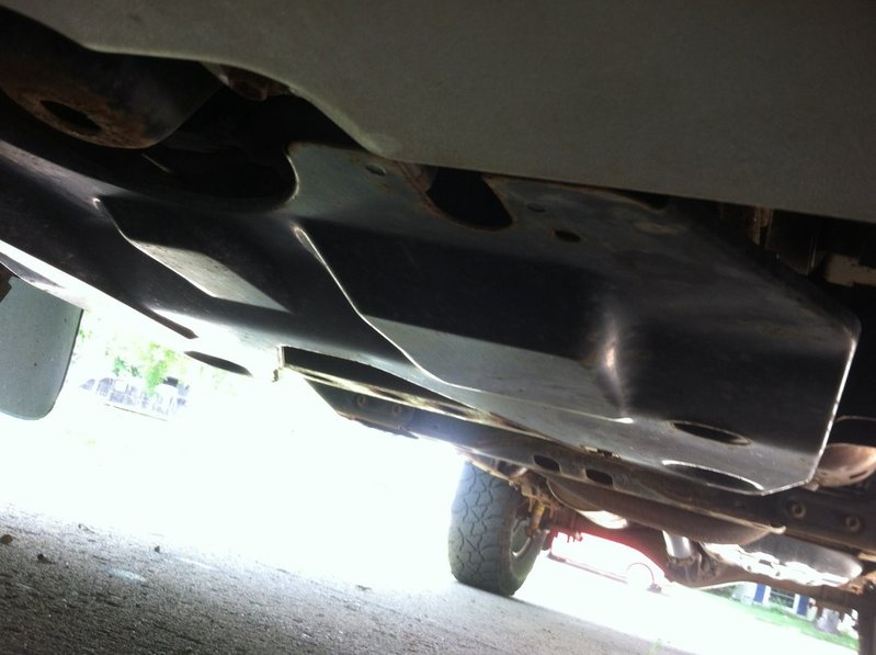

    Hello!
    I've got a 2008 Tacoma TRD Off Road (6-speed manual) that I bought a week ago and changed the fluid yesterday on my rear differential, transfer case, and transmission. I'm trying to get at the front differential, but the bolt heads snapped on the black plate underneath the front differential. They broke far enough up that the back (closest to bed) is loose, but I'm not seeing how to get the front off. Any advice? I looked through the forums but didn't see anything specifically on this.

    A grinder to get the heads offt. Then Drill the old bolts out and re tap the threads. Or try some heat
