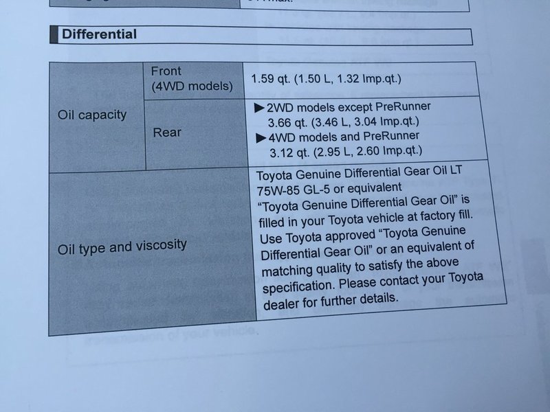

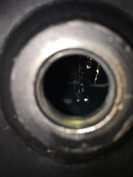

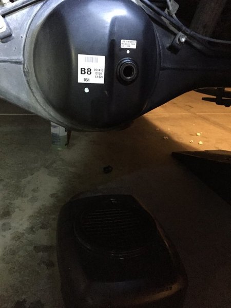

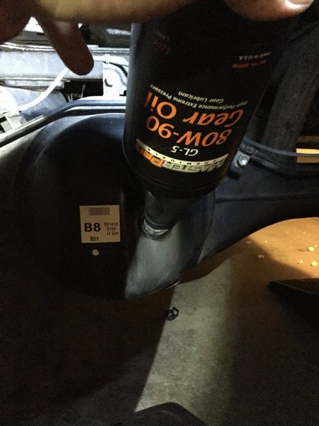

    Replaced my rear diff oil for the first time tonight. Very straightforward especially with the help of this thread!
    My I drive a 5 lug and the manual calls for 3.66 qt, so I bought 4 quarts of 80w90 (only thing aval at my local parts store). When filling it took all 4 quarts without spilling out. (I was on ramps with the rear lifted). Also when pouring the used oil into the empty containers it was just about 4qt already in there.
    I lowered the spare tire and that gave me lots of room to refill and didn't have to use the funnel hose I purchased.
  11. Sep 24, 2015 at 8:41 PM
    #1891
    FlightMedic178
    FlightMedic178 Well-Known Member
    Dec 2, 2013
    #117789
    112
    Nate
    Phoenix
    2020 SR Utility, 2013 Land Cruiser
    Bone stock
    Huh? :) what am I missing?
