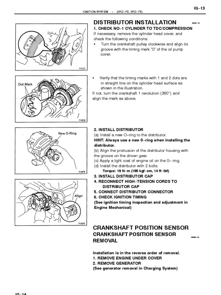

    Mentioned it in the beginning of the thread to check timing.
    Refer to figure 4

    I edited this. I meant to say computer looks at crank and cam sensor and compares them.
    Yes, when they changed to coil packs in 1997 there was a separate cam sensor mounted on the side between 2 & 3 cylinders on intake side, and the distributor hole was blocked off with a plate.
    Correct, just follow the directions for "2. Install Distributor" posted above. Specifically, study step 2.(b) Align the protrusion of the distributor housing with the groove on the driven gear. And look at the illustration.
    Even then it might go in a tooth off.
    Good luck!
