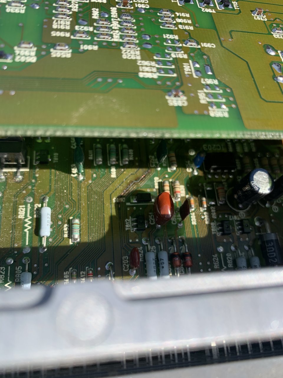

    F1B0C918-035D-41CE-83DD-50C108BDC24A.jpg So is this ecm trash now?

    Since the cam position sensor is inside the distributor, a broken wire could cause the computer to not get the cam position signal, but that might throw a different code.
    I couldn't see exactly where the ECU was burnt in the picture.
    I suppose it's possible if it was rewired incorrectly it could damage the ECU, but those wires go to the igniter first, so it would more likely damage that first, say from over voltage.

    Yea Ik that’s why I’m not sure why it’s damaged. C7836C5D-0587-4E76-BA35-646D3C4F84F3.jpg
    In the middle it’s a slight burn line

    Yes, I see that. It would be good to test it with an ohmmeter to see if it burned enough to lose continuity. If that trace leads to a terminal that is related to the distributor then you have more of a case that it's related to the wiring problem you mentioned.
    You or they should make sure the wiring is fixed before putting in another ECU so that another one doesn't get damaged.

    Is there a possibility it has been like that on the board and the shop is blaming that?

    Will do. Hopefully when I get the ecm back it goes well. I’m not sure if the burn was actually from this issue or it’s been burned already...
