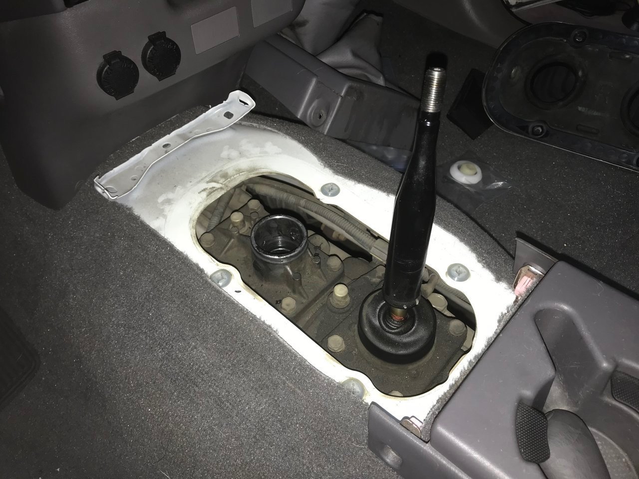

    It’s an easy job that will take 30 minutes to do and possibly replace the rubber shift boot
    as it’s 20 years old too
    GQ7227[QUOTED] likes this.

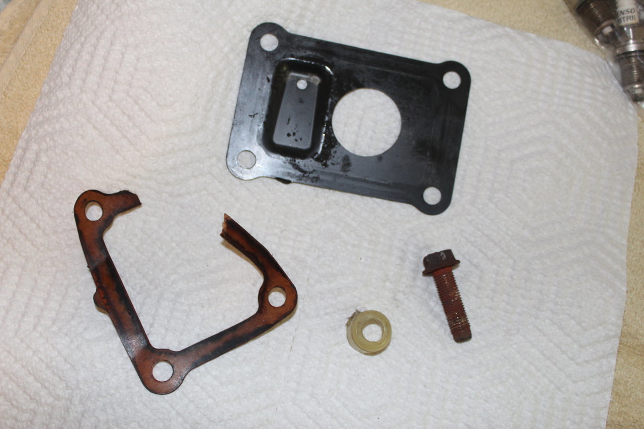

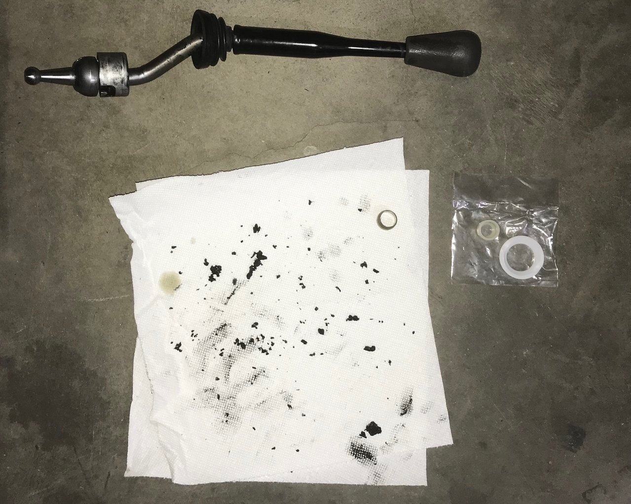

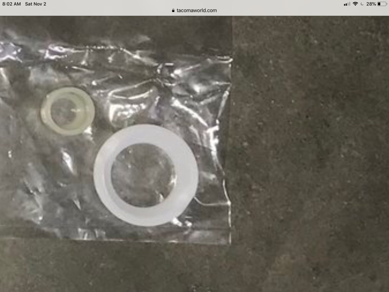

    do you think they missed replacing parts on mine? that was the part list they gave me and these were the parts returned
    it would probably take me at least that long to figure out how to get the whole console out and put back together properly afterwards since i have never removed it myself before, probably just 8 or 10 screws and untwist shifter knobs

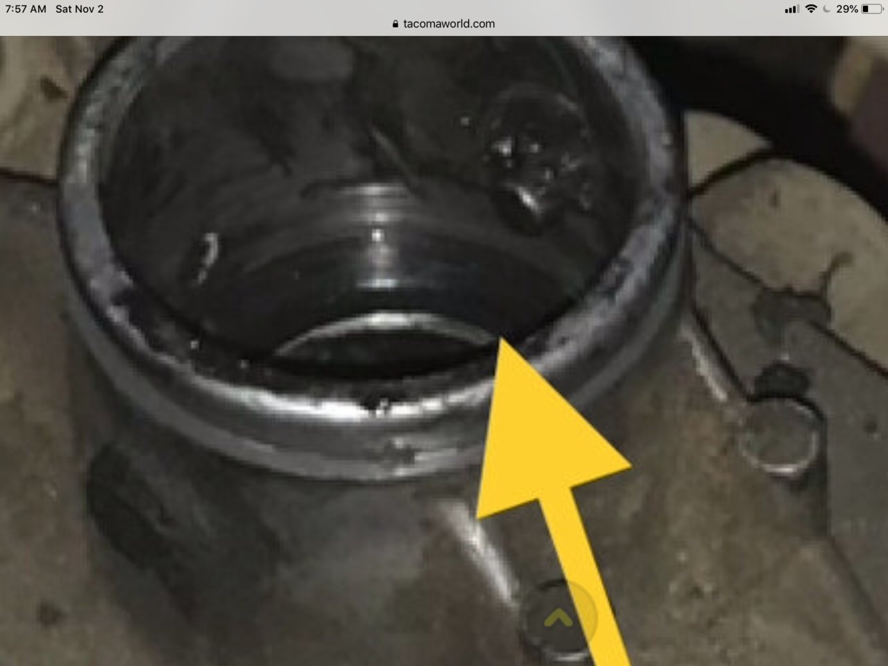

    Once you do it’s very simple a few screws and punch type pins.
    Looks like you actually had the gasket fail so those parts are correct but you should have had the collar
    there too, I actually missed mine the 1st time because it looks like part of the inside hosing covered in grease

    and the collar is what will give a smoother feel to shifting between 1st/2nd/3rd ?
    because nothing much changed after these parts were changed
    especially when its cold its bad.
    it gradually gets better once I have been on the road for awhile and everything down in there warms up some

    I replaced all the parts at the same time and fixed the issues I had before of stiff shifting except the 3rd gear that worked its self out with redline.
    If your in there you replace ALL the parts for the shifting there. It’s a 10.00 part.
    Would be silly not to replace that plastic collar

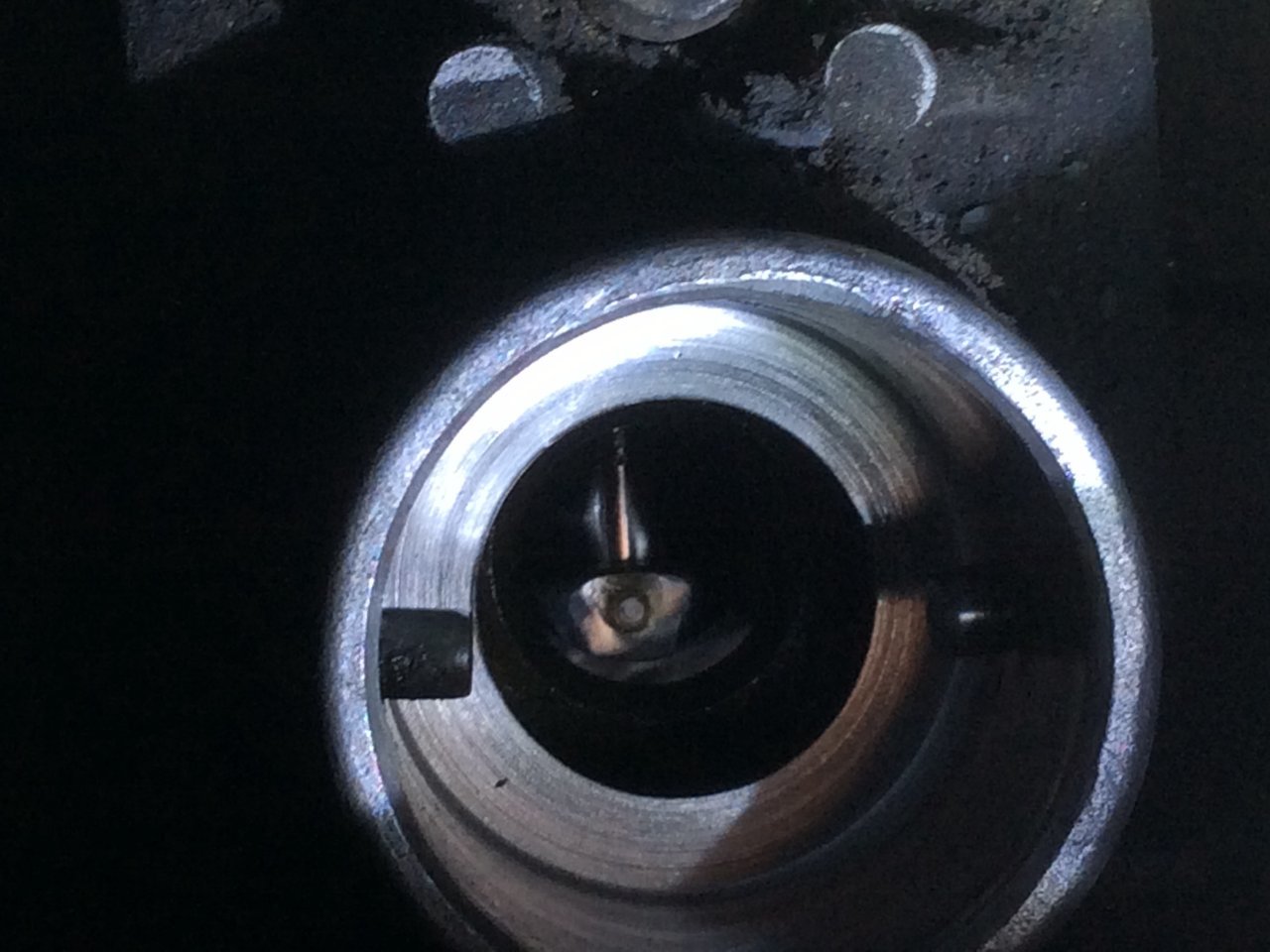

    Nope didn’t take photos of the overall picture
    This one is the inside after I cleaned it
