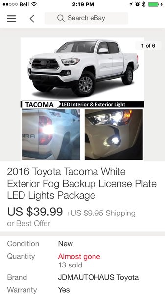

    i got some generic LED bulbs from Amazon for the headlights and my fog light bulbs came from a whole Interior exterior package from ebay
