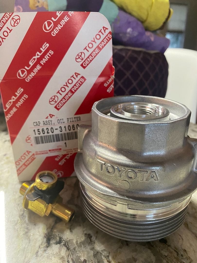

  1. Jun 4, 2023 at 3:40 PM
    patos tacoma
    patos tacoma [OP] Well-Known Member
    Jun 18, 2020
    #331792
    545
    Worth it.?

    I'm going to do the switch on my next oil change...just because--and include a Fumoto Valve in the process.

    It is absolutely worth it. If you get oil changes at the dealership or a quick lube place you'll realize I am right quickly. They overtighten the housing and it becomes a giant pain to remove; or the plastic will give and you'll be trying to take it out in little pieces.
    One of the best and cheapest upgrades I ever did to my Tacoma.

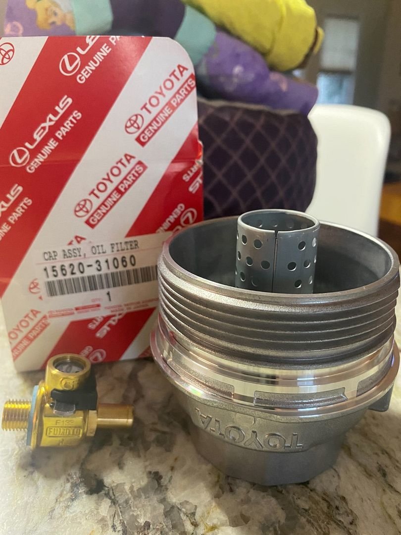

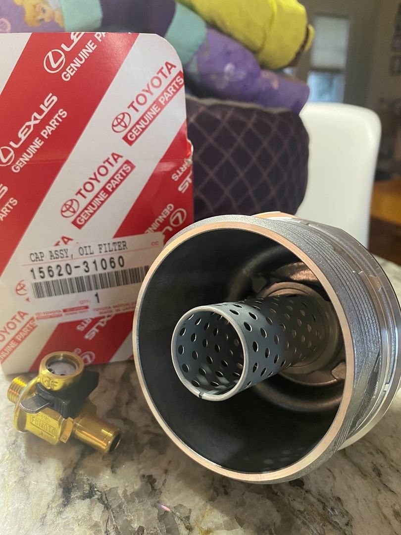

    Have you ever looked at the design? You can not overnight it. The housing flange will come in contact with the oil filter assembly at proper torque. Continue applying the torque will damage the housing.

    You said it best. Proper torque was the key. They keep going way past the torque spec. It is absolutely possible to overtighten it. Just look it up on YouTube and you'll see what happens.
