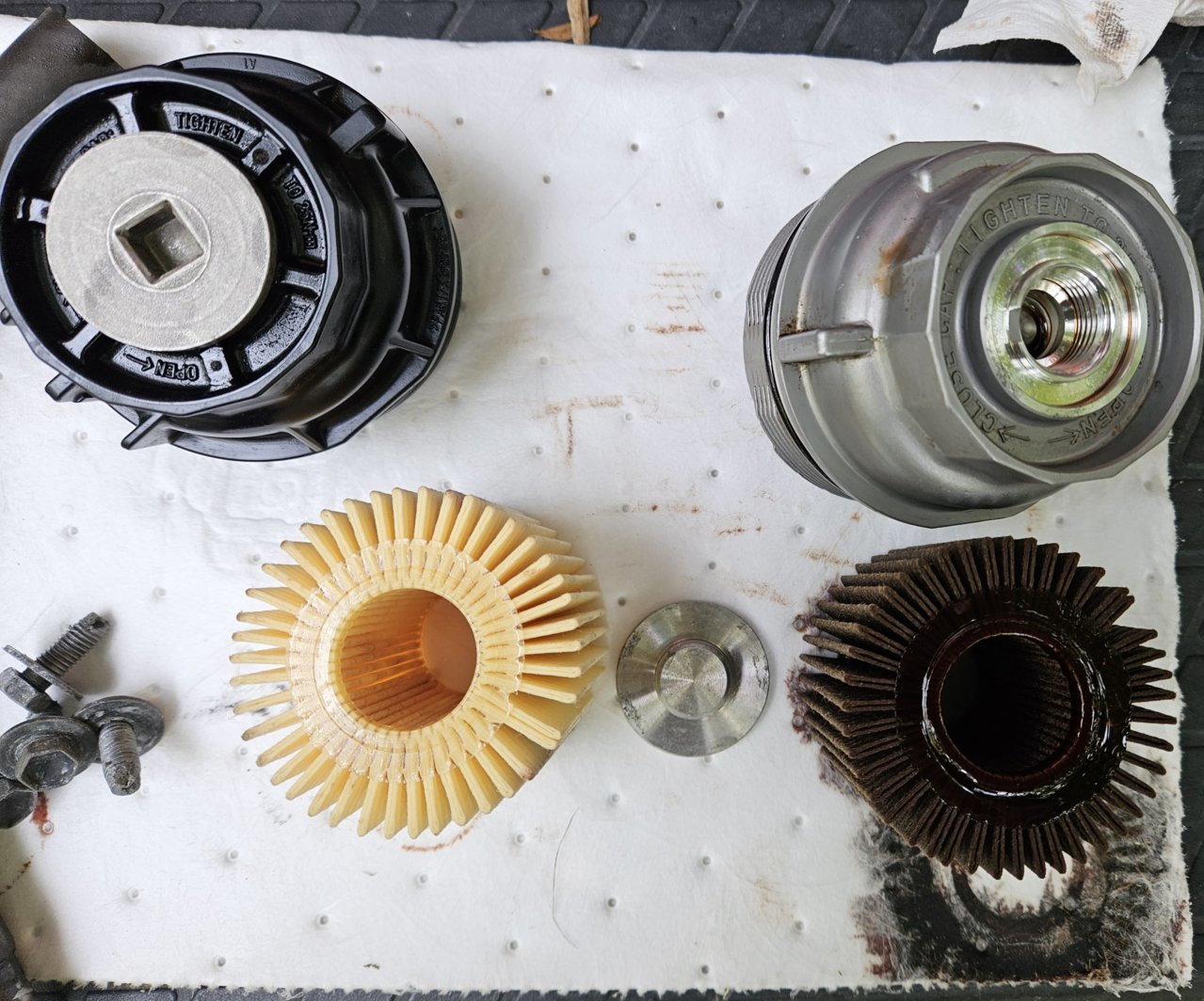

    I got the Alluminum to replace the Composite in my Wife's Rav4 back in 2016. The Rav4, being such a new to me car, had me on the Rav4 Forum.
    Lo and behold one of the first threads I read was about needing to replace the "cheap" plastic with the much better Alluminum.
    After I did my first Oil change on the new Rav4, cursing the whole time because of this new fangled cartridge set up, I realized that the Plastic was just fine. I then just began swapping them out on subsequent oil changes.
    Fast forward to my new Tacoma and there is the same looking plastic canister. Quick search showed the same part number for the Rav4, Tacoma, and a crap load of other Toyotas and Lexus vehicles.
    I now have three canisters in rotation. Two Composite and one Alluminum. Pull one off, replace with the already cleaned and loaded with new rings and filter element one from the previous oil change. When I take one off, I clean it, load it, and then store in a plastic zip lock ready to go. Smear of oil on the O ring and screw it in.
    The torque for both style canisters is 25 N.M. or just over 18 Foot Pounds.
    Long handled 3/8th drive is what I use now. Snug it until it stops, that's all it needs. 18 Ft Lbs is not much. Even with me doing my oil changes, I'm always a little surprised how much torque I need to remove either one of them. It is always more than 18 ft Lbs but I never have had an issue. I guarantee the issues are from over tightening or cross threading.

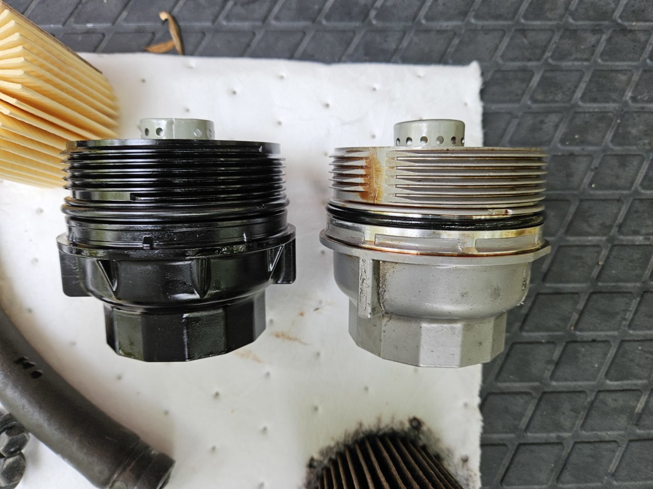

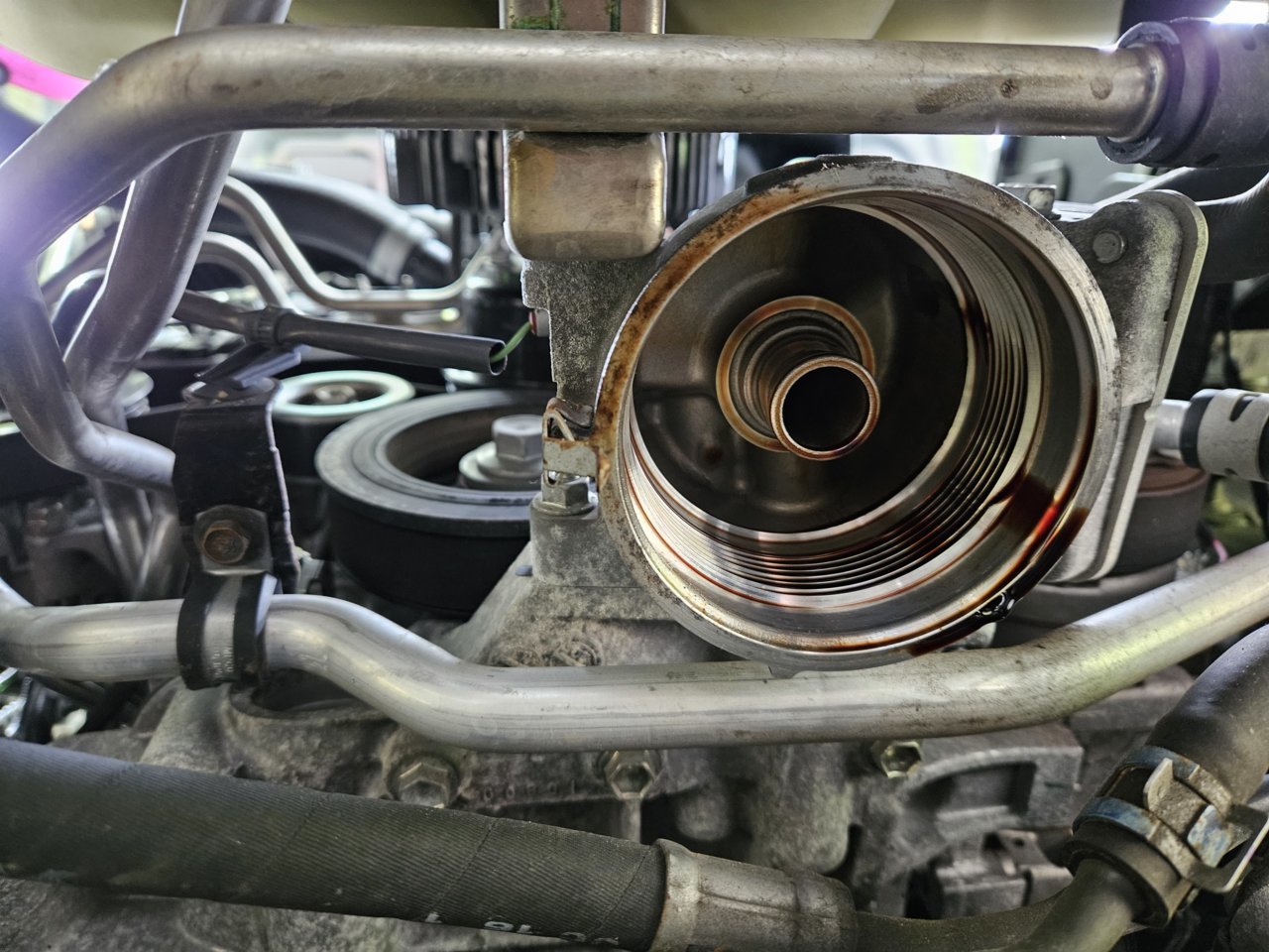

    Two things I have noticed, which are very minor. The plug-in plastic piece used to drain the filter always hangs up on the metal canister. I have to pop it out with pliers. The filter wrench comes off the metal housing easier than it does on the plastic housing. Neither of those two are an issue.
    Looking up, locking clip is visible about 9 o'clock.
    The only difference, besides the obvious construction material, is the Composite has 3 ridges on one side, one on the other where the metal has one on each side. Barely visible on left side of black canister.
    New element, old element with about 6,000 miles on it. A shot of the filter drain plug, you can see on the metal canister where the small "O" Ring goes.
    I usually do around 5,000 between changes. Was on a trip so was closer to 6. Filter is very clean between the pleats. On my first change, about 2500 there were some very fine metal flakes, almost like powder. Have not seen anymore metal in the last 4 changes.
    The four bolts are from the stock skid on my O.R. I always put just a dab of never seize on them before reinstalling.
    P.S. I still cuss this set up..
