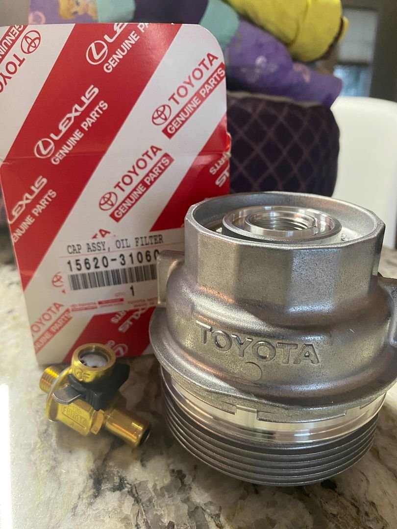

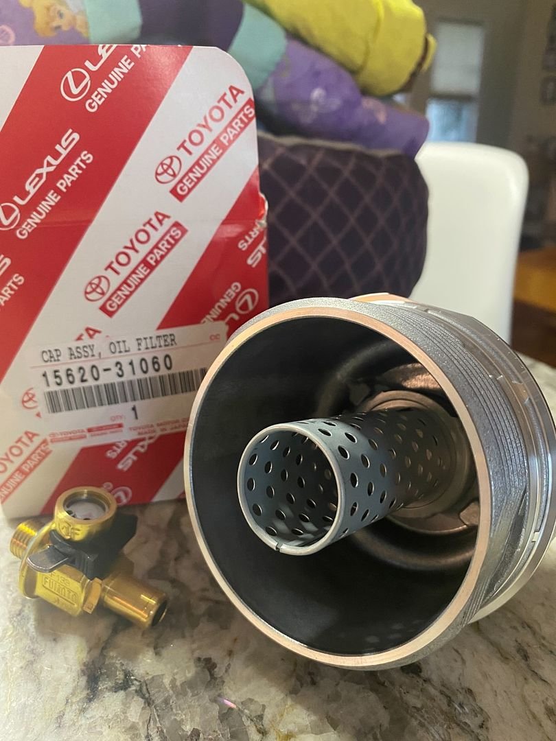

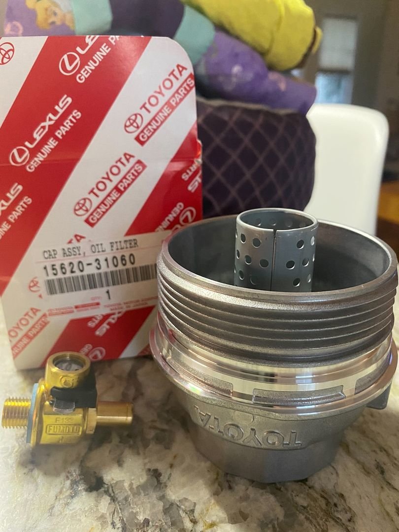

    Here's the one I got from Amazon:

    That’s a good part number……got mine from BAM
