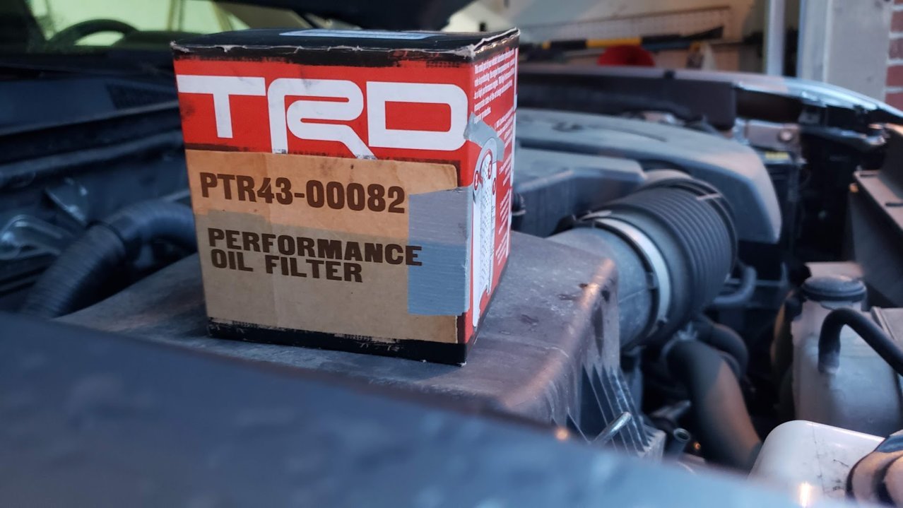

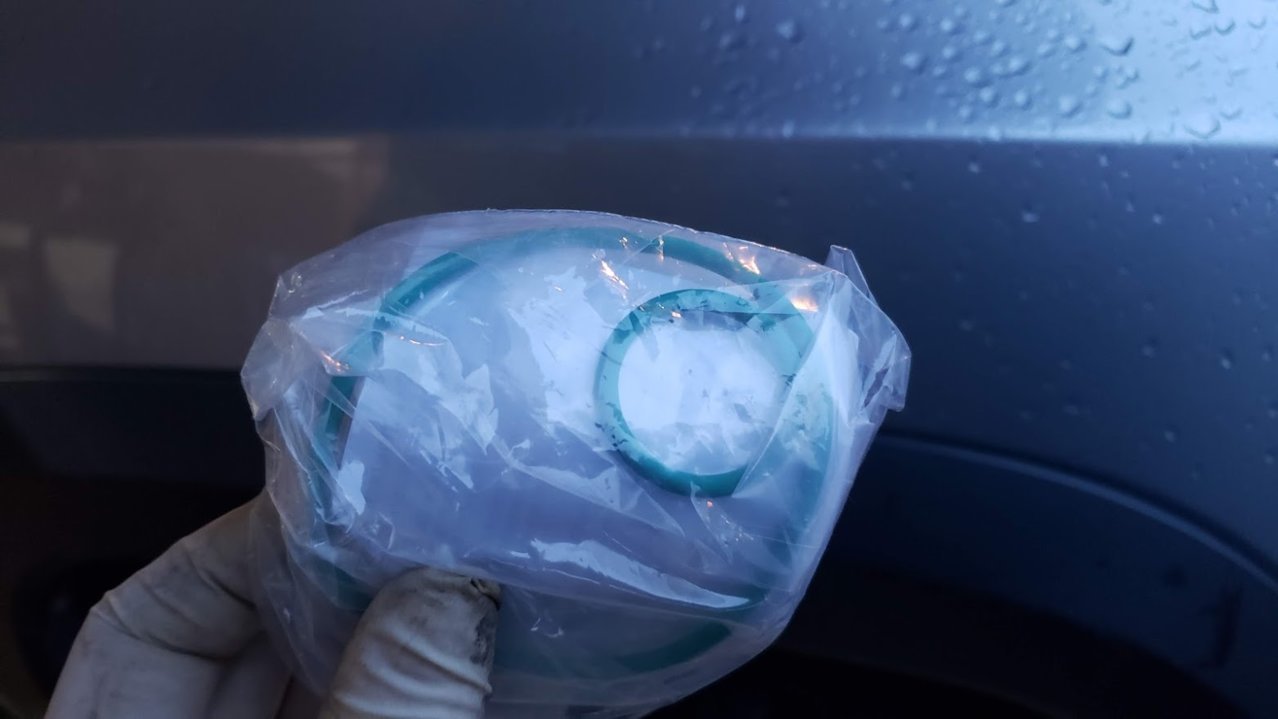

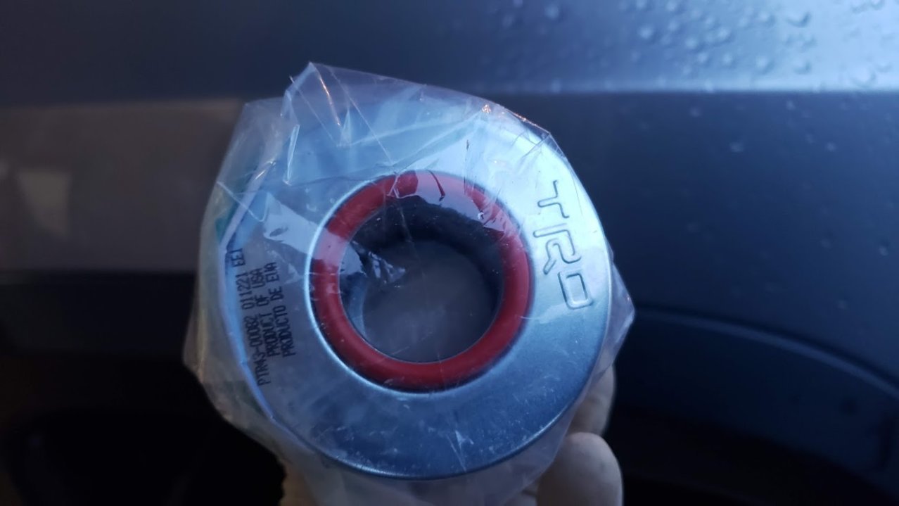

    Is there a specific part # for the filters that come with the screw-in plastic drain piece? I've used the clip-in before and it ended up very messy
  14. May 6, 2021 at 11:49 AM
    #34
    Raijin822
    Raijin822 Well-Known Member
    Nov 2, 2020
    #345651
    298
    Canada
    2021 TRD OR
    I believe if you buy a wix filter, it comes with a screw in one. I use the clip-in one but i put a empty soda bottle over the drain nipple before I shove it into the filter housing. Never had a mess and I reuse the bottle for the next oil change.
    Using the bottle to push in the clip in drain piece makes it easier too.

    I checked and the Fram ones come with one. It can be reused over and over. The one thing I really like about the screw in ones is you can control the flow of oil coming out so its much cleaner. I use the Fram screw in adaptor with the Toyota oil filters. I showed both types in the vid, and I should have shown the push in type first to show the gush of oil you get !!!!
