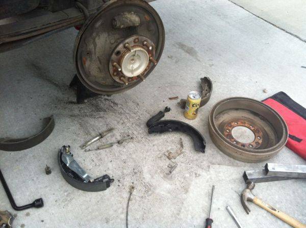

    So, step one is to get the truck up on a jack stand. Put the truck in park and chalk the wheels. I just put it under the axle housing on the side i was working on enough to get the tire off the ground. Once the tire is off you have to take off the drum. You can pound on it with a hammer around the studs and around the top to break it free. you can also pry at in in between the drum and the dust shield with a flat head screw driver.

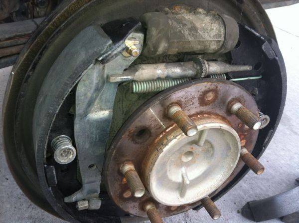

    Once the drum is off you have access to the rear brake assembly. There are a ton of parts, but it's not that hard. The only key thing is to make sure when you take it all off, and remember exactly how it all goes back on. Taking a picture or two will help you for reference.
    Step one is removing the e brake cable. It is actually not in the picture, but its not hard. Just stretch it out and pull it out from the little track its in, then you can remove it from the clip on the left side and it will pop out of the stopper on the right side.

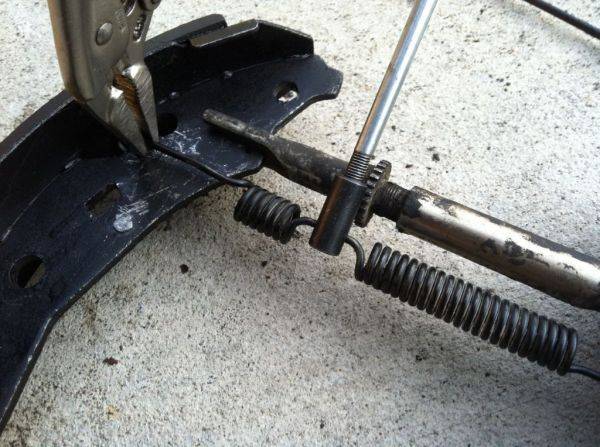

    Step 2 is removing the lower spring. This is where you want some thin needle nose vice grips and the screw driver. You have to just man handle it and pry is out of the holes the springs are stuck in and stretch em out enough to pull them out. Don't be too timid about clamping down on them and prying at them, they are pretty durable springs.
    Step 3 is removing the spring that tightens the adjustment screw lock. Similar to the lower spring, just get the vice grips on it and pry it off.
    Step 4 is removing the pins and springs that go through the center of the shoes and hold them some what in place. This is where the fancy tool for this comes in handy, because it cups the slotted washer and lets you twist it, but im sure vice grips of pliers will work. just don't bend it. You hold the back of the pin (located on the backside of the backing plate) with your finger and twist the washer until the spring pushes it off the pin. then you can take everything out and set it down in the same way it came off. Do both of them.

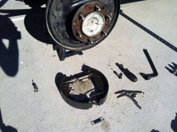

    Now for step 5 you can remove both brake shoes with the main spring and adjuster attached. Just spread the shoes apart and pull the whole thing off and around the end of the hub. Also pull off that metal plate that the spring was attatched to in step 3.
    By this point everything should be off the truck and on the ground.
    Now you get to pry the main spring off. Good luck. This is where a couple of vice grips (or a special tool) come in handy, to really stretch out that spring so you can pry it off.
    Now you have just the shoes with all of the hardware laid out how it should go back on. This would be a good time to clean everything.

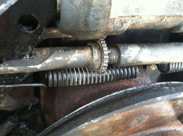

    Now that the new shoes are all ready it is time to put everything back together exactly how you took it off. This is also a good time to adjust that adjustment bolt all the way in to get the drum to fit back on, we will tighten it back up for the right fit once everything is assembled. To tighten it, and move the bolt in it gets turned to the right. To push the adjustment bolt out turn it to the left.
    Putting it all back on is the reverse of taking it off. Place the adjustment bolt back in it's slot.
    Stretch out the main spring and place it back in it's correct spot. Make sure it is on the right way as well before you put everything back together. This is not fun to have to take all apart an extra time.
