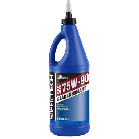

  16. Aug 23, 2018 at 8:49 PM
    #16
    Lester Lugnut
    Lester Lugnut Well-Known Member
    Mar 3, 2010
    #32477
    2,822
    N of Mex-S of Canada-E of LA-W of NC
    '15 Tacoma PreRunner V6 SR5 Auto
    Save your money.
    taco2010trd likes this.
