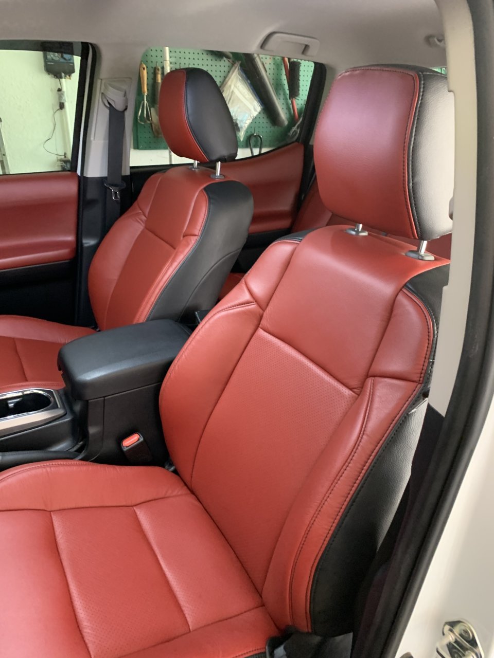

    I masked off around the door panels and used 2 products by SEM. First, a Vinyl & Plastic Prep Spray followed by their spray paint (believe its name Color Fast…something like that). Have had no deterioration of the color at all in 2 years.
    The panel above the glove box is easily removable so you can do it without masking it off. It pops out a bit and there are 2 small screws to remove- one on left side the other at bottom right.
    another option would be to order Katzkin leather in a matching red to your door panels and change to leather seats.
    That’s what I did. Changed my door panel color from gray to Katzkin Cardinal Red.
