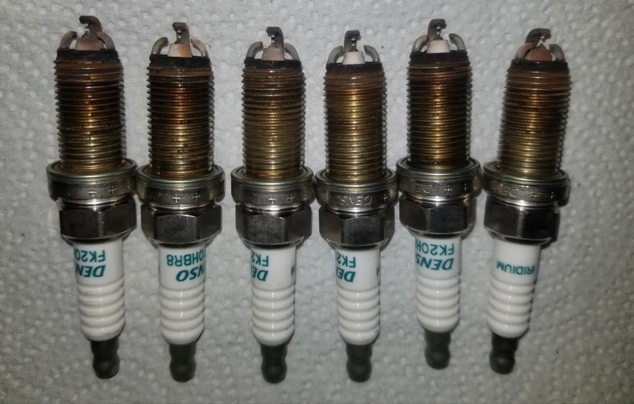

    Anyone take any pictures of the old plugs? Be interested to see what they looked like.

    Search out the loose plug threads. There have been a few with lots of plug pics.
    For the ones that weren't loose, I didn't see any surprises. Some folks had seen issues looking closely.

    That was about the look of mine at 60k also. DIY job for sure!
