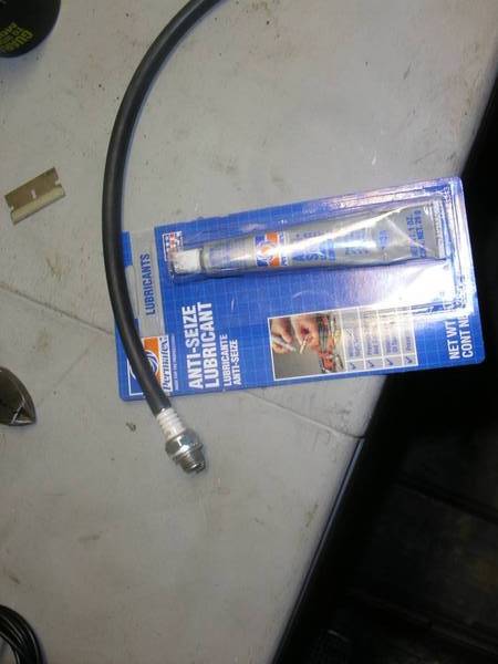

    Is the 1st gen the same as the second? I just used a spark plug socket to remove the plug once the coil pack was removed, gap the new plugs, use anti-seize on the new plug, and be extra careful not to crossthread the new plug(steel plug aluminum head), I do this by using some old vacuume tube pushed over the new plugs top and let the rubber tube be your extension, if it wants to cross thread the rubber tube will fold before it cross threads, once you have a coulpe of turns, pull up on the tube put the spark plug socket down the hole and torque it to the specs. Reinstall coil pack repeat five more times, sit back have a cold one and think of the money you just saved yourself.

    here is what you need, minus the "tools" NOTE The plug seen here is used as a visual aid only, it's actually for a lawn mower, please don't use lawn mower plugs in a Tacoma. Allthough.....?

    Ohhhhhhhhh Thank you Chris for that pic. The pic helped alot
