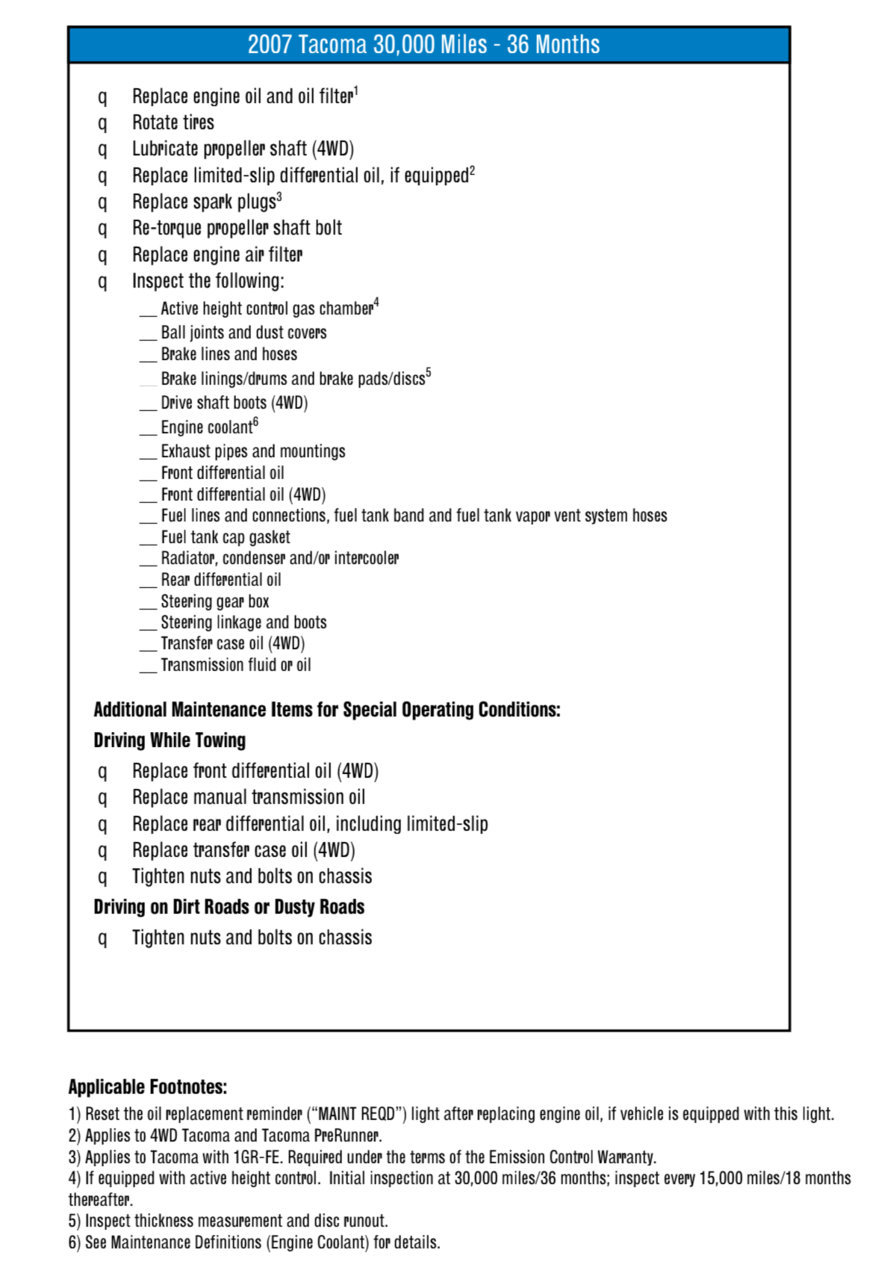

    Good condensed information on that chart.
    The chart says to replace(?) the plugs at 30k. Am I reading that right?
    10thMTNgrunt[QUOTED] likes this.

    Yes 30k for 4.0L v6 trucks, many people go longer but that is the recommended interval as they are copper plugs.

    Yes, But……..see #3 at the bottom of the list.
    There’s a reason it’s “so soon”. Some of it has to do with emissions warranty.
    And cats aren’t cheap. Emissions work is expensive……who’s paying for it?
    You are if you don’t do plugs at 30k:thumbsup:
    At least that’s what “I” think has to do with the mileage interval.
    Anyways, just do them. Play it safe.
