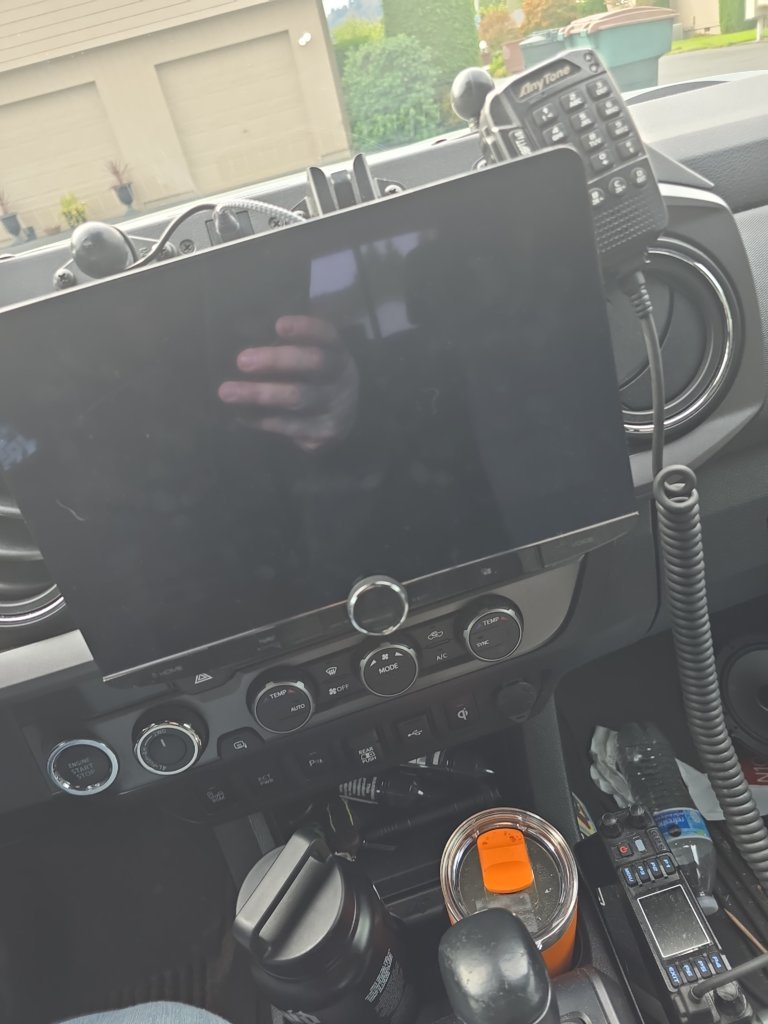

    I'm not sure if anyone here has experience with this, but I'm trying to change the splash screen on my Kenwood DNR1057XR. I've tried resizing the image, changing it to 16 bit bmp file I even tried changing the txt command to version 9999. All I keep getting is a red screen and no update. Picture of my HU turned off after install so people can see what HU I am referencing.
    I saw on Tundra World people were able to change it, I asked some questions on there but it is an old thread so I doubt I can get any help there. Thanks in advance everyone. 76b542a5-72b0-4b29-aeb1-7a6eaca3f593.jpg

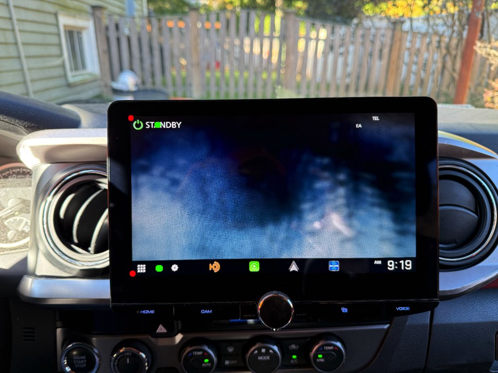

    So where exactly do you need to tap the screen for the 10 series? I keep hitting the menu button and it doesn't work.

    For the secret menu? It's the top left corner of the normal screen (on standby) X2 bottom left x2 top left x1 and bottom left x1

    Ah! I was tapping directly in the corners (red button) and it didnt' work. I often hit the squares menu. I moved in about a half an inch, the green dots and it worked great.
    What does annoy me is that I can't get the files to take yet. I think it's the drive I've picked. When running the updates I know that it was VERY finicky about which USB drive you used.
