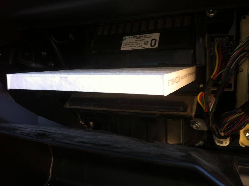

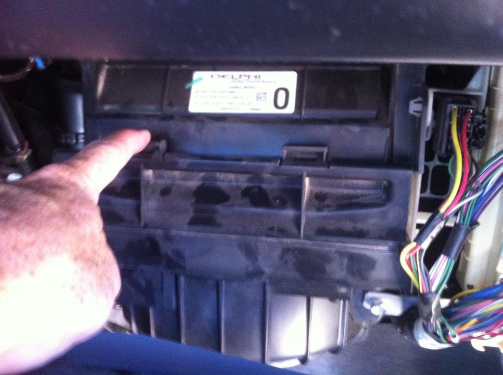

    So the cabin filter is located just behind the glove box.

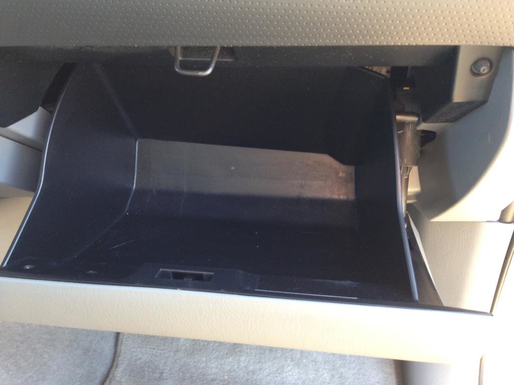

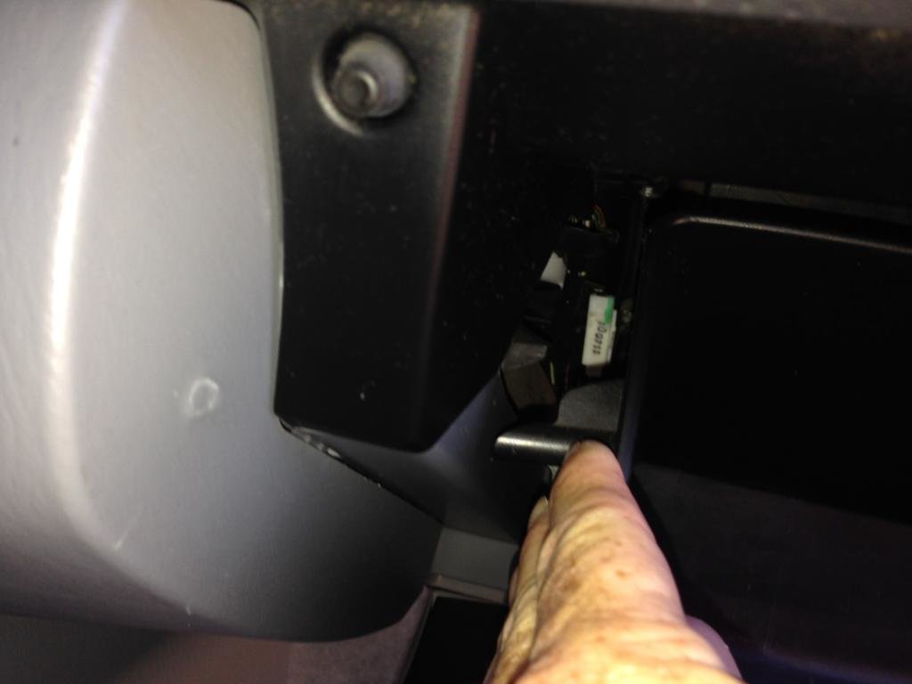

    Press the tabs inward and the glove box will lower about an inch.

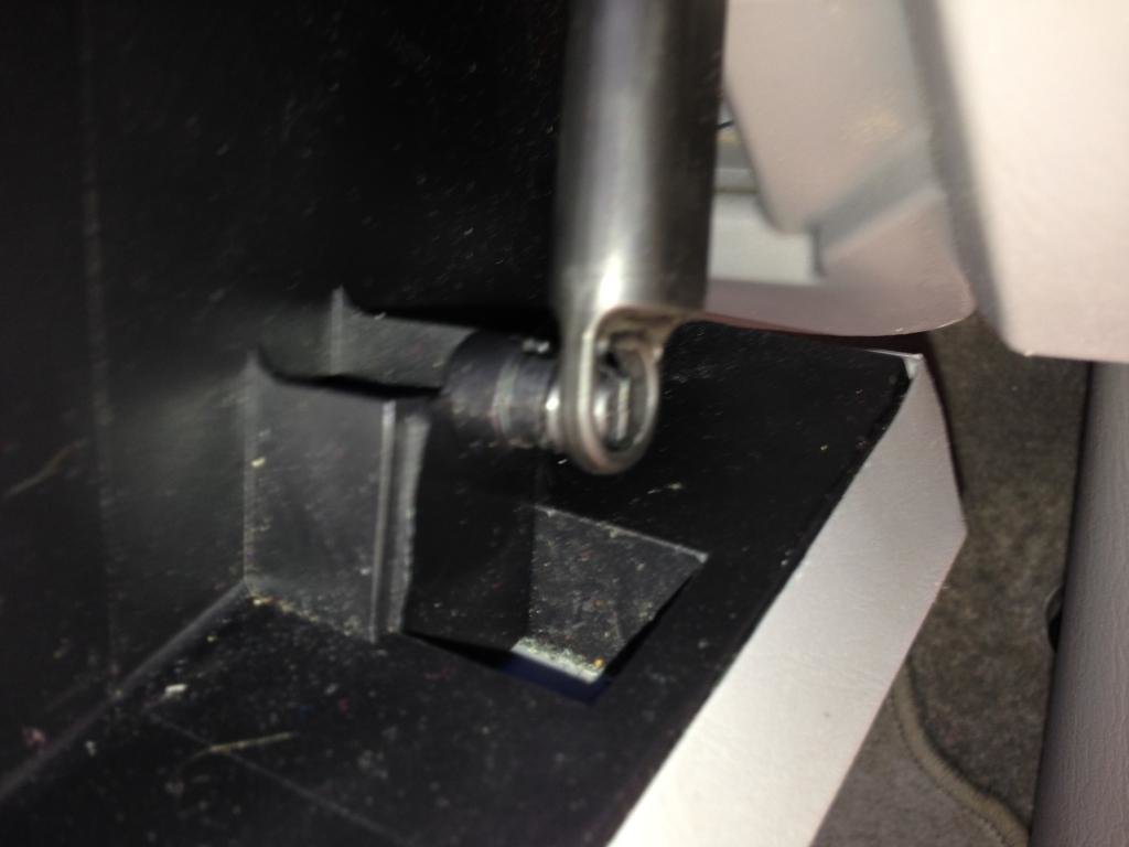

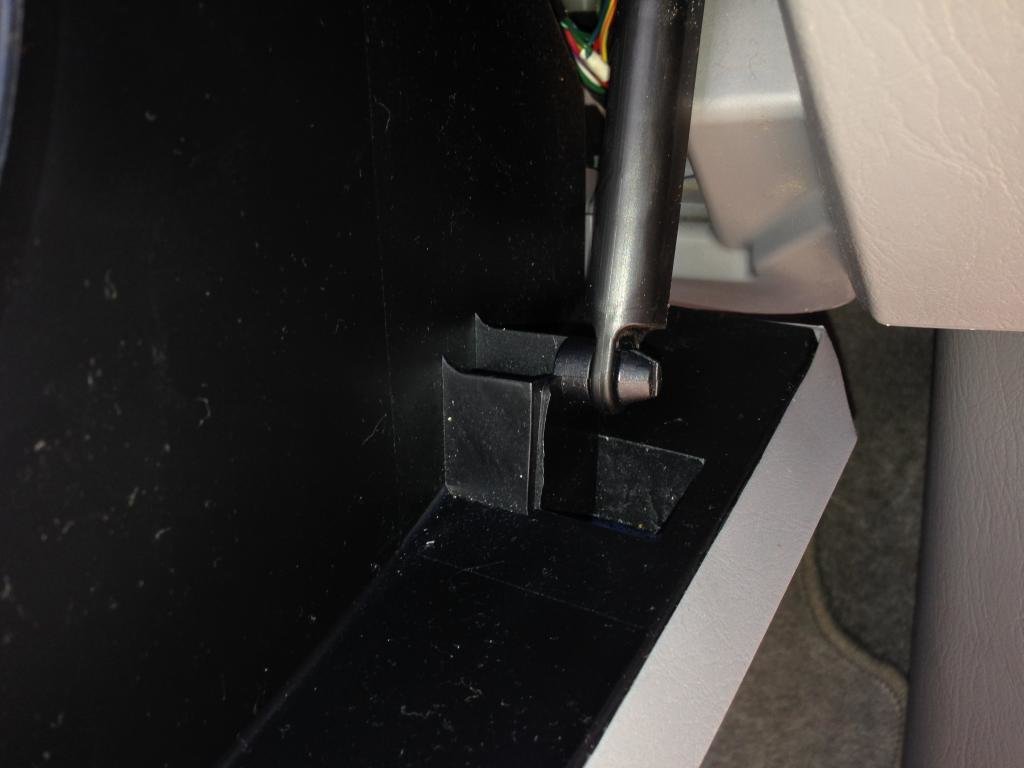

    Next disconnect the glove box "shock absorber" by pressing the tab and removing.
    That will drop the glove box completely to reveal the filter housing.
    Next push down on the 2 tabs and the filter will be there.

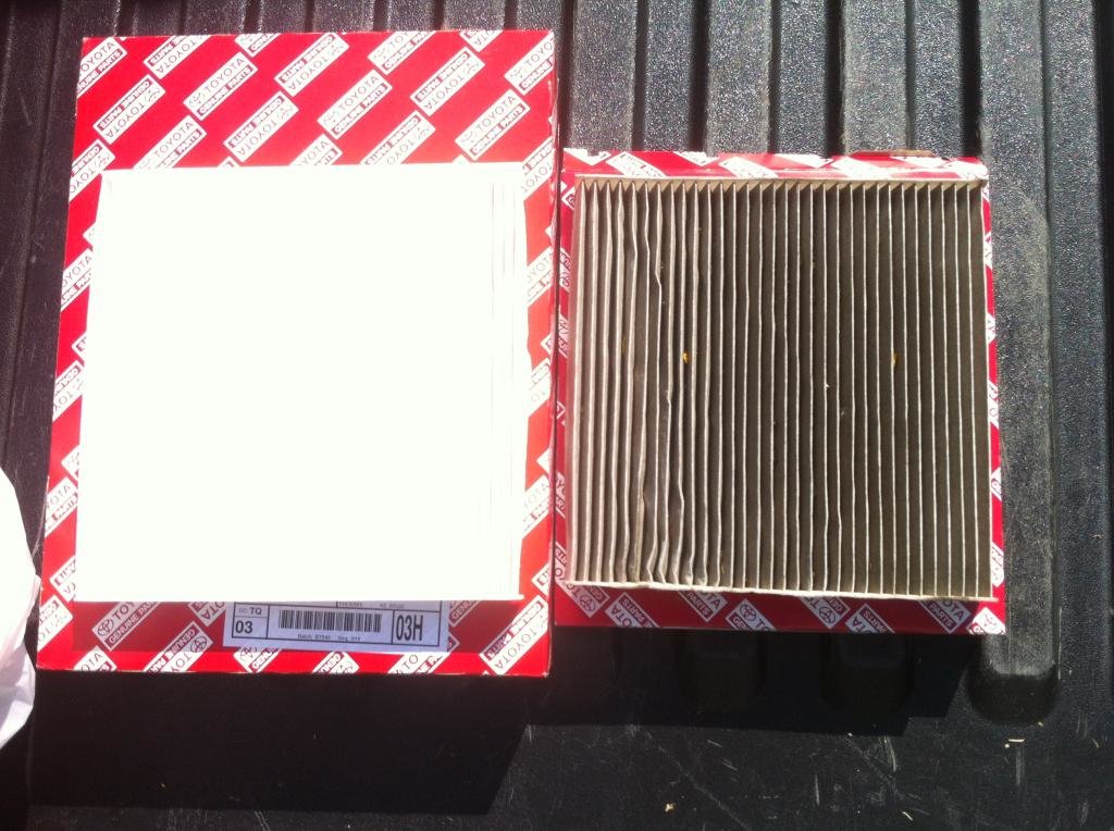

    Hmmm. I'm pretty sure it was time for a new one,

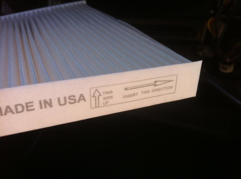

    Next put the new filter in as directed.
    Then reverse the steps to close it all up.

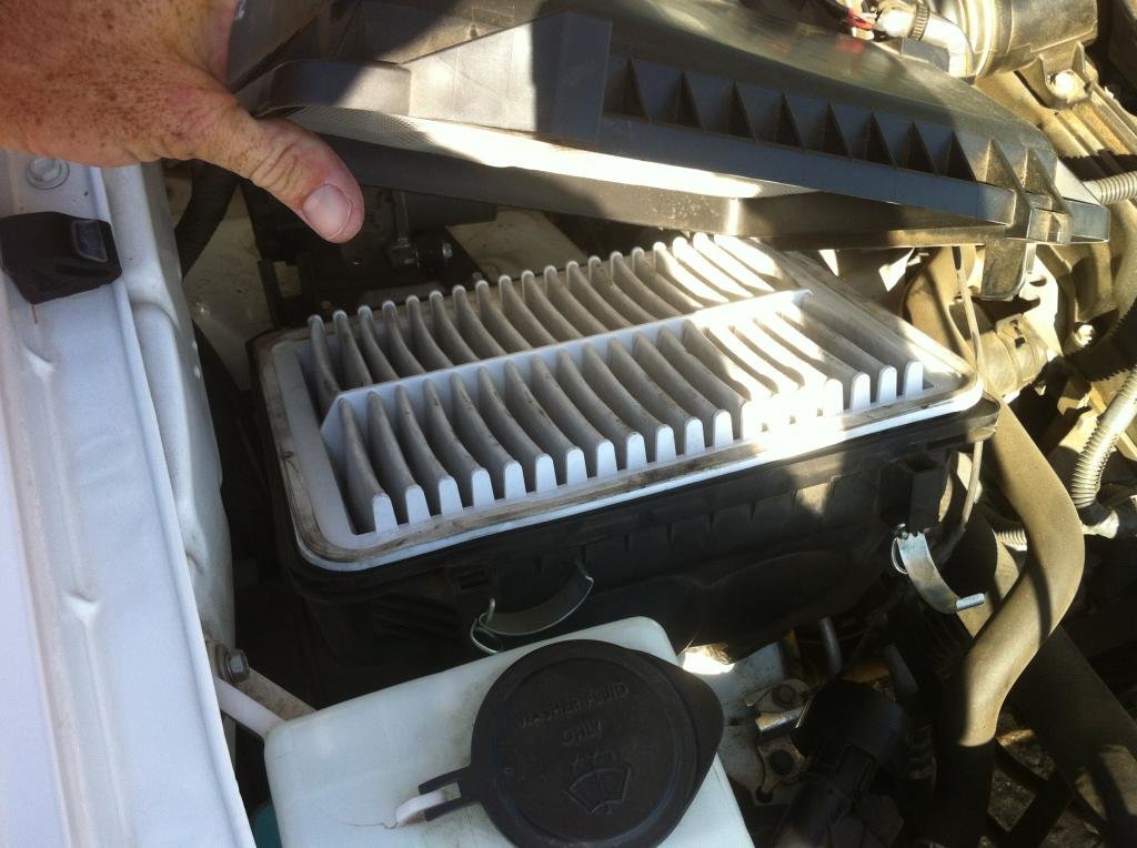

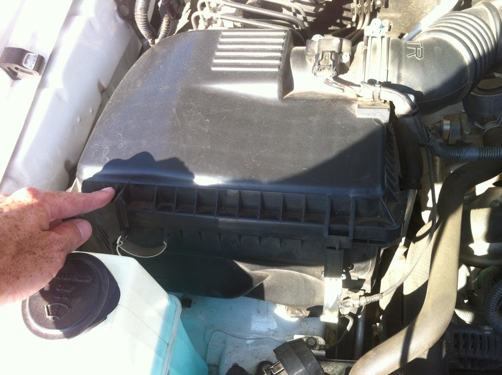

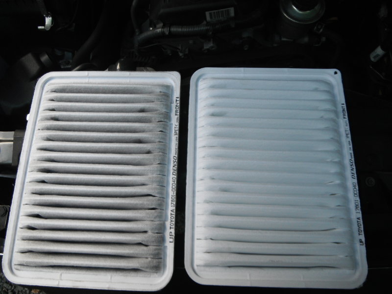

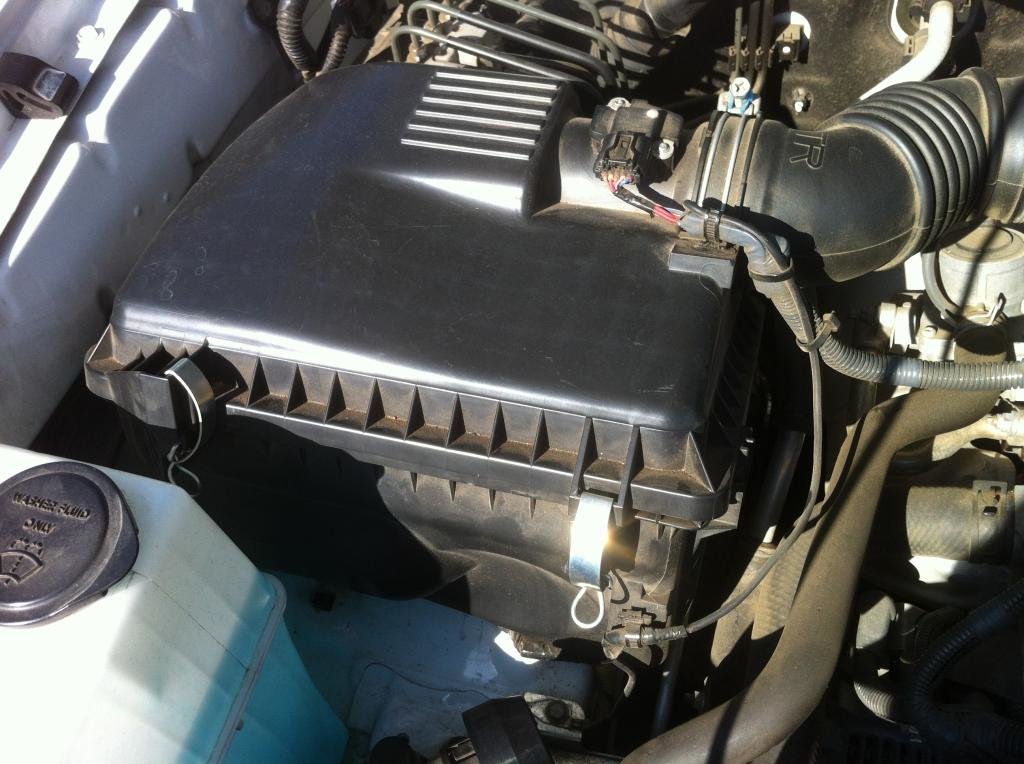

    Now for the engine air filter.

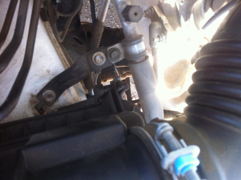

    Open up the 2 metal tabs
    The tabs in the back can take a little "shimmying" to open the cover all the way

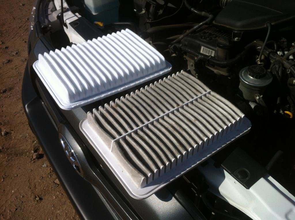

    Yep I must live in the desert!
    Lastly closing this all up. The tabs in the back need to seat just right to close all the way.
