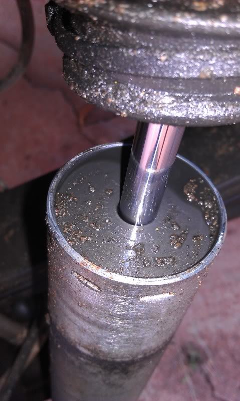

    Here is a pic of my busted 5100 in the rear. My truck is sitting on jack stands with the rear tires off the ground. Notice how it's maxed out completely.
    Remember, there are two different model 5100 rear shocks. The one pictured above is the short one that came with my front ones when I ordered them as a package a while back.

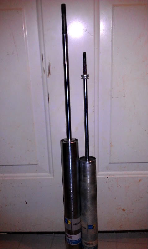

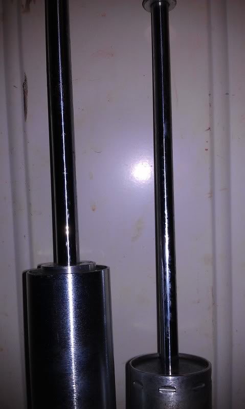

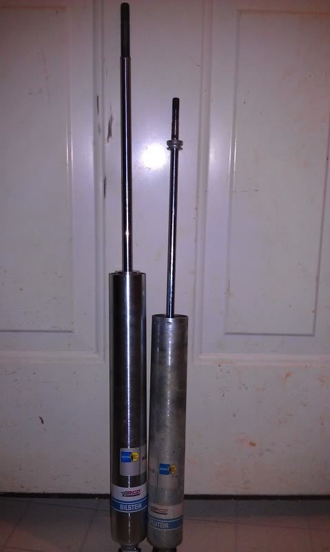

    gotcha. Also, I just received the longer 5100's today. The stem is larger than my old ones. Shock looks like a totally different shock lol. Here's a comparison. I took the rubber boot thing off so you could see the zise difference :eek:
    DSM fixed me up! They forgot to put in one bag of hardware, but they're overnighting it. Should be here tomorrow! DSM is #1
