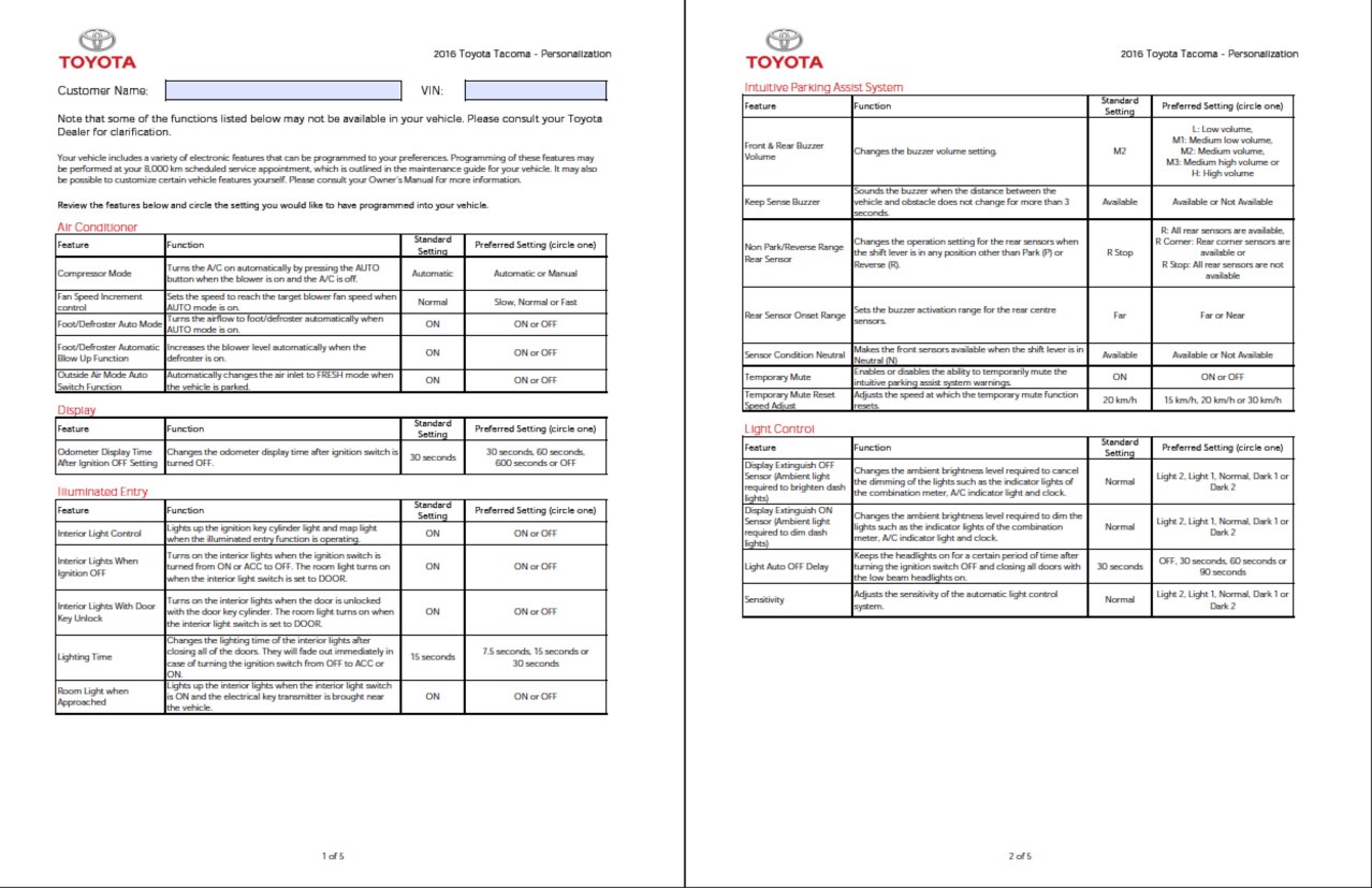

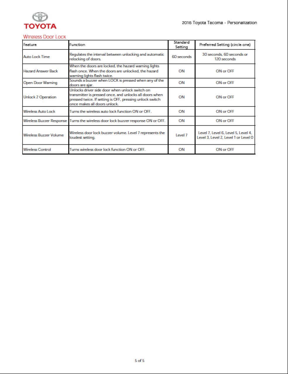

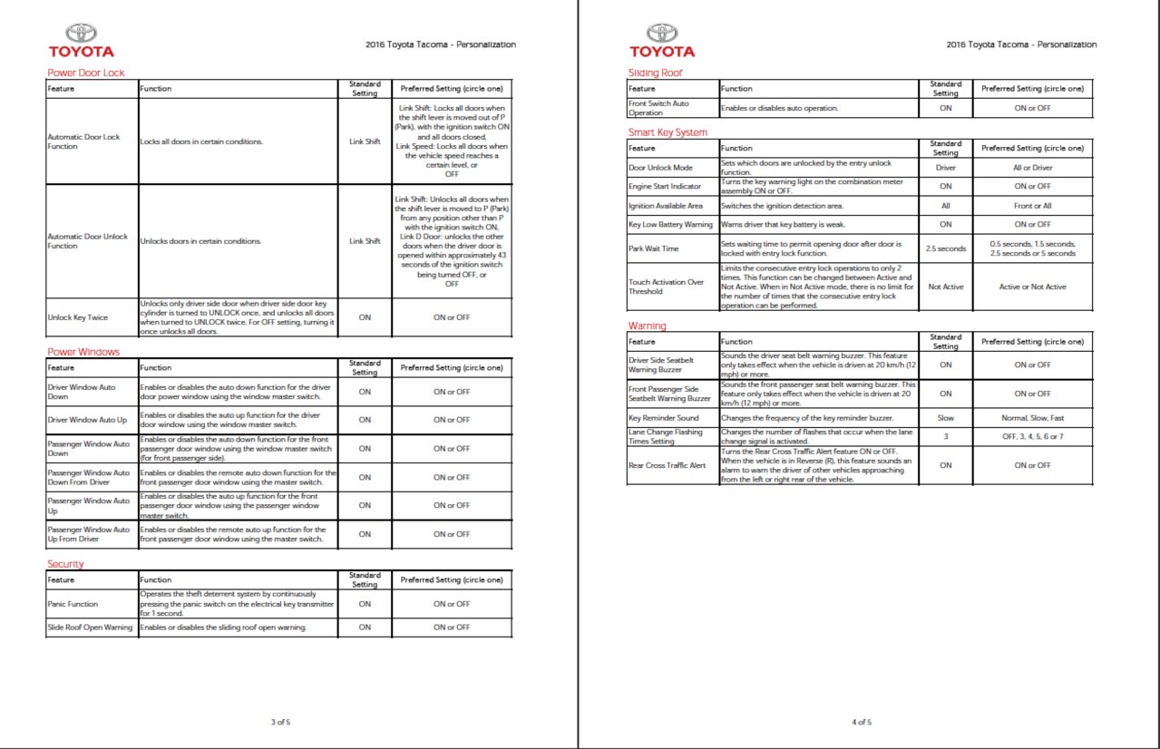

    Here's a list of things the dealer can customize.

    Can’t open it for some reason. Can you please post a screenshot?

    Here you go.
    Screen Shot 2018-04-28 at 12.04.00 PM.jpg Screen Shot 2018-04-28 at 12.04.20 PM.jpg Screen Shot 2018-04-28 at 12.04.32 PM.jpg

    Is this still current on newer tacomas? Wanting to change my 2020 taco blink times.

    Whenever you make a trip to the Dealer they will change it, had them change mine to 5 blinks which is about perfect.

    Had dealer do mine and had to tell tech guy it is in tech stream. He had never heard of this. I did 7 blinks. I wish I would have known about the door buzzer volume. That has to go down.

    Was at dealership this morning. The were able to change my lane change blinks, were able to take the Buzzer sound a notch but they didn't turn off the seat belt Buzzer due to manager saying "unable to turn off safety features."
    Anyone try to have them turn off seat belt Buzzer?
