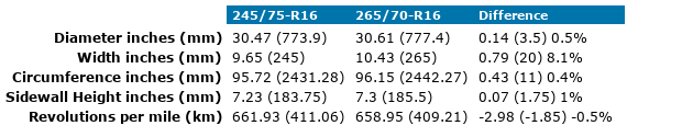

    My question is, is Changing tire sizes on base 2012 Tacoma 4x4 from the factory base size 245/75/16 to 265/70/R16 ok to do?? Seeing as the size i want to change to, the 265/70's is a factory size (offered on the TRD off road package) would this change cause any problems?? I was told it could possibly alter the speedometer readings and the way the transmission shifts, if it was an automatic, but I shouldn't have any transmission issues because I have a manual trans, are these statements correct?? Because I really like the look of the 265's.. And if anyone is interested, I'd like to sell the set of 245/75/16's BFG all-terrain T/A ko's I have on there now, they are brand new, only have about 700 miles on them, asking $180 per tire, bought them new for $216 per tire, please let me know, thank you!

    245/75R16 and 265/70R16 are the same diameter. It's all good. By all means swap 'em!

    well i do not want to oversize, but excuse my ignorance here but they really do have the same rolling diameter?? but, how is that so? because im under the impression that, the first number, the 265 is wider than the 245, and (this is where the difference is mde in my head) that the 75 side wall is bigger than the 70 sidewall?? so isnt the rolling diameter smaller on the 265/70/r16's?? just curious because i wanna be 100% sure b4 i go through with this, thanks for all the input! and yes.. i should have done this 725 miles ago lol :p and the only reason i kept the stock size was because i thought i was doing the wise and correct thing by keeping the OEM size, because it says in the drivers door jam that the replacement tires should be the same size as the original equipment tires. so idk.. tires sizes get confusing, my head is going 1000mph lol

    wow thank you for showing me that link on bfg's website, that really cleared things up.. yeah. in all reality we are talking about tenths of an inch, literally then lol. but it really helped alot.. i still dont understand why the two look so different on the truck tho, it must just be me lol.. so i guess its not really worth changing tires then hm?

    They look different because the 265 are wider than the 245.
