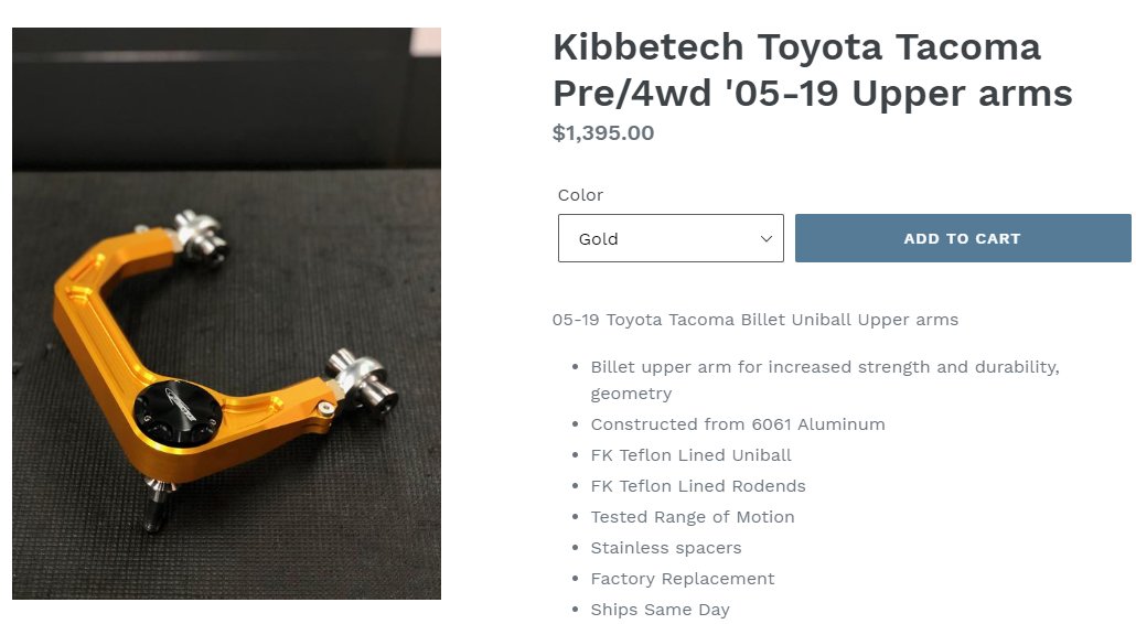

    What a bargain!!!
    Is that $1,395 per side?

    Im pretty sure it is per pair. Kibbetech does a lot of builds for desert racing, but not sure how much you can dramatically change an a arm on an oem setuo

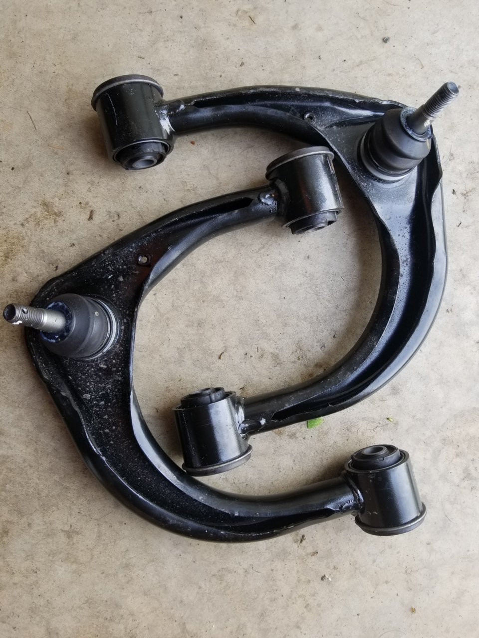

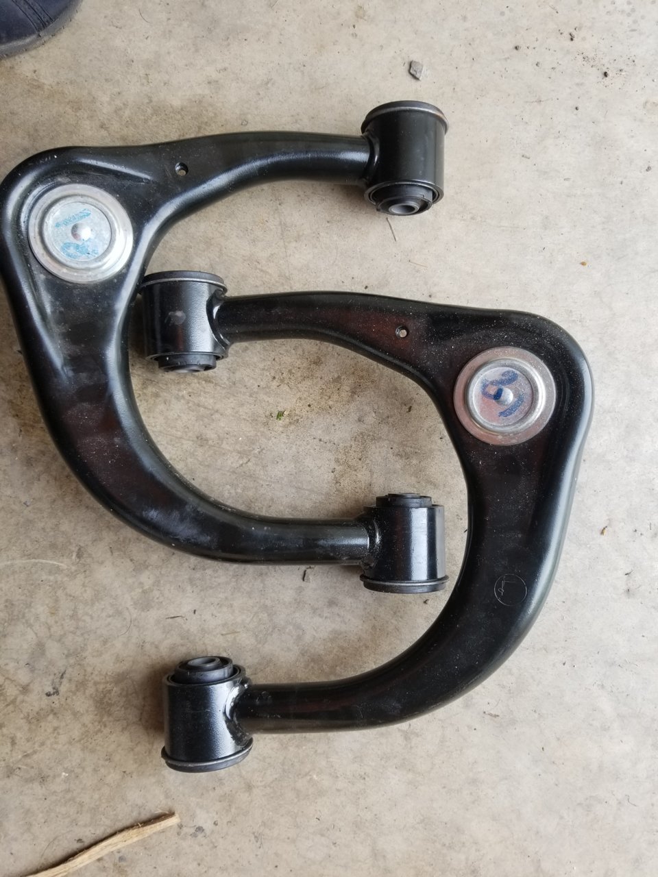

    Let me look when I get home and make sure I didn't tear the boots on them, but I've got a set of 3rd gen arms with 200 miles on them.

    You pay shipping. I probably can't get them in the mail this weekend but maybe Tuesday I can run down.
