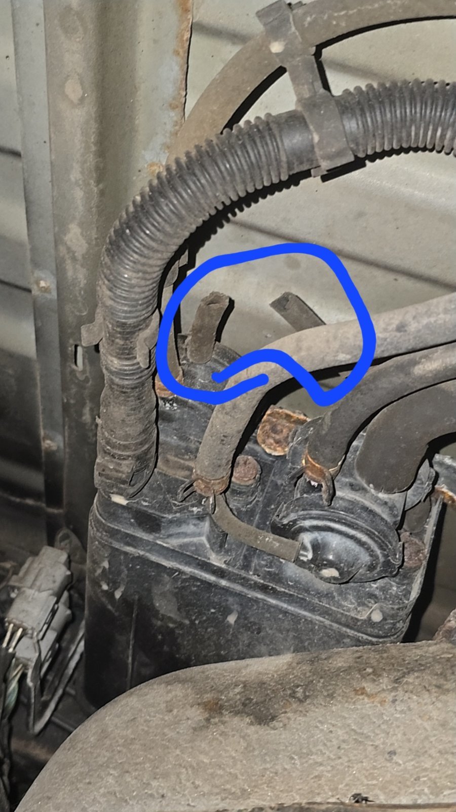

    So, engine light came on.
    got codes p0441 and p0442
    I changed the fuel cap before checking down there.
    engine light came on again and it was the same codes.

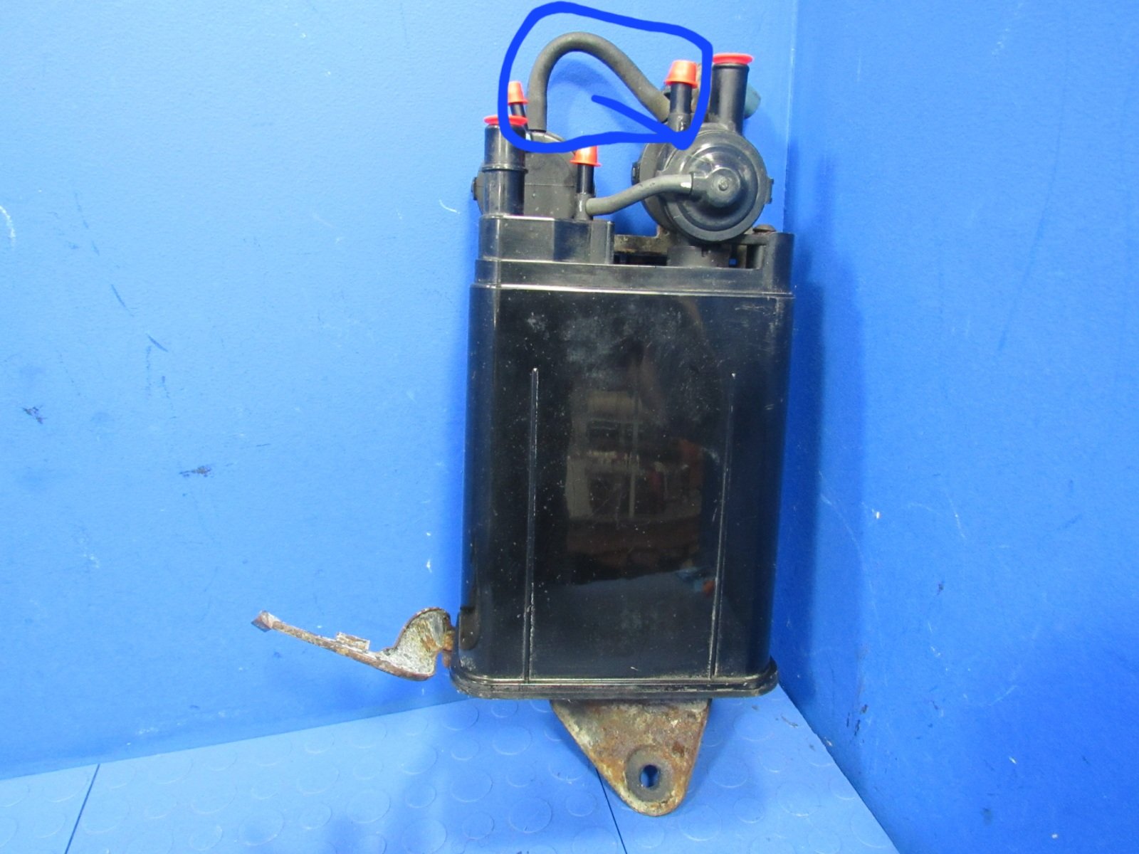

    I checked down there today and I saw that hose is completely cut, if I get just the hose, will that solve the problem?
    and if it does, any idea where to get it from?

    Pull it off and go to an auto parts store and ask for fuel hose in same or similar size. Replace it and get them to clear the code for you.
