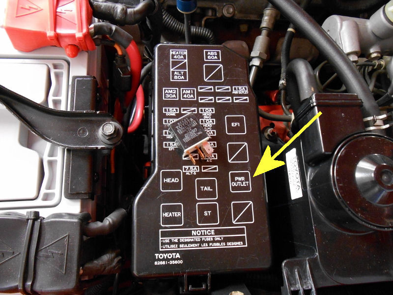

    The problem was inertia of the air in the line. It could cause a check valve in the canister to flutter or chatter. The "fix" was to add a little box between the line and the canister to smooth the air flow. Later models got it from the factory and are silent.
    In the pic below (a 99) see the "box" at the tail end of the yellow arrow, not the point.
