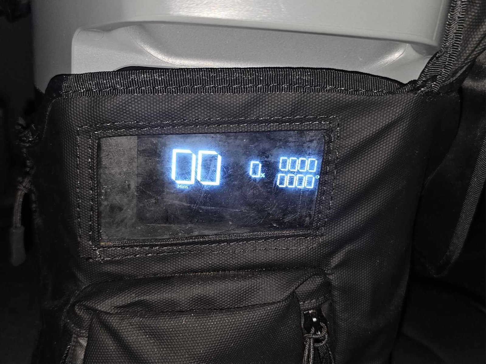

    If your use case is to charge your Ecoflow batteries (ex Delta 2) on your brand new TRD OR incab or bed 120 outlets. Well, look for a different option as this suffers from the same issue as previous gen Tacomas. The output of the tacoma inverter is not clean enough to be used with this type of electronics.
    I will be installing this around the holidays...
    https://us.ecoflow.com/products/800w-alternator-charger
