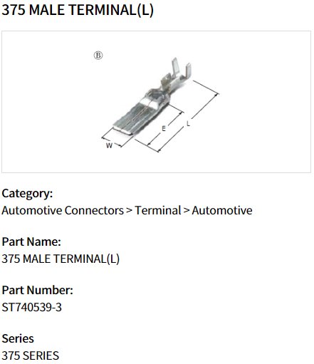

    Bmotorsports Part # CONN-101492

    The Q5 (V9) could be de-pinned and wires with terminals inserted into another connector with mating side to new inverter.
