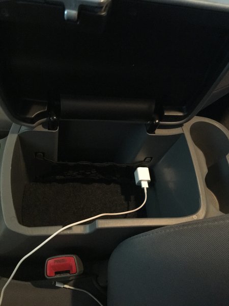

    You can't squeeze a flat head extension cord in there?
    I initially hardwired a Bestek 400-watt inverter to my battery, then installed a 2nd battery and have it connected to that with an 80-watt solenoid relay. What I like about this inverter is it has 4 USB ports that have power without having to turn on the inverter.
  7. May 28, 2017 at 11:06 PM

  8. May 28, 2017 at 11:10 PM
    Chuy
    Chuy Well-Known Member
    Aug 4, 2008
    #8328
    4,004
    Lakeside, CA
    07 V6 DCLB 4X4 Sport
    Silver Taco
    It is out of place. But, it's functional and doesn't get in the way. Opening the rear seat was my biggest concern, but it just clears it.

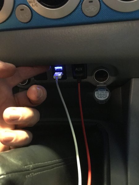

  10. May 29, 2017 at 4:13 AM
    09BlueBeast
    09BlueBeast Well-Known Member
    Oct 28, 2014
    #141258
    987
    Cody
    Denver
    09 Speedway Blue TRD Sport 4x4
    That's what I did... 2 usbs in the dash and a plug in the console
  11. May 29, 2017 at 6:45 AM

  12. May 29, 2017 at 6:48 AM
    09BlueBeast
    Oct 28, 2014
    #141258
    987
    Cody
    Denver
    Honestly can't remember but they're all over the place
