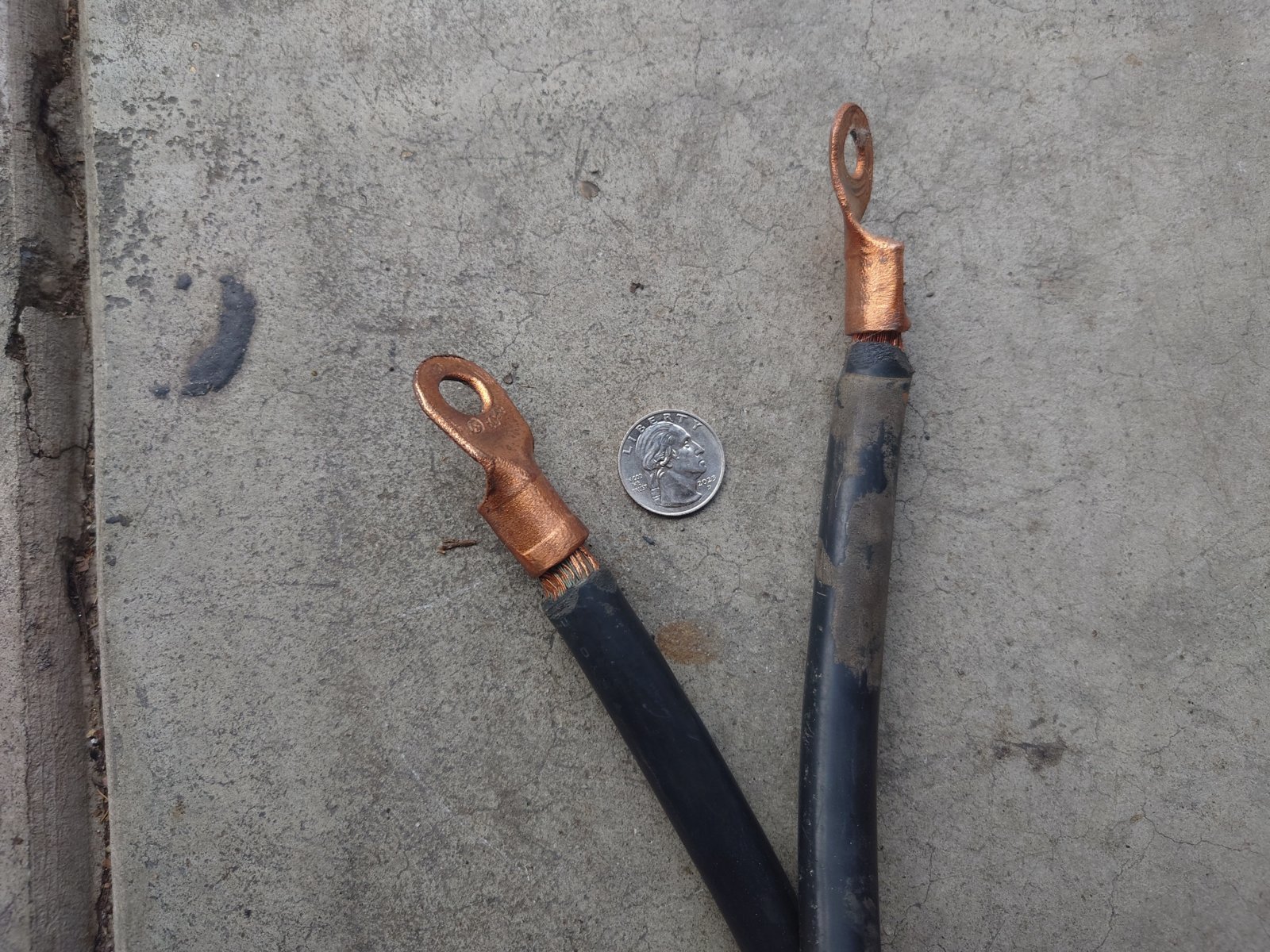

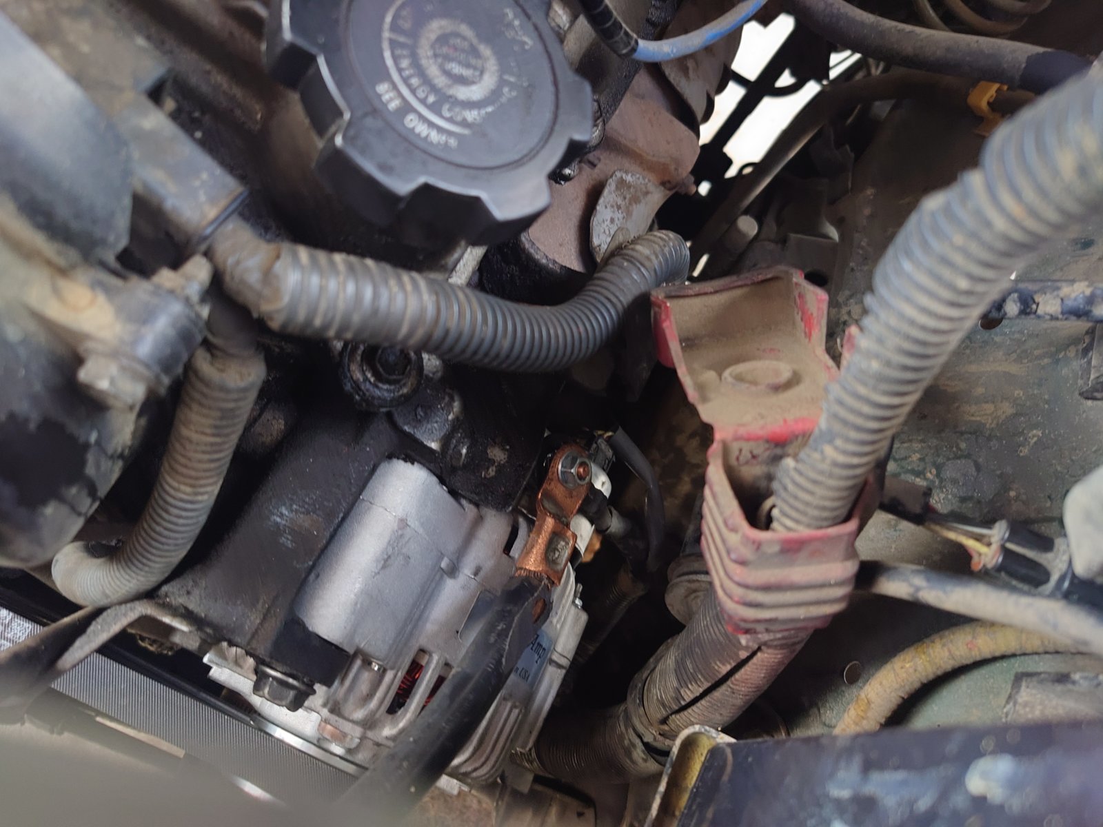

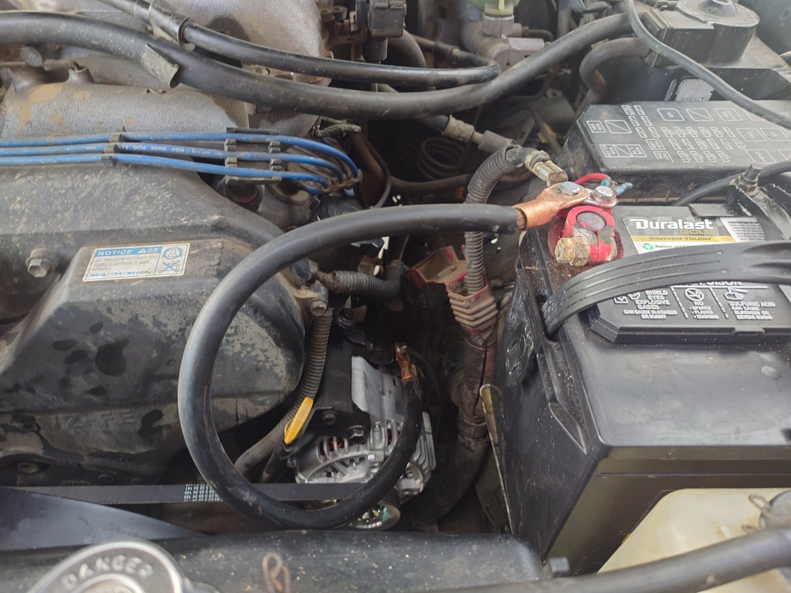

    Update: I remembered that I had some thick wiring laying around that I had taken home from work, hooked it up from the positive lead on the alternator to the positive lead on the battery and took it back to autozone and had them test it. The test came back that the charging system was good so that must have been the issue. Now I just need to figure out the gauge of the wires I have so I can install the necessary hardware. I think they're 1GA but they may be bigger, I'll attach photos below.

    Hmm
    Unk if that scavenged wire was like that b4 u mounted…….
    that ‘flat’ melted section
    That is good place for current to escape

    Yeah it was more of a test to see if that would work for me, I ended up replacing it with some 4ga wire and it stopped working again so I went back to that wire and put some heat shrink around that part but it is still no longer working so I'm back at square one now.
