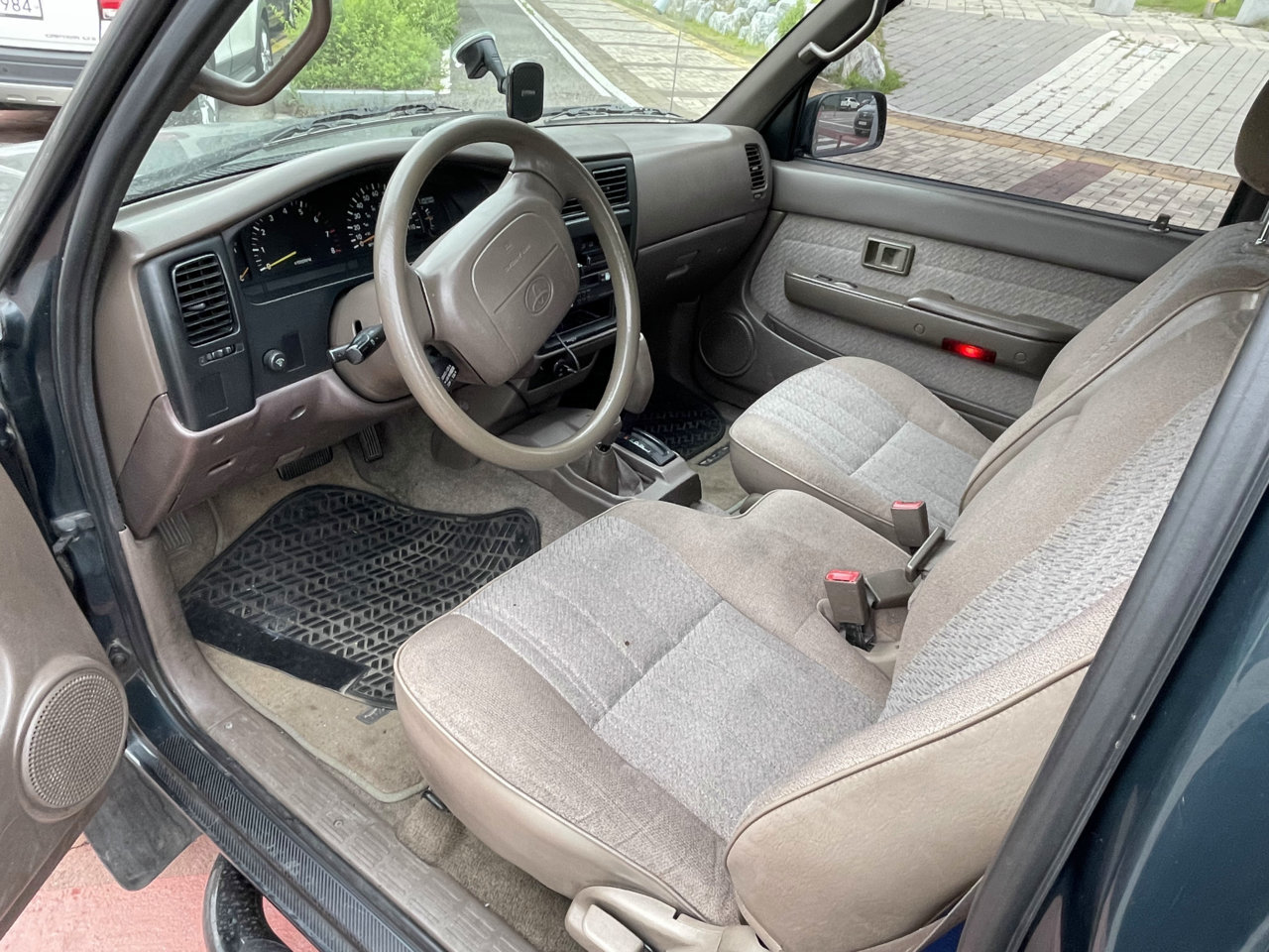

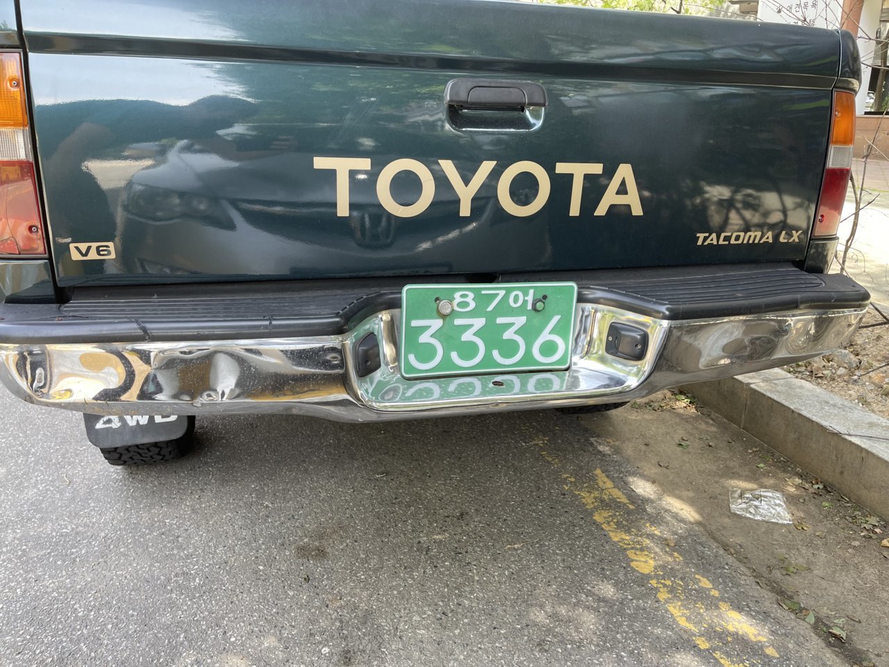

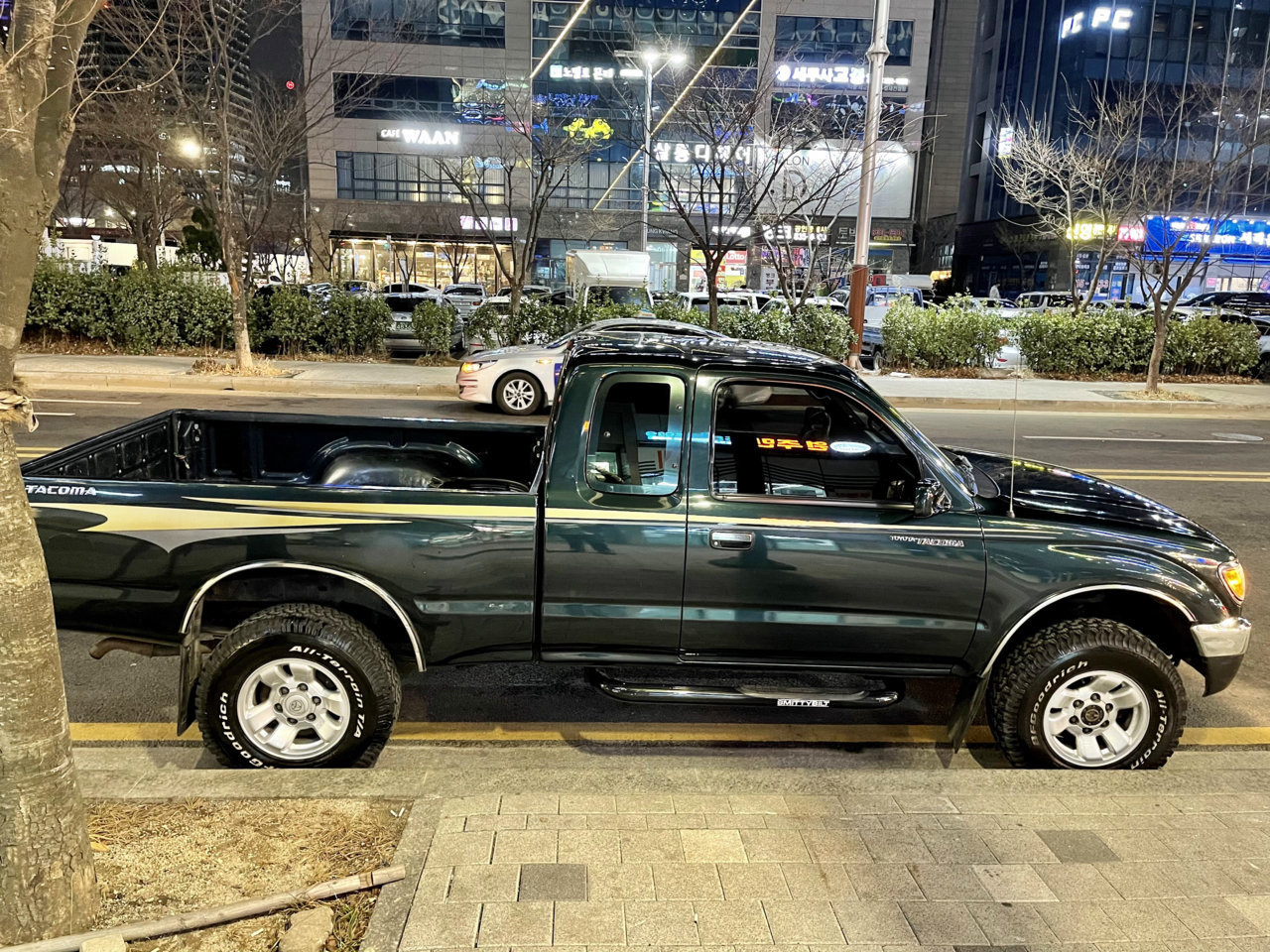

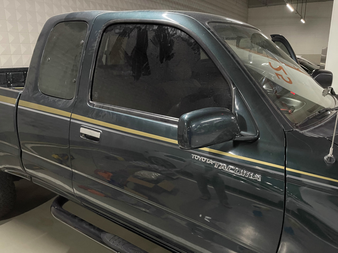

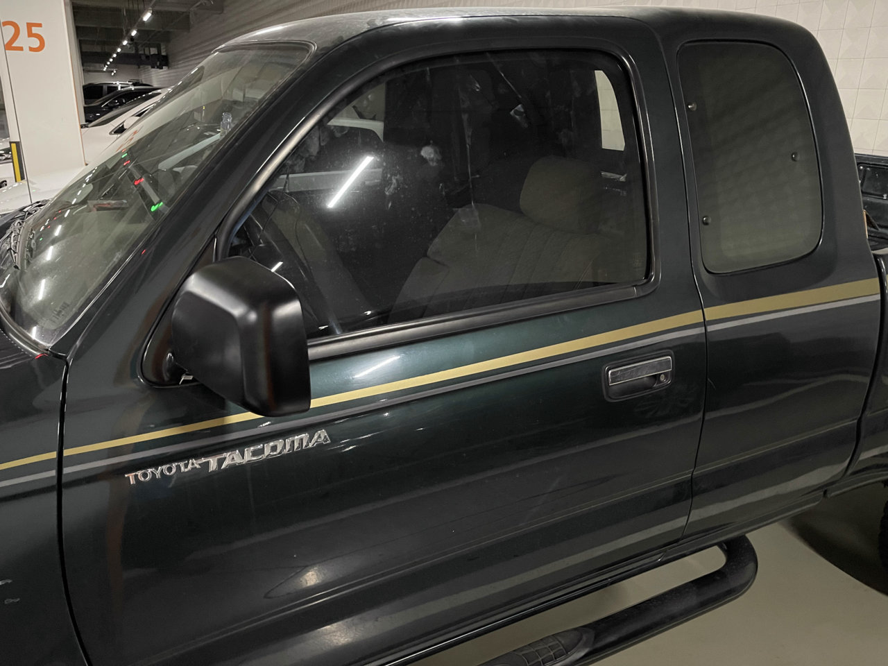

    Hi, I'm Charlie and I lived in South Korea from 2015-2022. This truck was first lent to my wife and I from my father-in-law after we were in an accident in our TJ. We ended up using the Tacoma for almost a year before reaching an agreement with insurance for the TJ. He ended up giving us the truck so we sold the TJ. Since we intend to keep it for a long time, I figure I might as well have fun with it.
    It's a '95 XtraCab Auto 2.7 L with manual hubs. It also has power doors and windows. When I drove it for the first time in March, 2021, it had around 115,000 miles on it.
    As far as modifications go when receiving it, my father-in-law had it repainted (poorly) several years back and added the side and tailgate decals. The original color is Evergreen Pearl and the paint job is similar but definitely not Evergreen Pearl. The tailgate also has a "V6" badge, although it's a 4 cyl. I'll likely remove at least the V6 badge at some point. Lastly, it has (had) SmittyBilt side steps.
    Here it is around the time we started driving it and immediately after a wash.
    The truck has now started it's new life in KY.

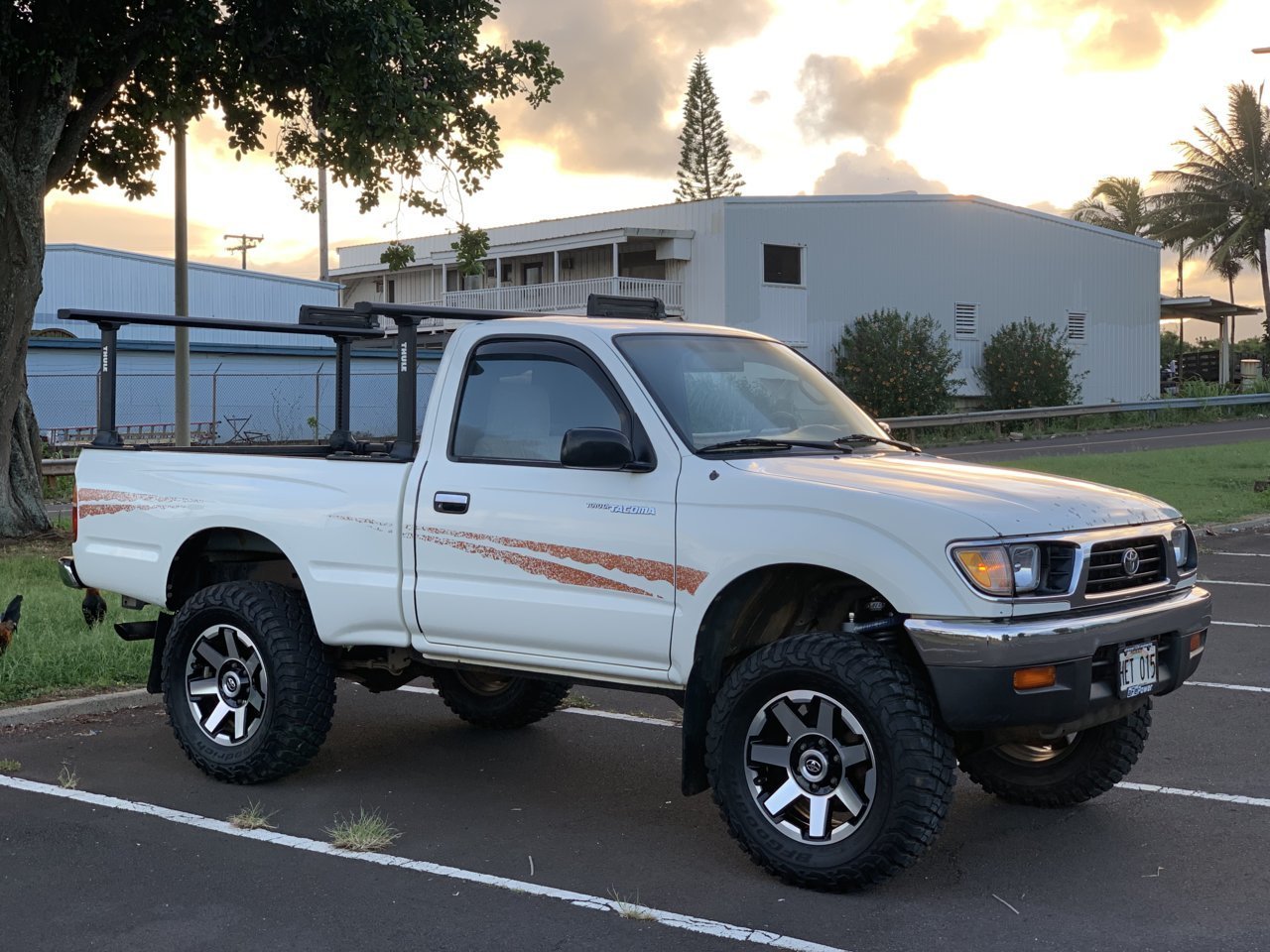

    oh the tacoma at the end if the bed yeah thats aftermarket, you can take it off and put a 4x4 trd decal, many put those on as the decal didnt come till 98.

    Also, Tacomas were never imported to Korea so someone way back when imported this here directly from America. The speedo is even in MPH rather than KPH. Our Jeep was actually imported by Chrysler so it has the KPH speedo. They don't have salvage yards or first gens here for that matter. There might be one a few in the entire country but I haven't seen it.
    The father-in-law did say he put on the tailgate badging so I don't think it's OEM because I haven't seen it on others. Are you sure the side stripe on my truck is OEM? I haven't seen that, as well.IMG_4699.jpg

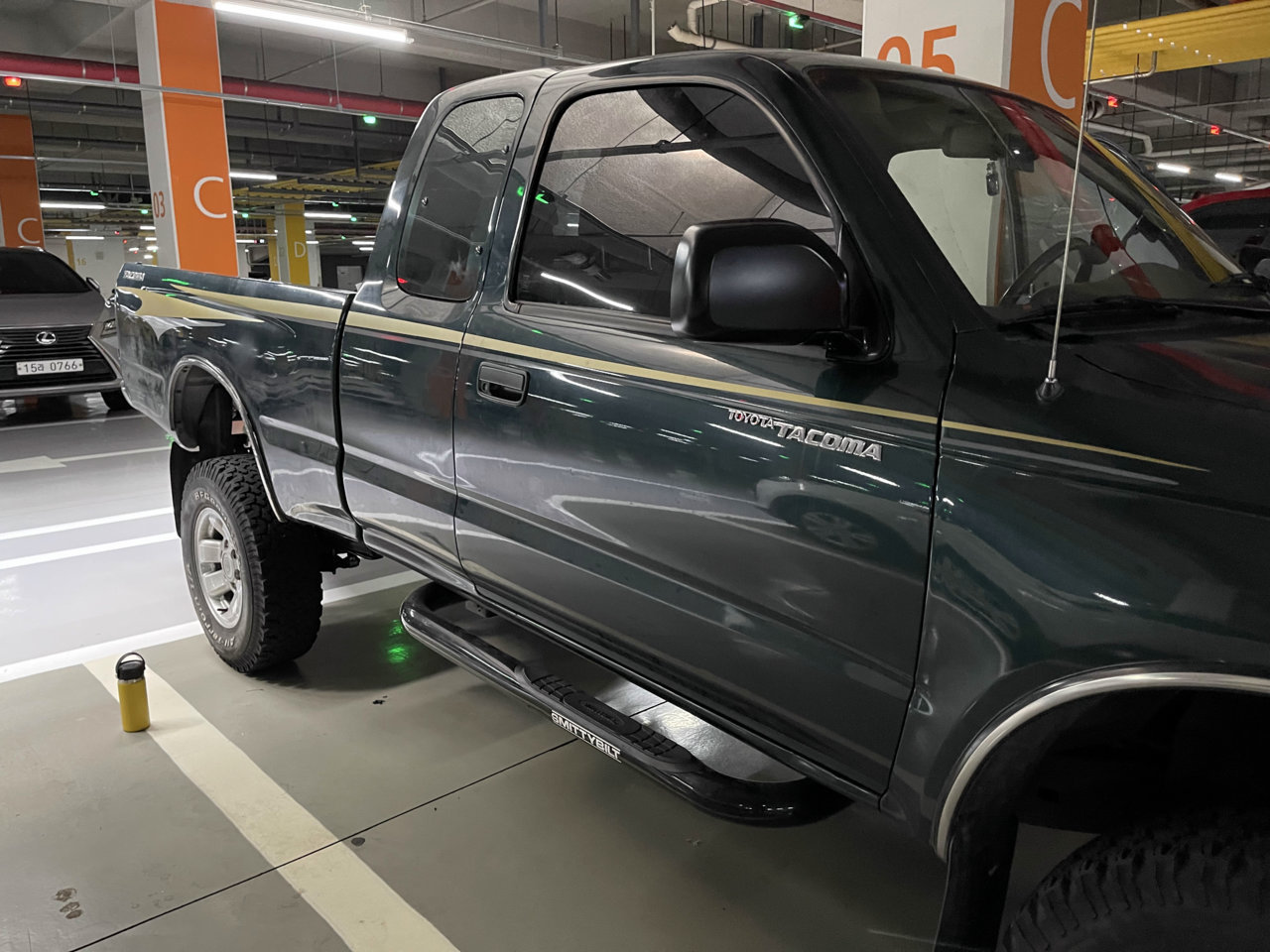

    yeah the side stripe is oem
    i think they stopped it in 97 tho

    I much prefer this style of stripe. If there was something for the XtraCab like that, I'd likely try to do it.

    there was, you can buy them online.

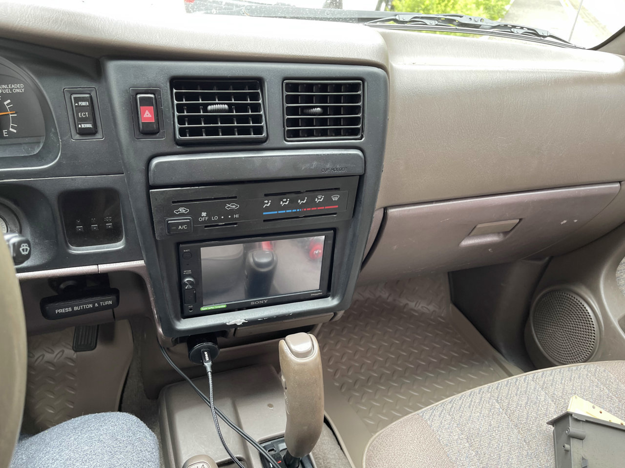

    In June, after driving for a few months and getting word from the father-in-law that he was giving us the truck, I decided to start work on it.

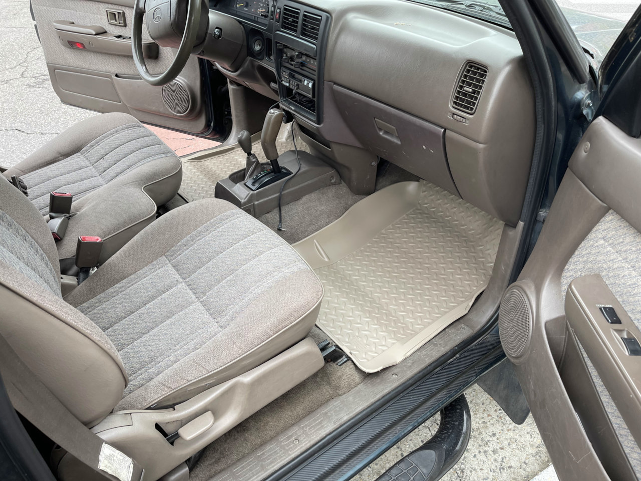

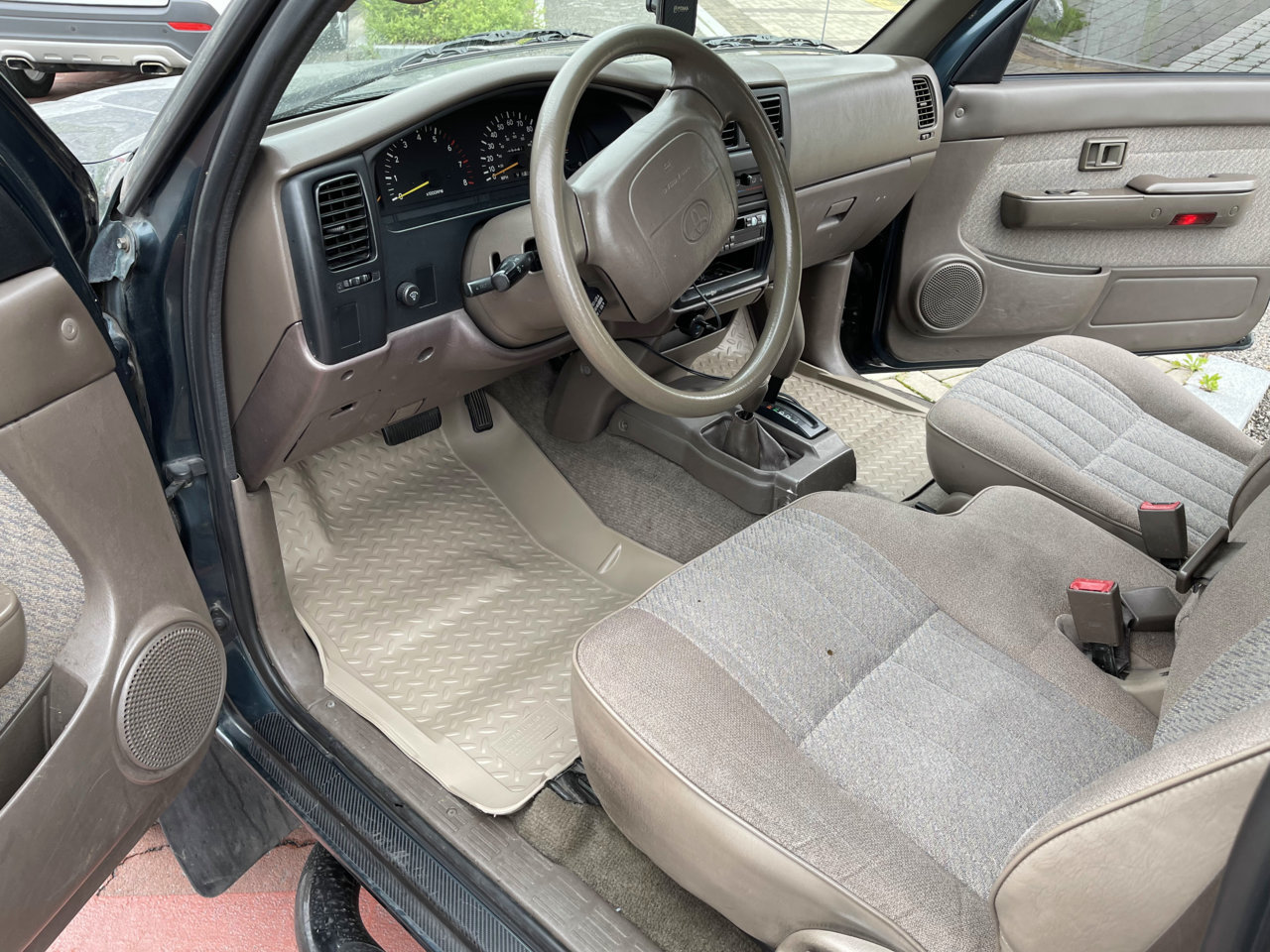

    I replaced the front floor mats with some Tan Husky liner since the original Toyota ones were disgusting and there were some rubber ones sliding around on top of those. I choose these over Weathertech and I'm happy with them. They fit nicely and keep the carpet from getting anymore filthier.
    Husky 35113
    Then, I moved over the double din head unit from the Jeep over to the Tacoma along with the metra wiring harness.
    Sony XAV-AX1000
    Metra 70-1761
    I'm not sure if they still sell this model, but I don't recommend it or any similar Sony model. I've got my eyes on a few floating units for the future.
    Next was the Hella H4 E-Code headlight housings with Philips X-treme Vision H4 bulbs (60/55 W).
    Hella 003427811
    A noticeable upgrade and worth it but still not where I want it to be. I'm thinking of a wiring harness with higher wattage bulbs in the future.
    Last for June was the BH3D Printing dual cup holder (because the one over the stereo makes me nervous and I drink ice coffee in winter - can't have your heater melting your ice).

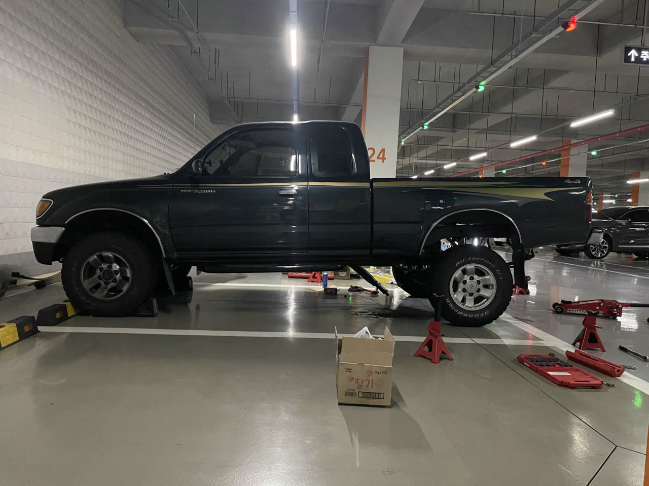

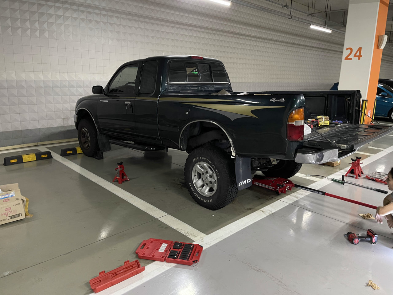

    The next order of business for me was the rear suspension. I installed the following in early August - mileage at 116,000:
    Dakar Leaf packs - OME-CS019R
    OME 1/2" lift greaseable shackles - ARB-OMEGS22
    OME leaf bushings (2 sets) - ARB-FK21
    Wheelers 7.75" U-bolts - WHE-U7754X
    Bilstein 5100's (rear set only) - BIL-BE5-D559-D560-PAIR
    I measured a 4" difference before/after. But that was with the 2" blocks. So it seems to have lifted the rear 6" (5.7" on driver side).
    Before the install, the truck was riding on factory length shocks and with the 2" blocks, the shocks would overextend even over tiny bumps and just road rough in general. After the install, it rides slightly better but is still overextending over speed bumps. Wheelers claimed that this is because I haven't yet lifted the front and they stated that 6" of lift in the rear is impossible with the stuff I ordered.
    Since I wasn't (and am still not) ready to buy coilovers, I opted for the cheaper route of putting about 300 lbs of sandbags in the bed + ordered a spacer lift to level it out until I'm ready to spend more. Unfortunately, the sandbags didn't improve the ride enough.

    My main goal before September was getting my Jeep stereo over to the Tacoma. Since the door panels would be off, I decided to change both window regulators as well as the door handles. The window regulators because the truck is 26 years old and still on the originals and I wanted to do it while I had the panels off and was doing sound deadening. The door handles because I want to move away from chrome on this truck. I think black looks better. In addition, I changed the side-view mirrors to the '01-'04 style. The parts that I ordered:
    Window reg and motor (L) AISIN - RPAT031
    Window reg and motor (R) AISIN - RPAT032
    Outer door handle in black (L) ACI - 360814
    Outer door handle in black (R) ACI - 360815
    Side-view mirror (L) TYC - 5290032
    Side-view mirror (R) TYC - 5290031
    Here is the before and after:
