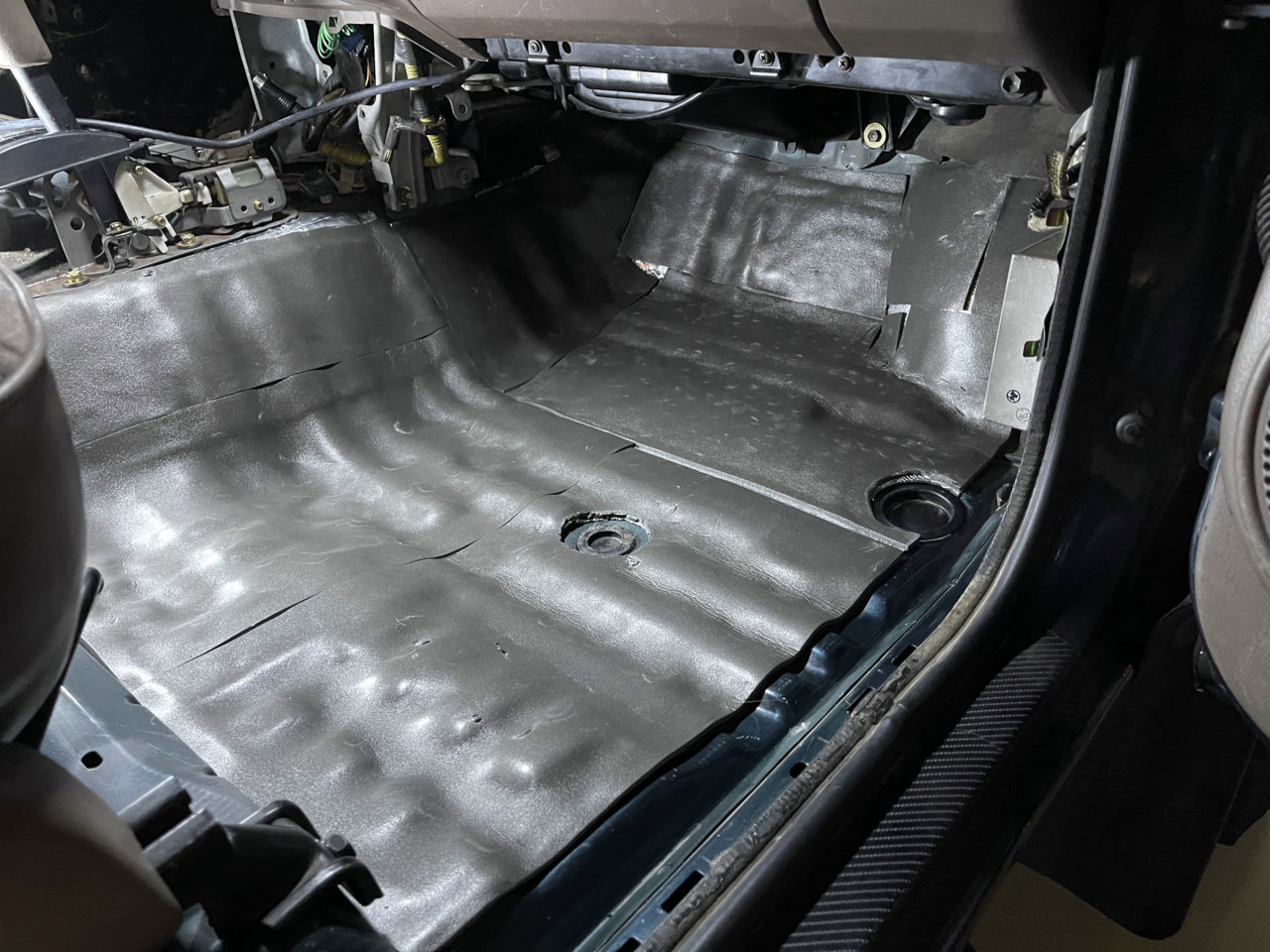

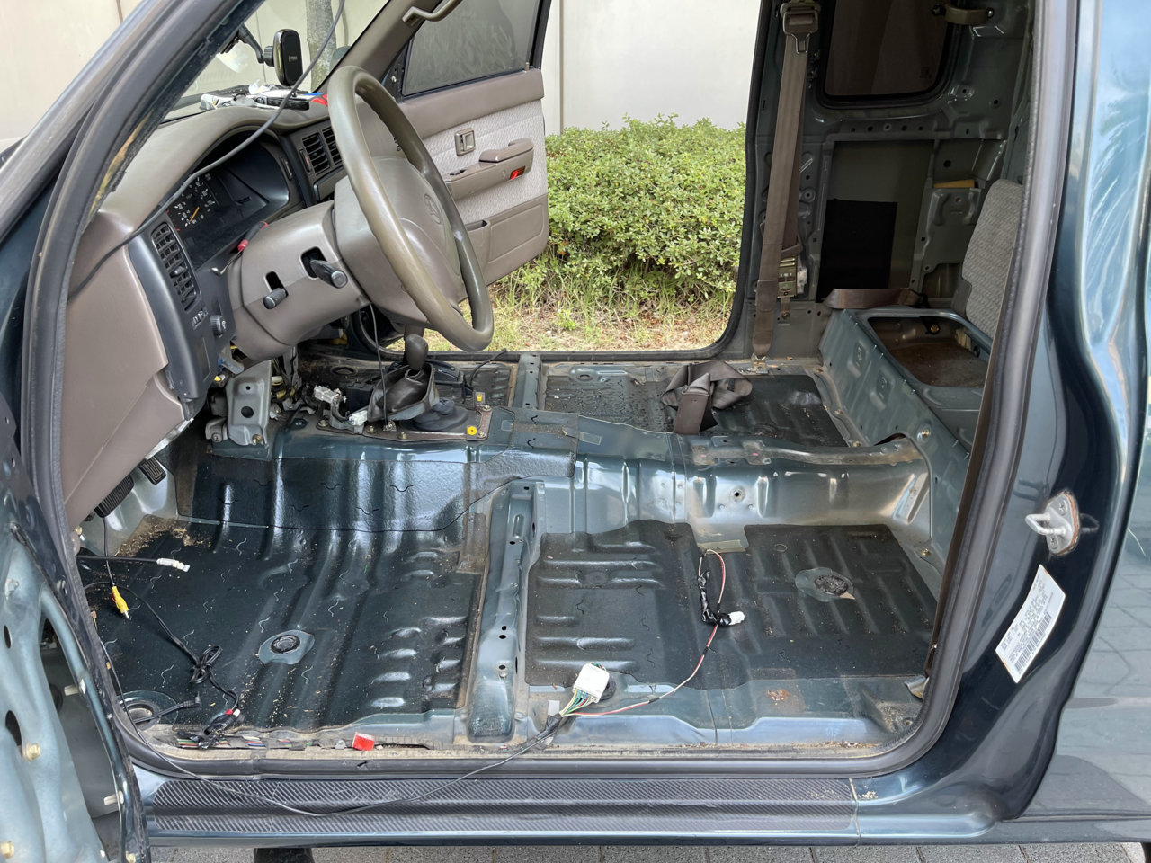

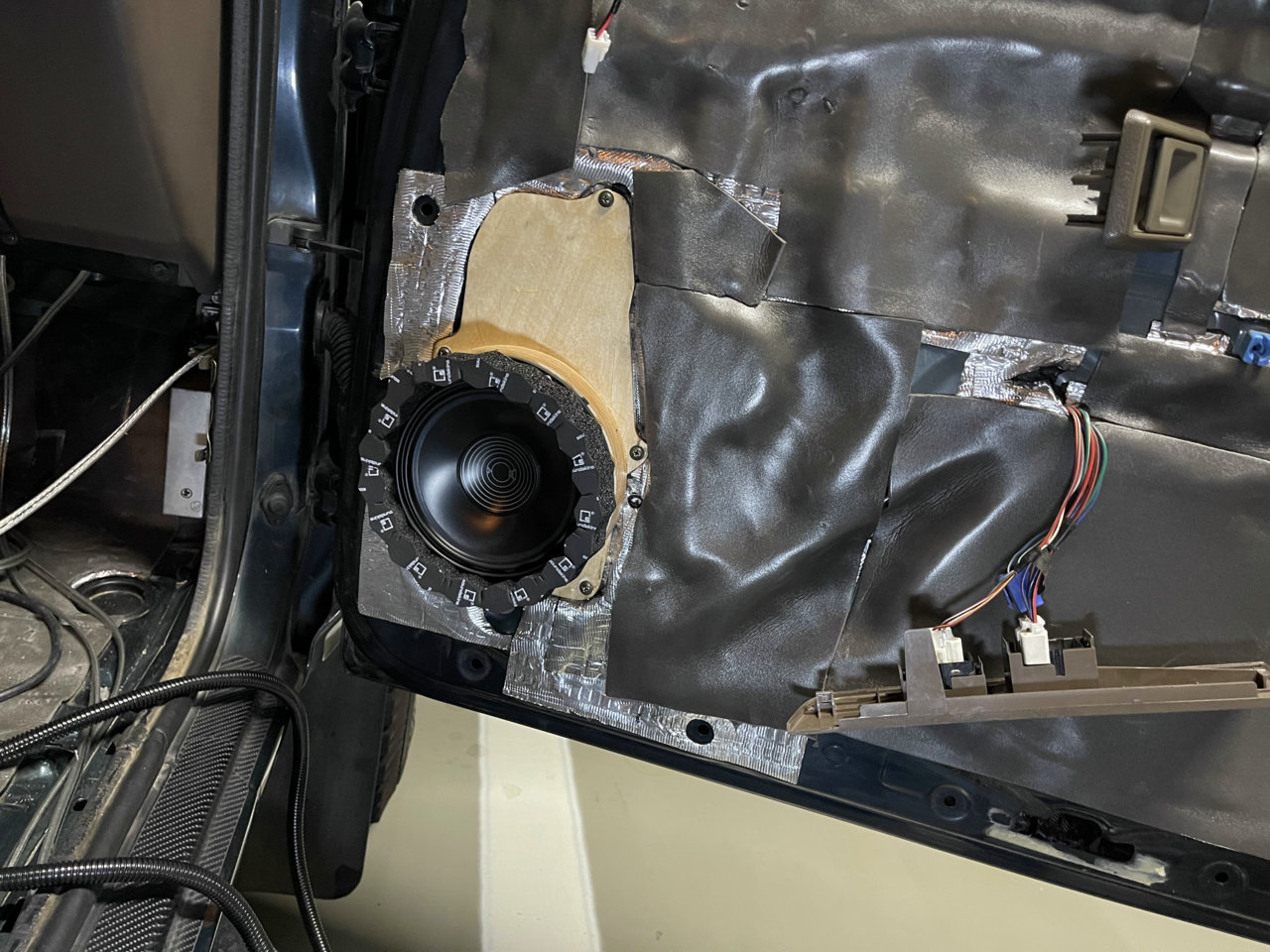

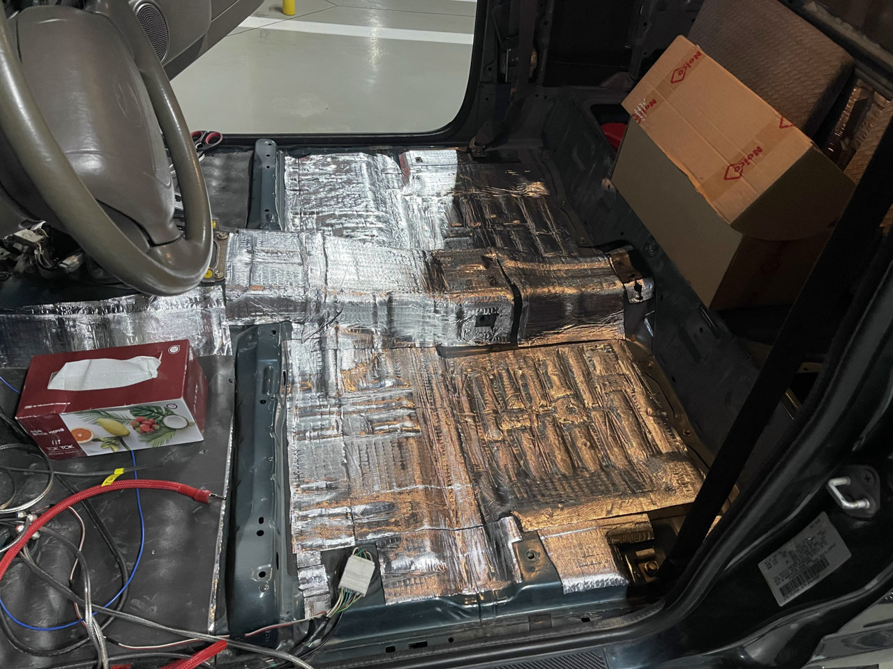

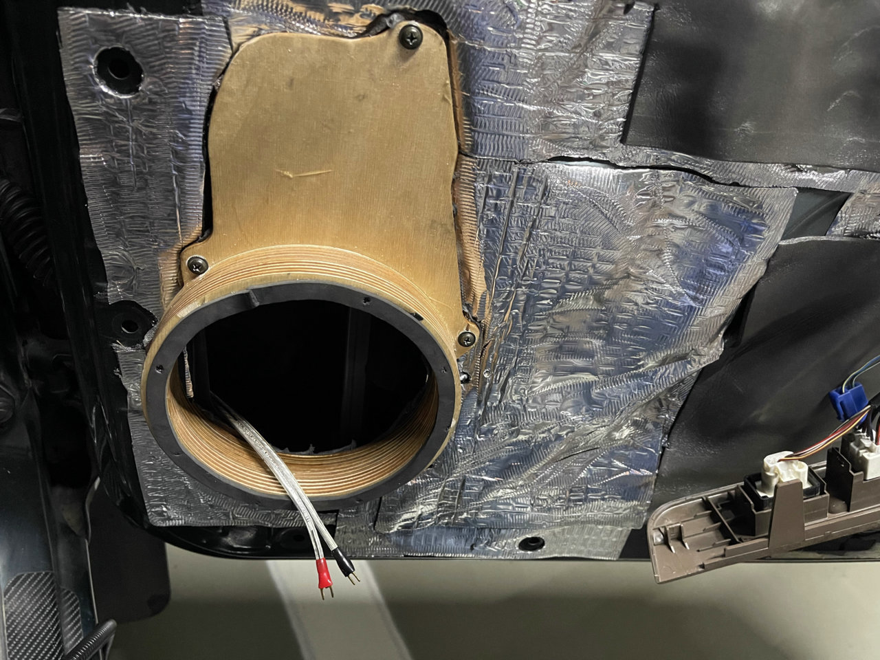

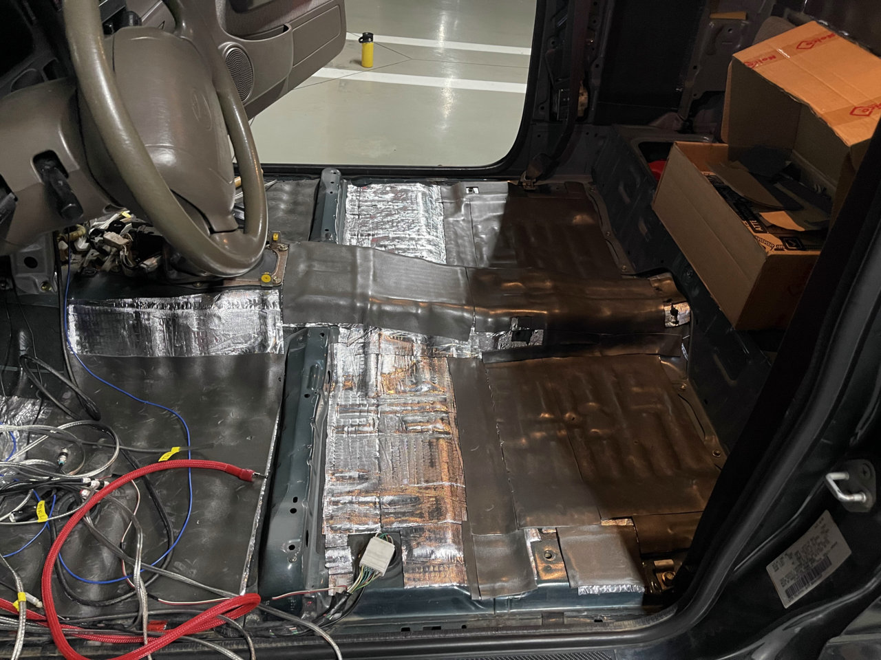

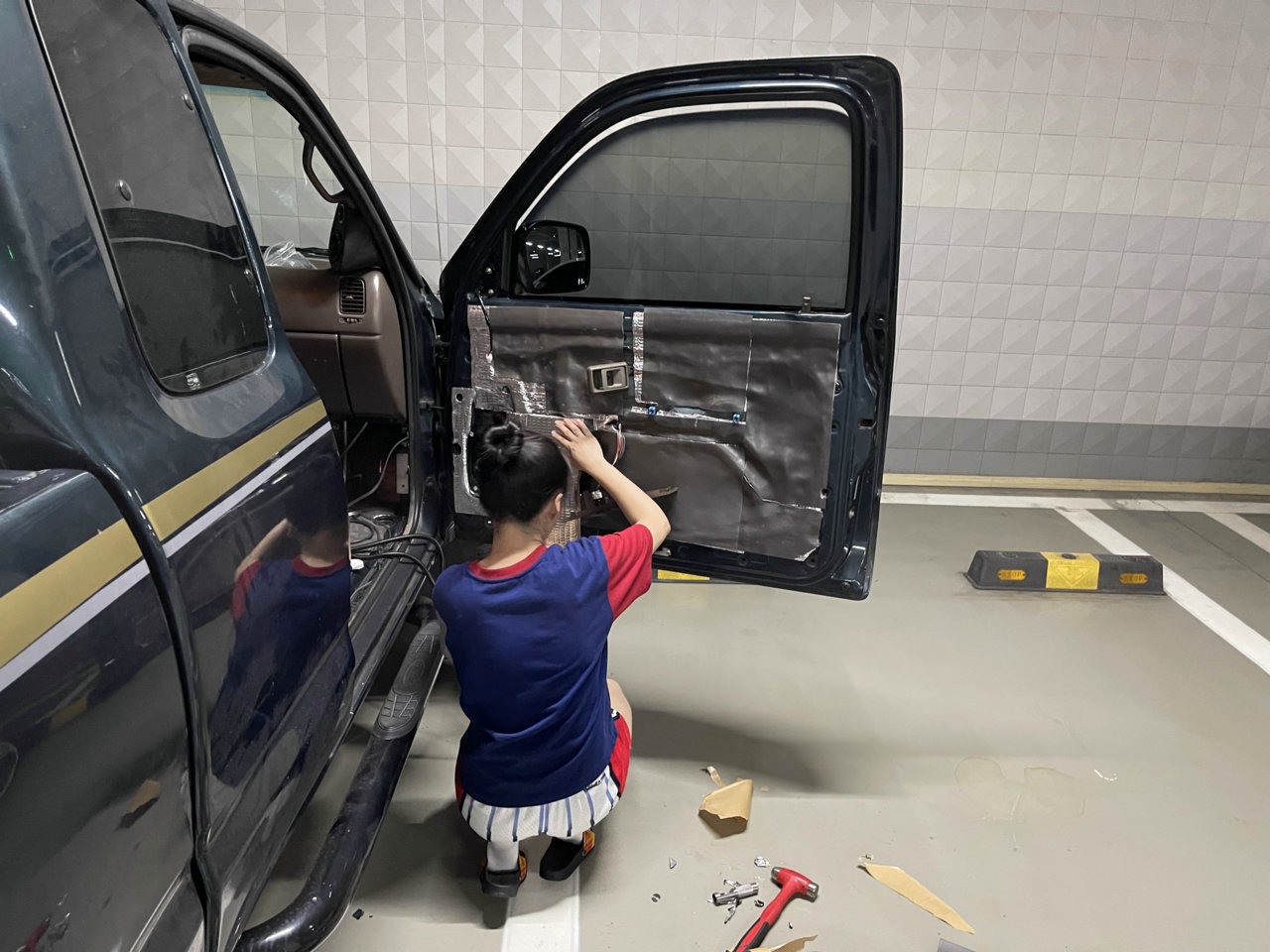

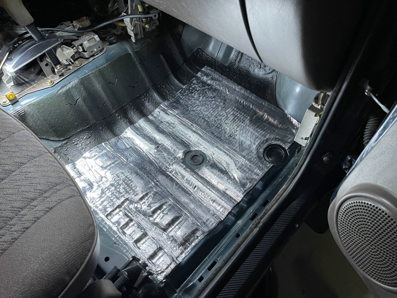

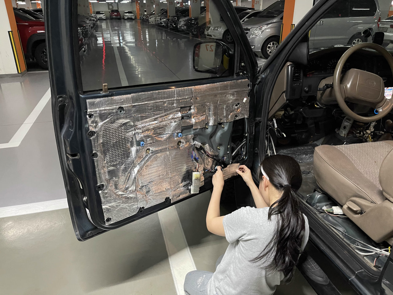

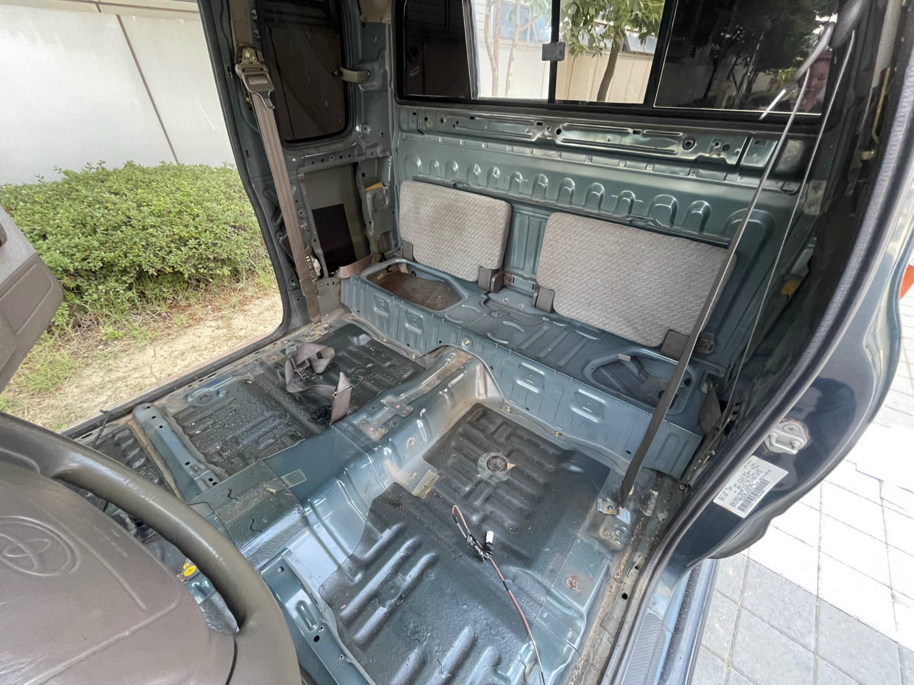

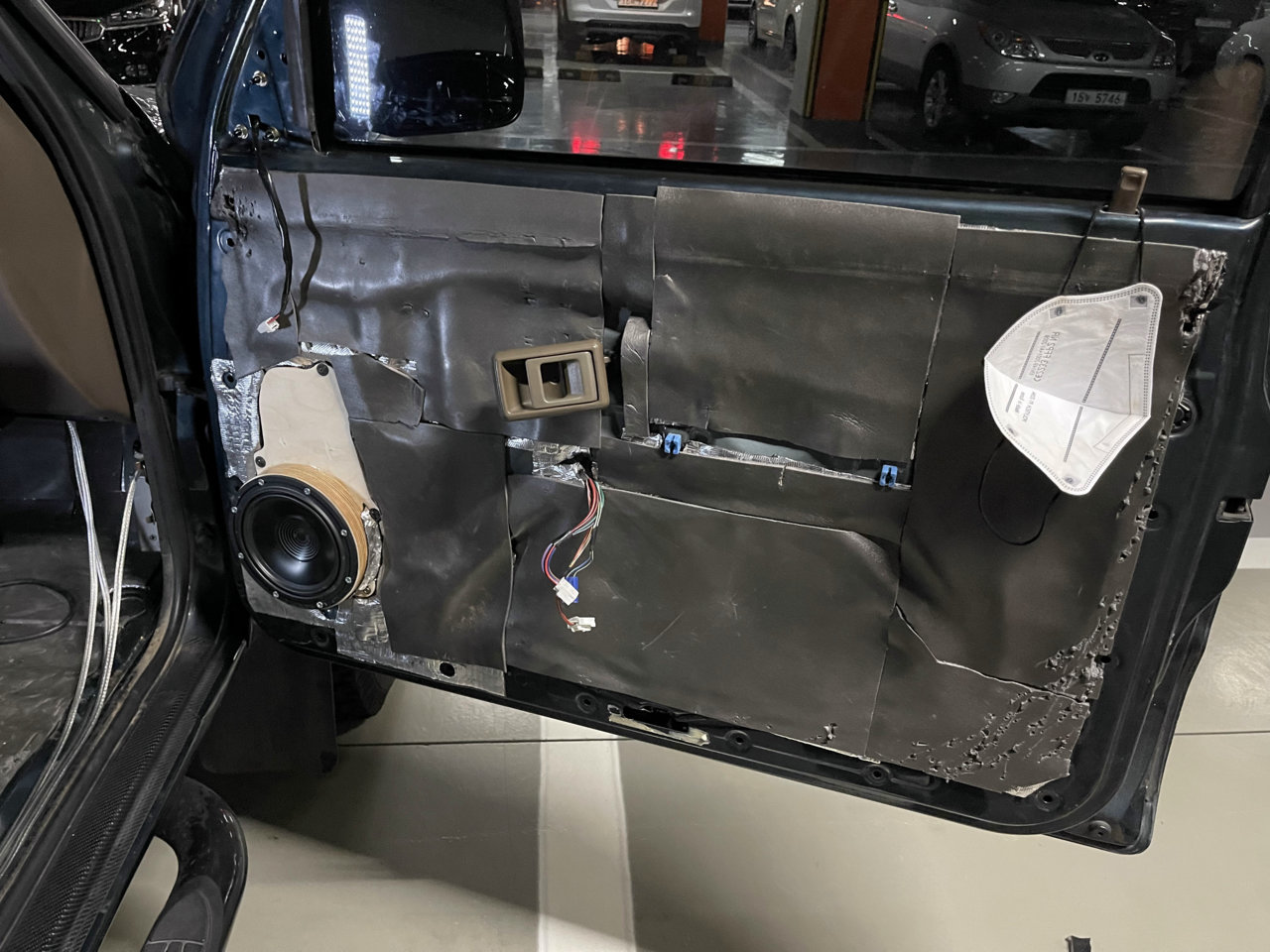

    I spent pretty much all of August and the first week of September working on my car stereo, ordering parts, waiting, working on it some evenings after work and on weekends.
    For sound deadening, I used:
    Siless 80 mil - 72 sq ft
    Noico RED 150 mil - 72 sq ft
    I basically covered the entire interior, as high up on the firewall as I could get it, I backed many of the plastic panels, too.
    Before piecing the car back together, I got new carpet. (ACC cutpile in Oak color) It was a real pain in the ass to fit since there isn't a single hole cut. A lot of guess and check. One hole lines up and it pulls another hole out of place. I also had to cut holes for stereo wiring. It's not a perfect fit but it's better than before. If I had to do it again, I'd probably order black carpet.

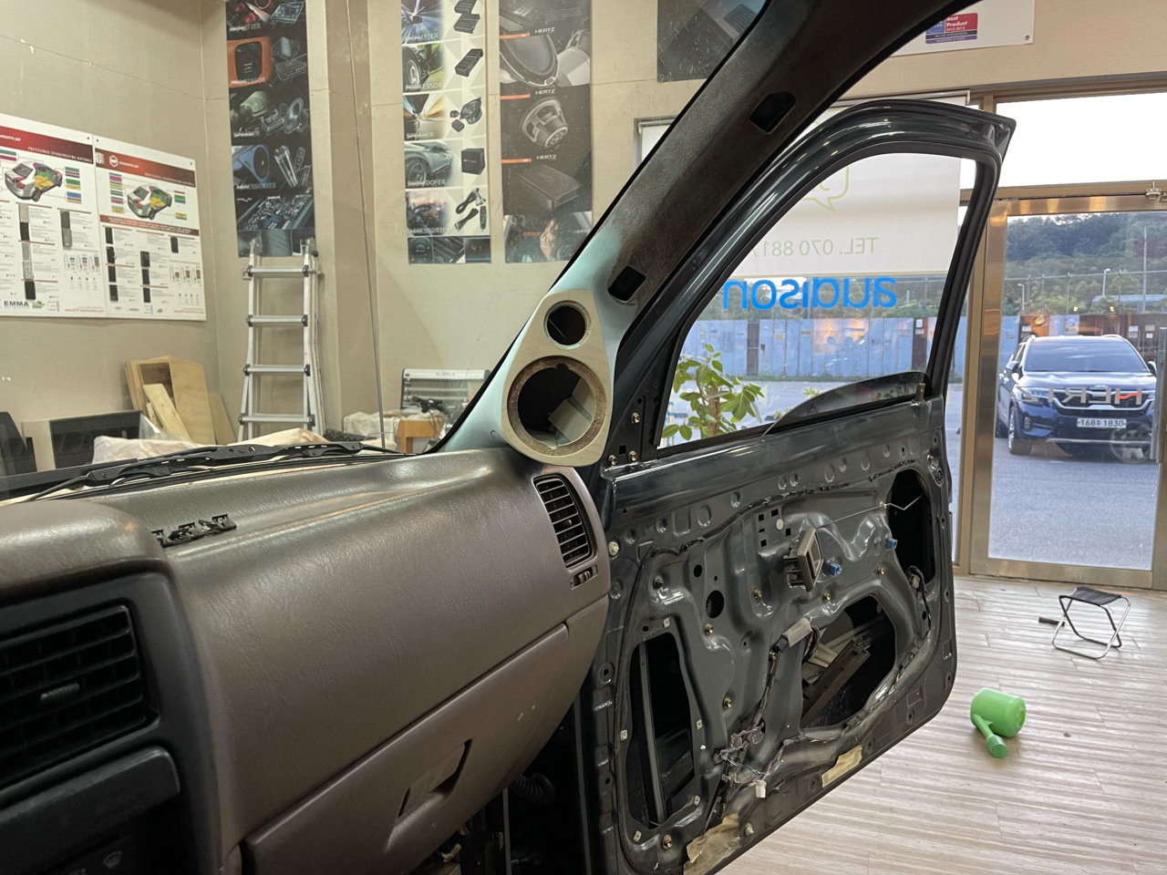

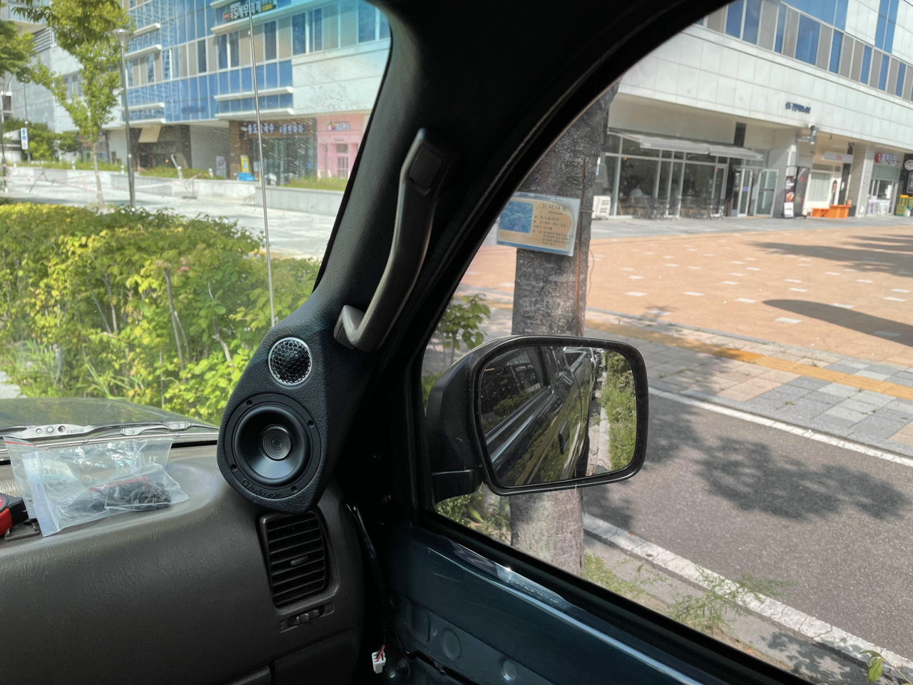

    I will list the components used. All of this came from the Jeep, except I had to order new wiring and a few things here or there.
    AudioCircle Berlin Line 3-way component set
    JL Audio CS113TG-TW5v2 (13" TW5 in sealed wedge-shaped box - 2 ohm)
    JL Audio XD1000/5v2 (1000 W - 5 channel amp)
    Helix DSP Mini
    Helix URC.3 controller (contains 2 sound presets and system volume and sub control)
    Stinger 7000 series RCAs
    All speaker cable is AudioPlus (high end Korean brand)

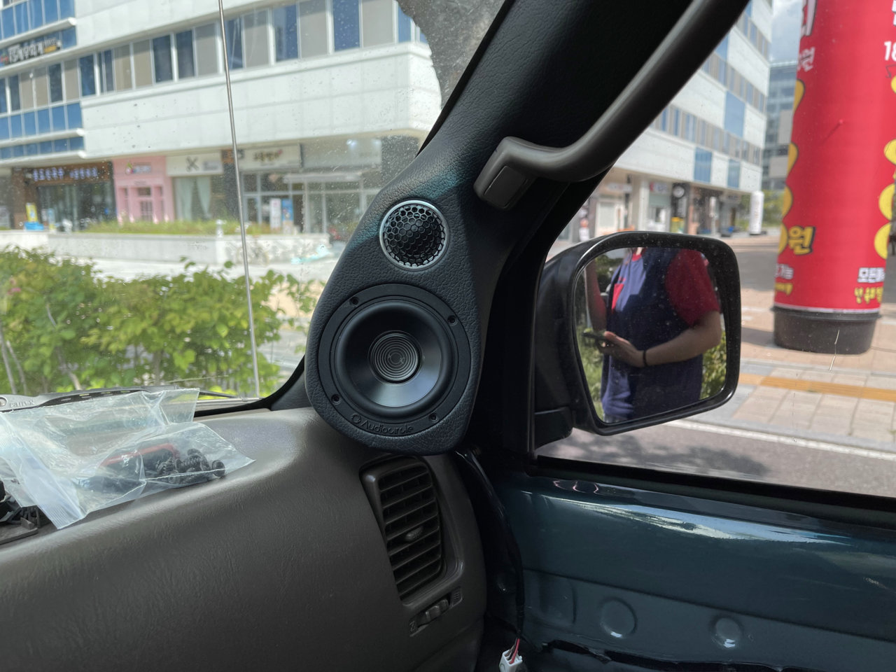

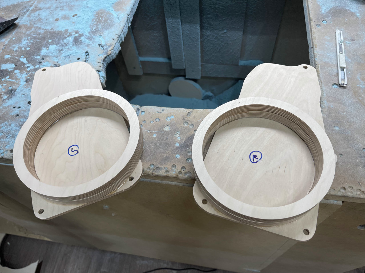

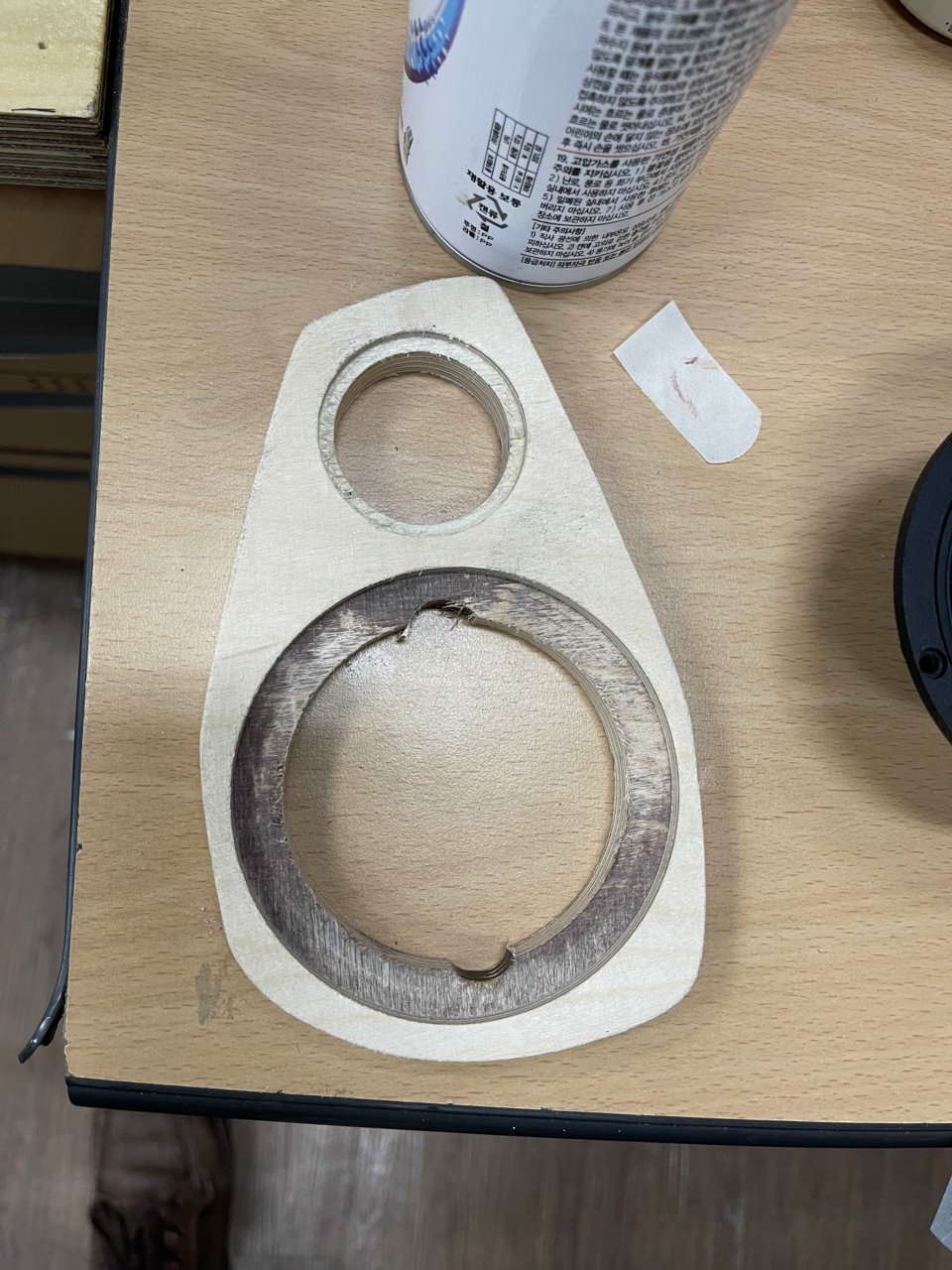

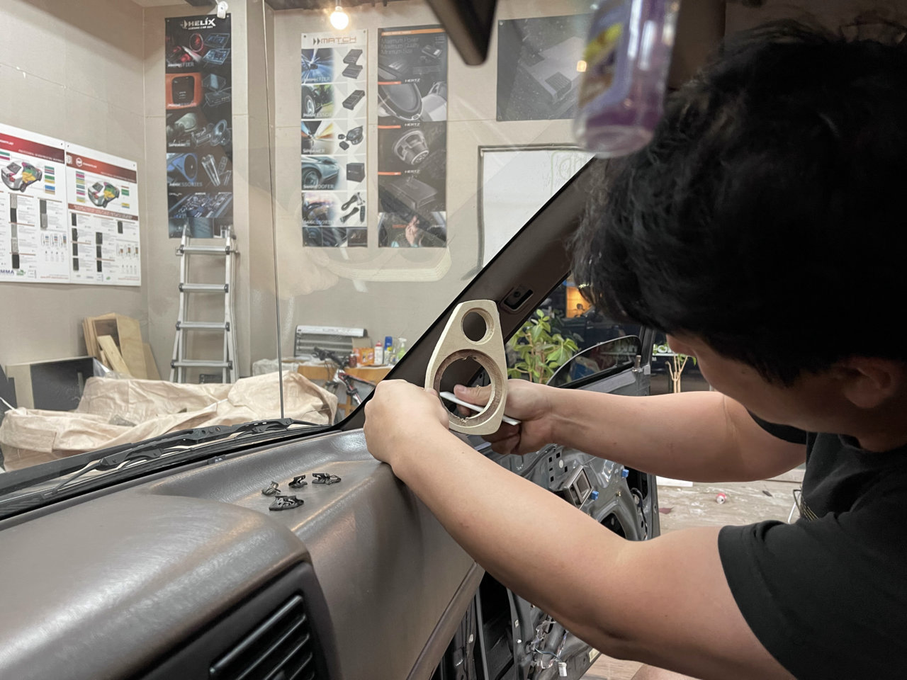

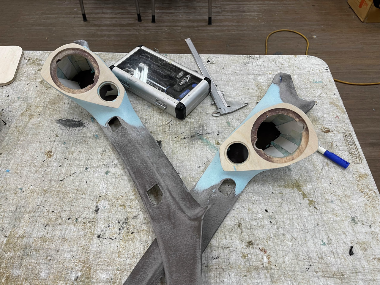

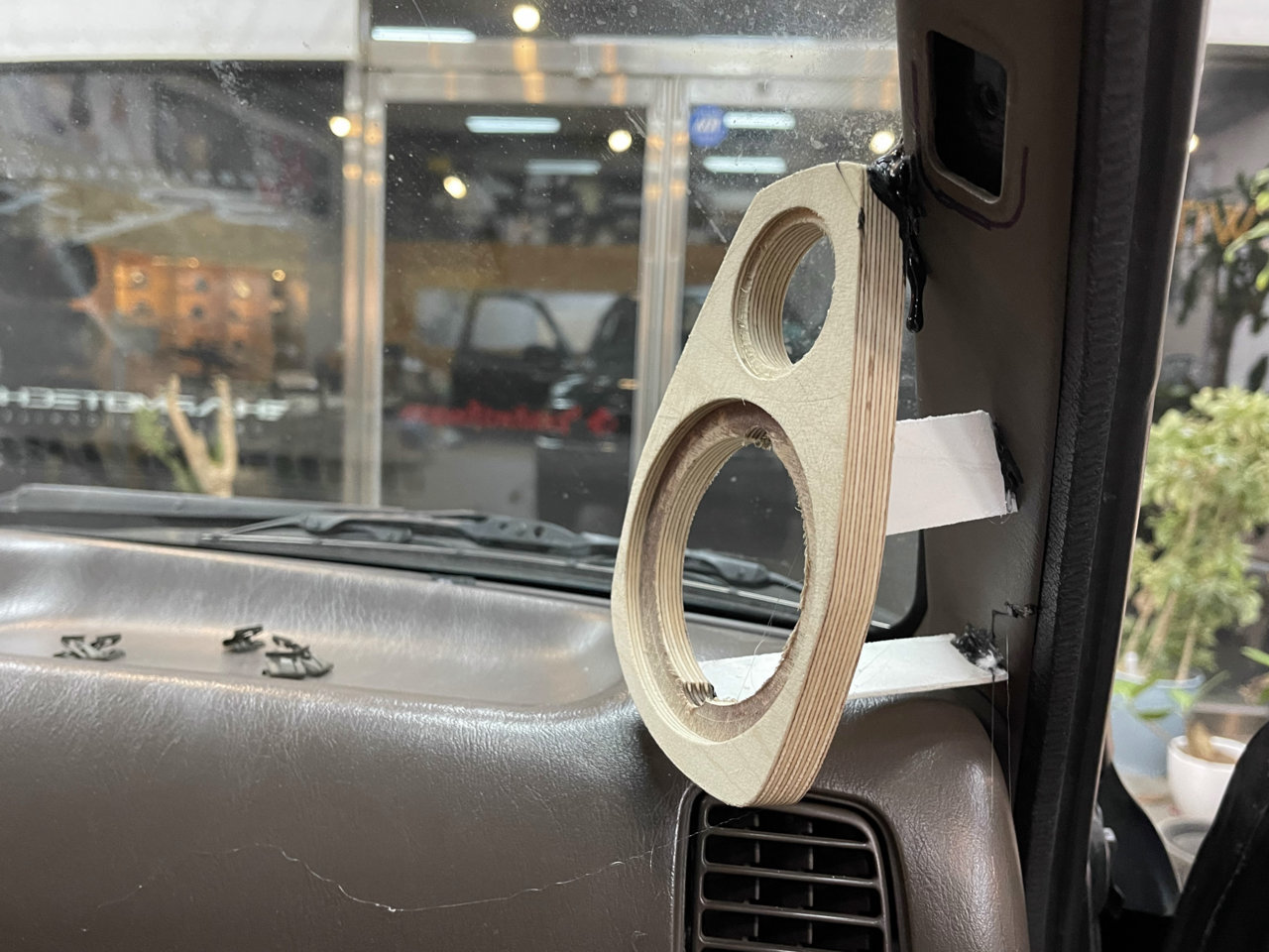

    I had a local shop build a-pillar pods for the 3.5" midrange and tweeter and a speaker bracket for the midbass. Cost around $300 for both.
    He didn't have anything to wrap it in that matches the oak color so he just did it in black vinyl. I thought it would look weird with the oak grab handle but I don't think it looks bad at all.

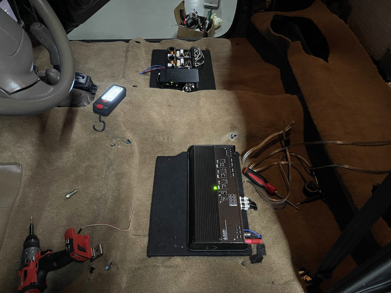

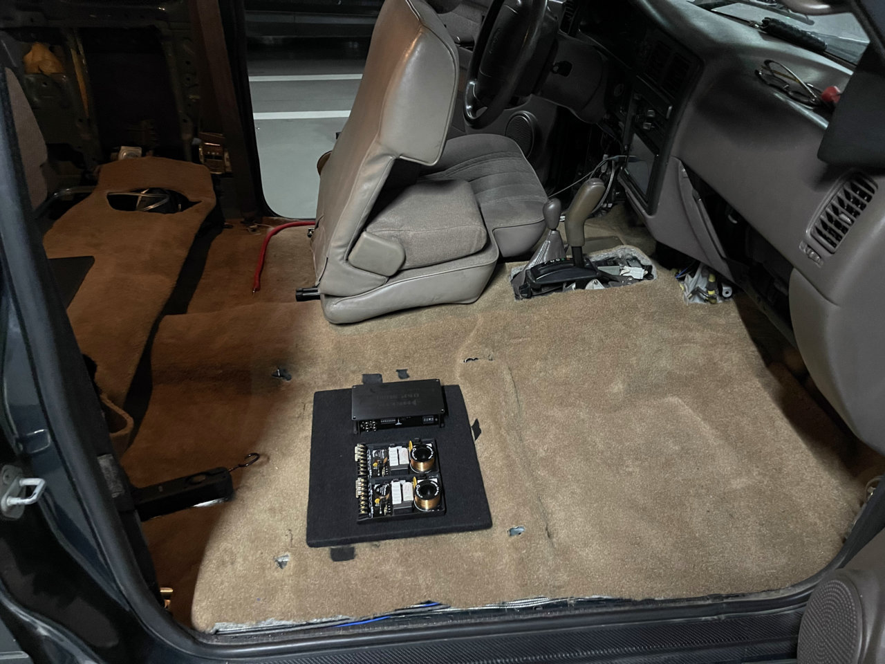

    Under the driver seat I mounted the five channel amp and under the passenger seat I've mounted two crossovers with the DSP. They are mounted on a piece of particle board wrapped in black automotive carpet.
    Channels 1/2 on the amp go to the crossovers powering mids and tweeters
    Channels 3/4 go to the midbasses
    Channel 5 goes to the sub
    These pictures show the new carpet.

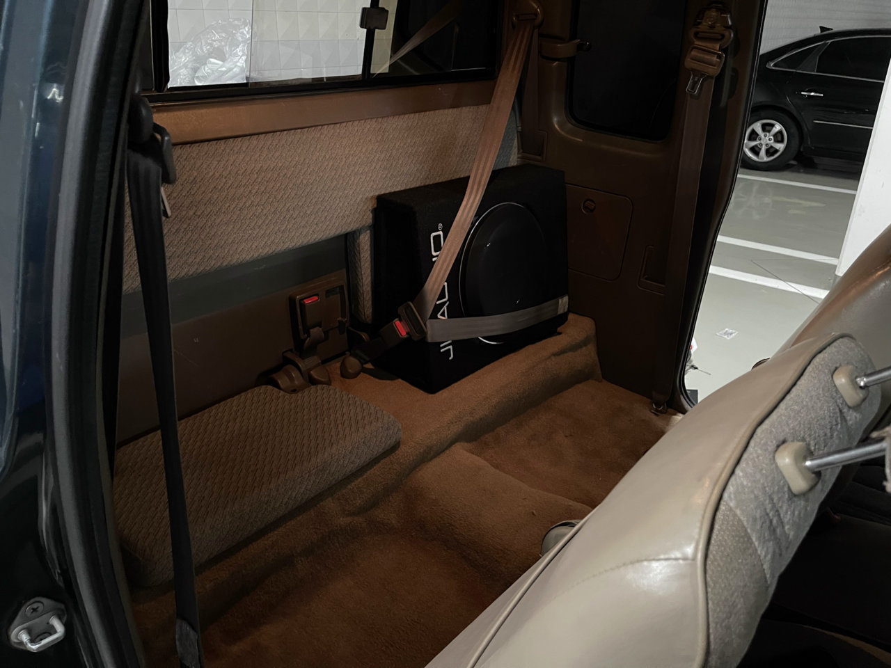

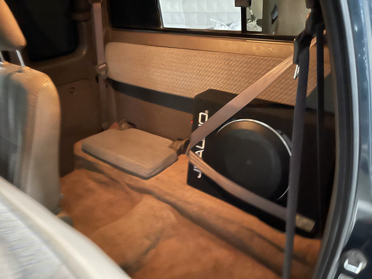

    With everything finished up, a look into the back seat..
    The sub being held by the seat belt looks stupid but it actually works very well and holds the sub very securely.
    I'm not really satisfied with it so I probably will end up redoing it later. I'd like to find a way to get some 8-10" midbasses up front and go fully active and ditch the crossovers.

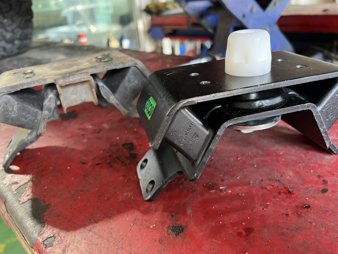

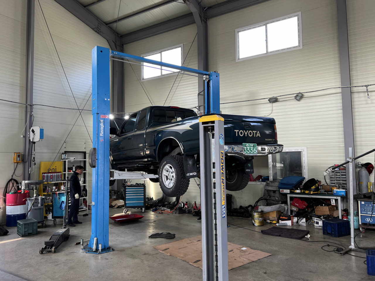

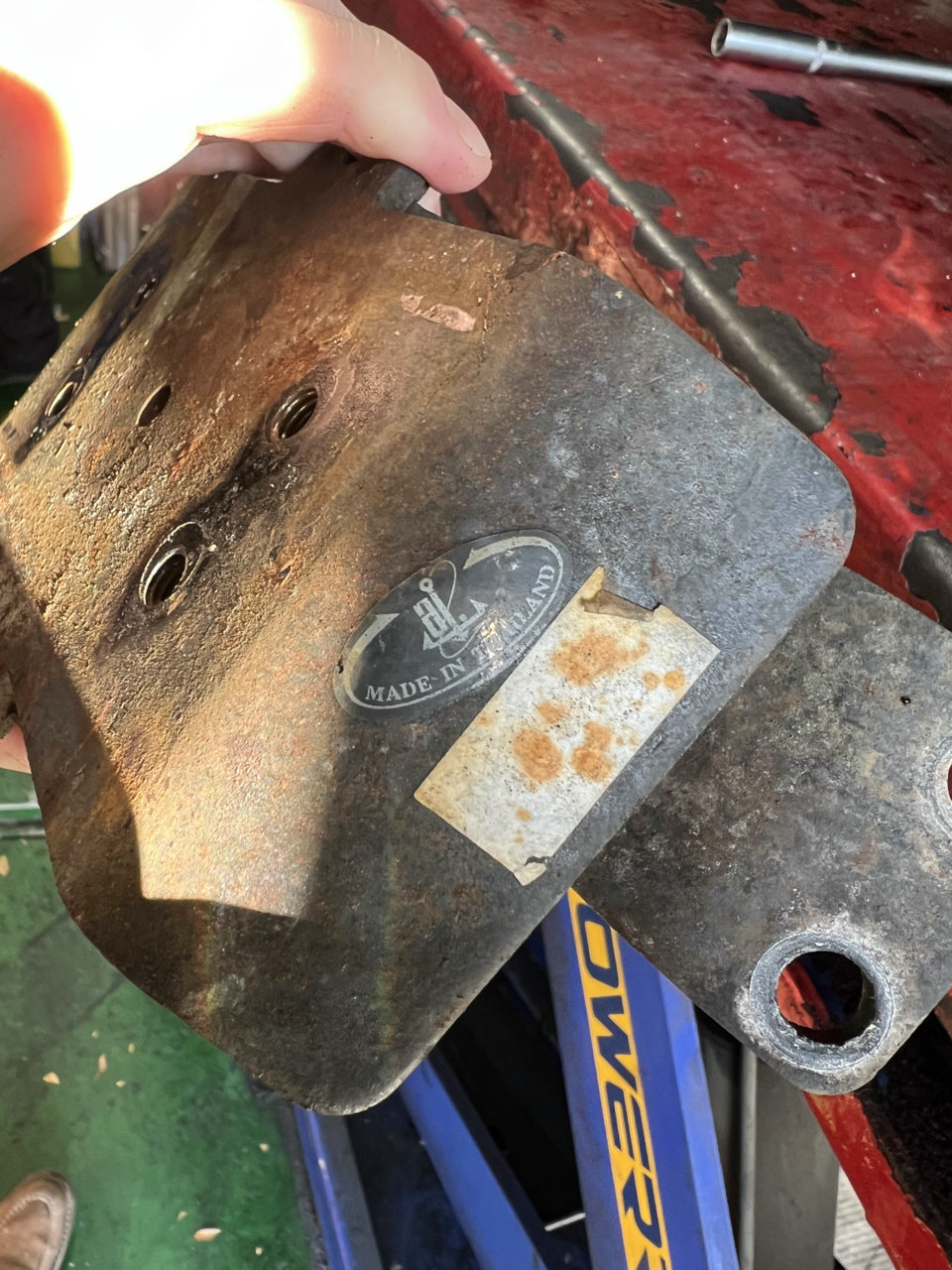

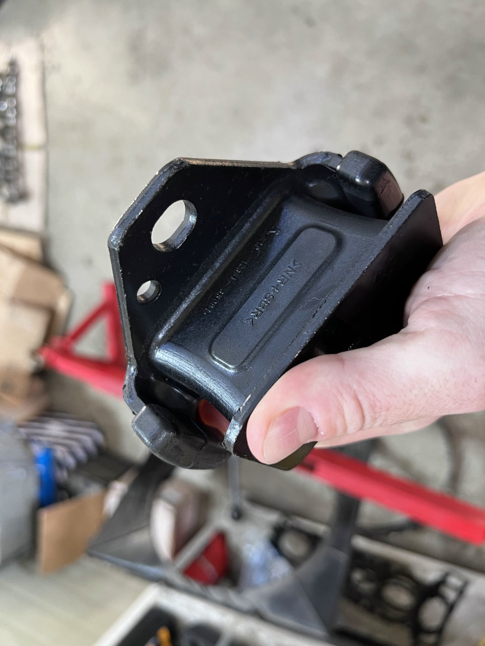

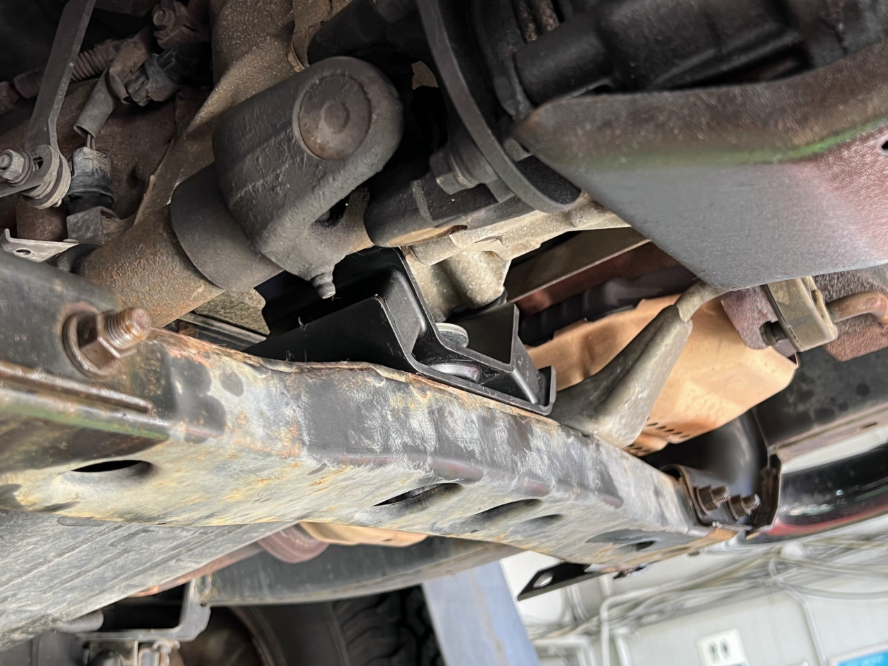

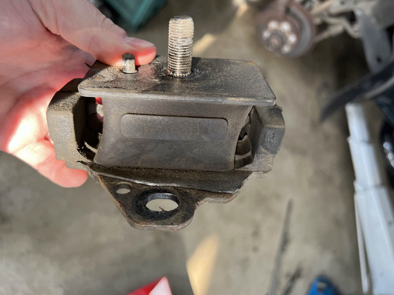

    The next things on my list to take care of were engine and transmission mounts. I decided to go with Toyota on these parts.
    For the motor mounts, I ended up in a city a little south of Seoul, called Pyeongtaek. That's where the US army base is. The shop name is Detroit Motors and I was recommended to go there because the guy deals with many US soldiers and speaks English.
    Since I'm lazy, I had him change my oil too. The price came out to 230,000 KRW or $192 USD.
    The motor mounts were in good shape. I was hoping they would be awful, to justify spending all of that money.
    I also pulled out a new wiper fluid reservoir (mine was cracked up and unable to hold fluid) only to discover it has a big hole in the bottom. So it will have to wait.
    Drove for an hour and a half to get home and I'd say it felt about the same. I was pretty pissed after I got home and parked though because...

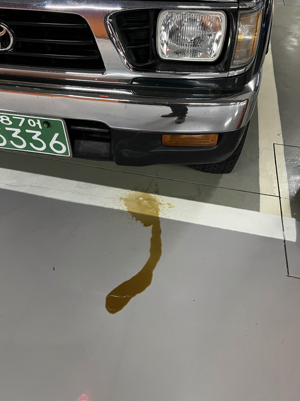

    I guess they thought my coolant was low and overfilled it? without telling me anything. I sent a text message with photos and videos and he has yet to reply. At least I now know that this truck needs a coolant flush.
    Skip ahead to December and the trans mounts arrive. I decided to hit up a local shop, or "Car Center", as they are called in Korea. This guy, to my surprise spoke English and he charged me 70,000 KRW or... $59 USD to change the mount. I was very satisfied this time because the mount that he pulled was clearly not a Toyota one...but something made in Thailand. No thanks.
    I think it might actually run a little smoother. But there was no dirty coolant dripping into my battery tray when I got home, at least.

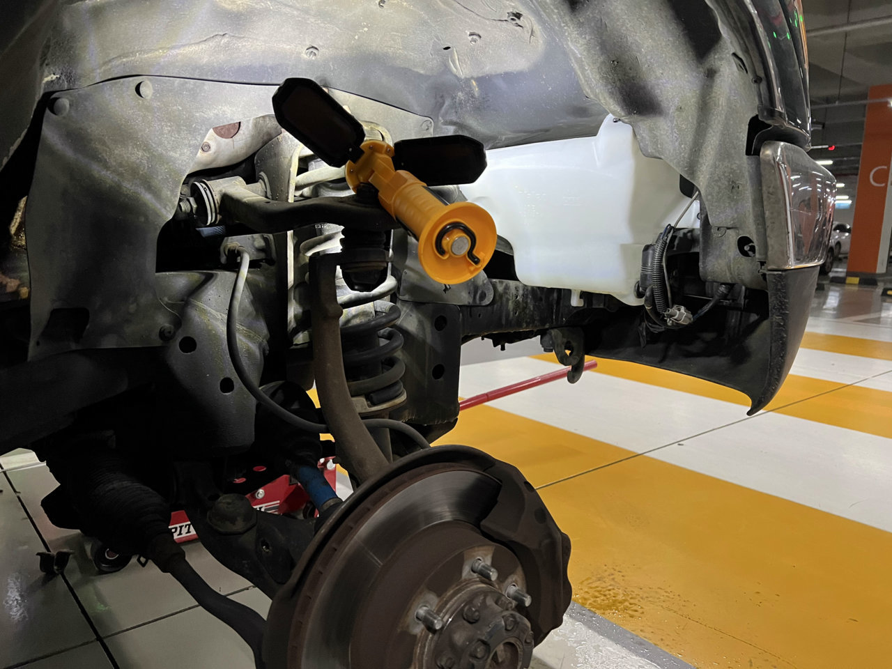

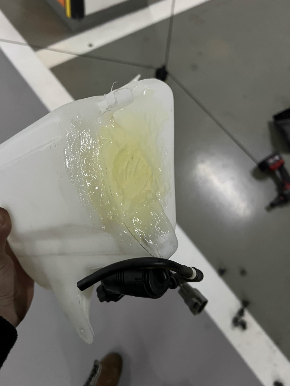

    So a few months back, I ordered a genuine Toyota washer fluid reservoir from Ebay and later realized it had a big hole in the bottom of it. After searching I found out that this was for a later year first gen that has a sensor in it to tell you when the fluid is low. So I spent about a month repairing it with this plastic repair stuff that I bought at Korean's version of Walmart. I put a layer of masking over the hole and then put a layer of glue once every couple of days, gradually spreading it out a little further. After about a week, It seemed strong enough to use but I kept going just for peace of mind. This is what it looked like before the install:
    Here it is installed:
    Then I realized that the plastic cover goes on together with it. (I wasn't the one who removed the broken original) So I had to remove it.

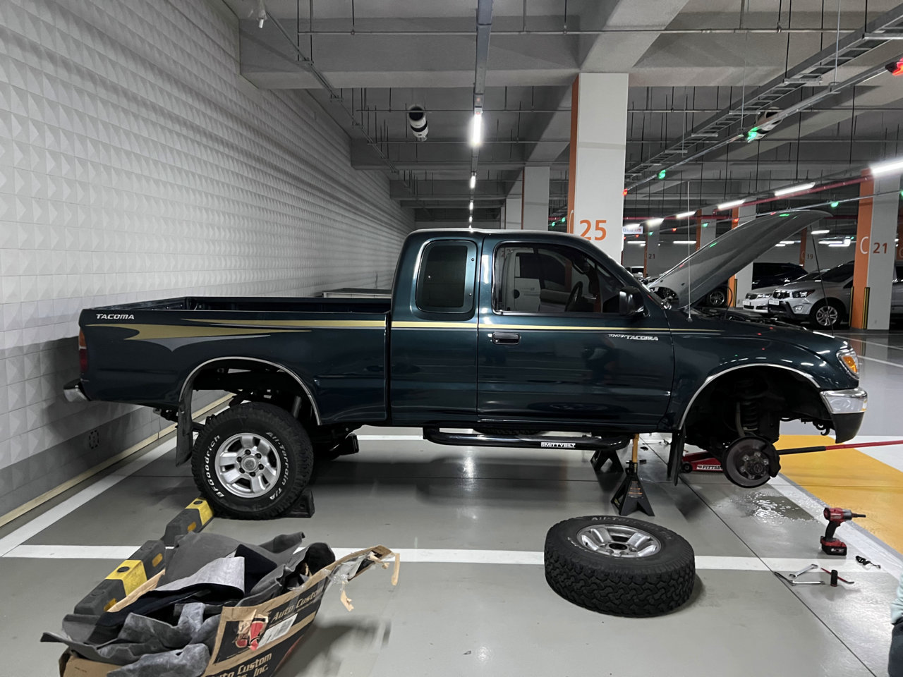

    Here's a pic of the parking garage I work in and what my truck might look like if the front were lifted.

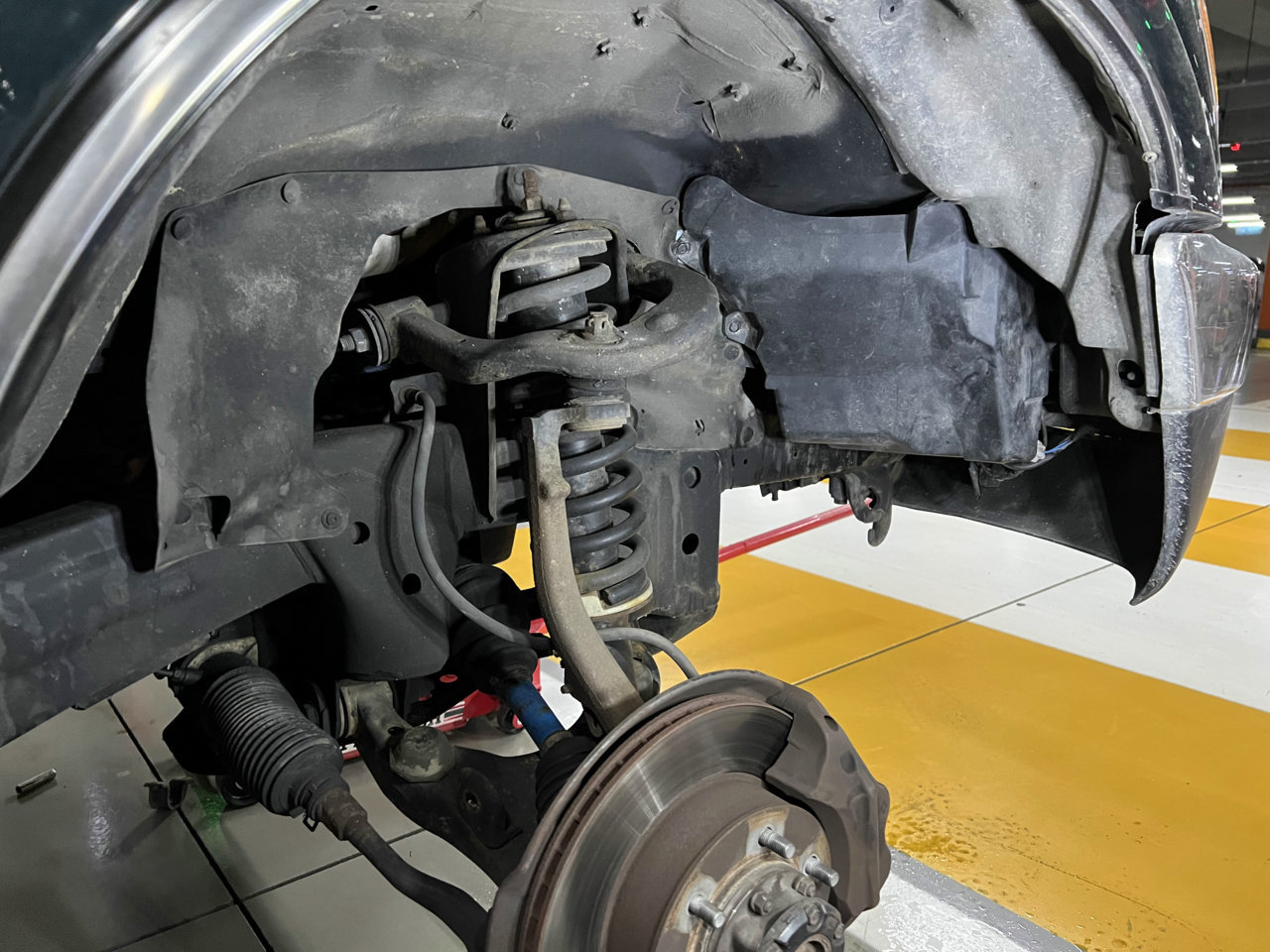

    I thought about installing the 2.5" spacer lift that I got in the mail from Wheelers but I ran out of time. It's probably a waste of effort since I have coilovers coming.
    I also removed the sway bar today. Those 12mm bolts are a pain in the ass to get to and with little space for ratcheting.

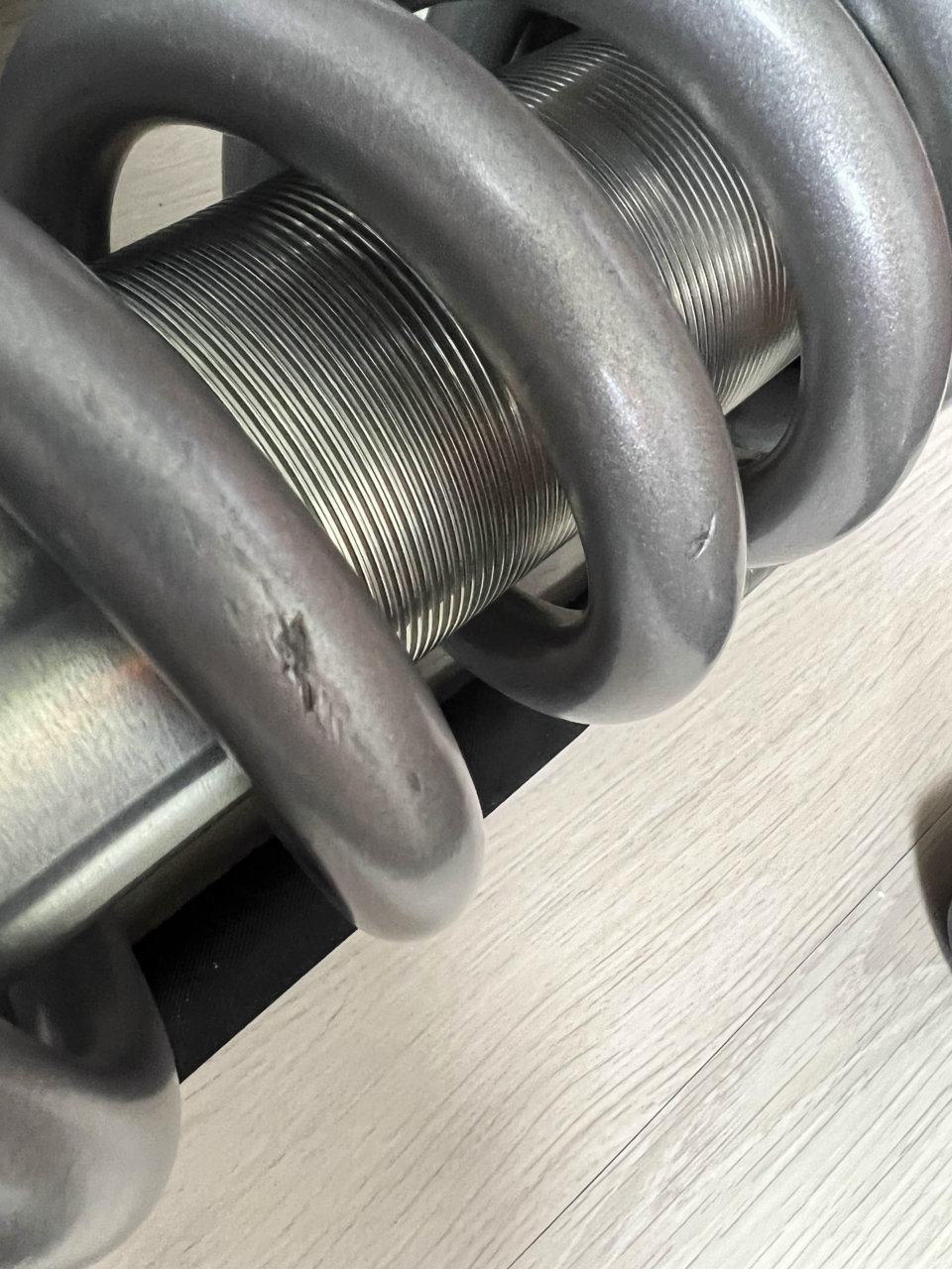

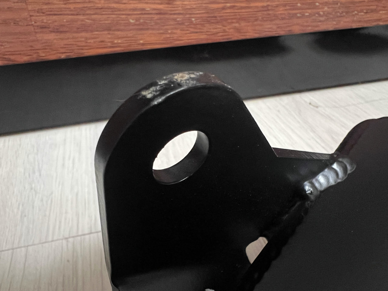

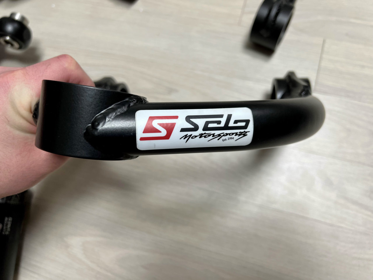

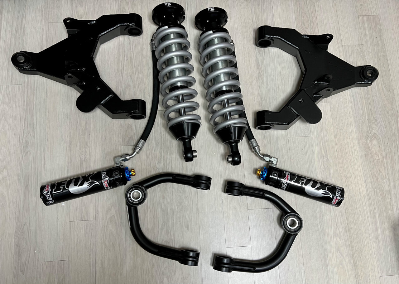

    Suspension parts came in the mail today.
    Both lower and upper control arms had many pits and gouges in them. If I were to guess, this was to insufficient packing (parts hitting each other while in transit). One of the coils was scratched up, too. This definitely wasn't from transit because of the way the coilovers are packed. Fox or Accutune did it and then sent it to me this way.

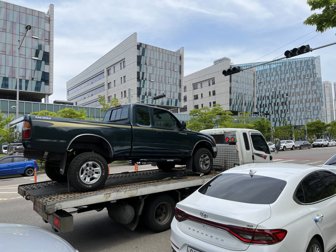

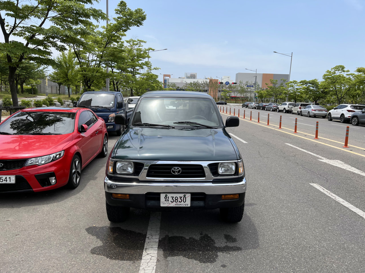

    A couple months back I decided to relocate back to the US and I'm taking the truck with me so on June 2nd, I sent it to Masan Port to get on a RORO ship headed for Freeport, TX.
    All of the parts I purchased never got installed and were sent to the US separately.
    Here it is before taking the trip to Masan. The last time I'll see it in Korea.

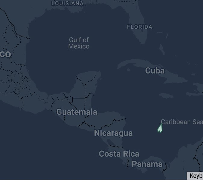

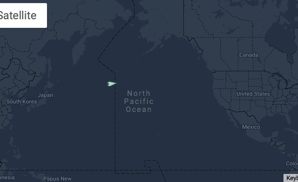

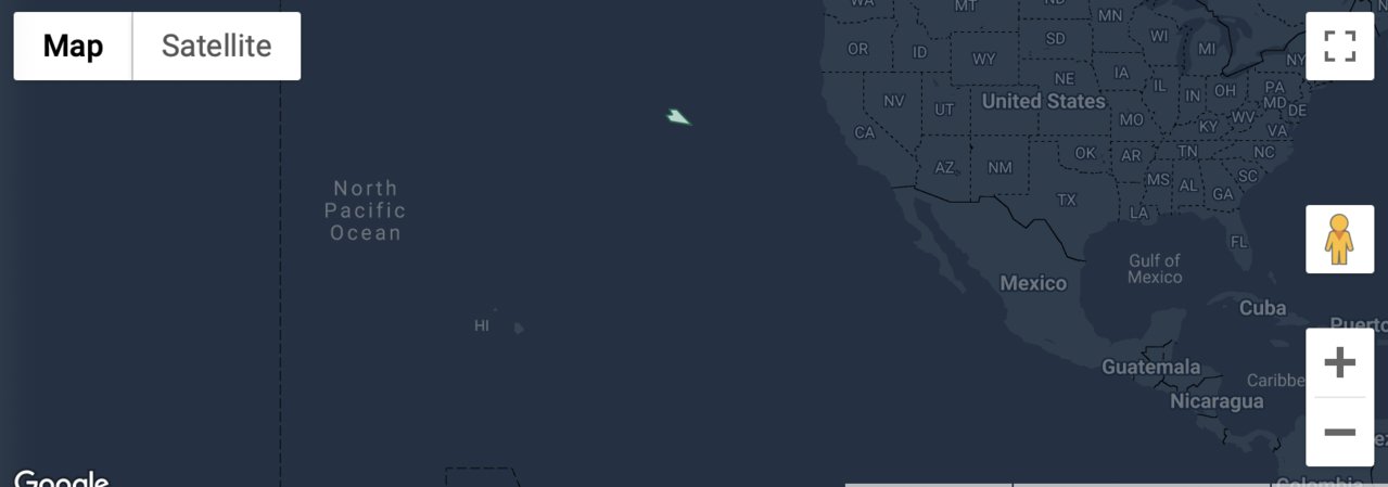

    From Masan, it went to Hiroshima, Kobe and Kawasaki.
    Now it's on it's way to Kingston, Jamaica and then from there, it will go to Freeport!
    Here's where it's at as of today, June 14th.

    Should be in Jamaica by tomorrow morning or earlier. Yesterday, I refreshed my browser so many times to watch it make its way through the Panama Canal.
    I read that the average speed is around 17 knots, which is around 20 mph.
