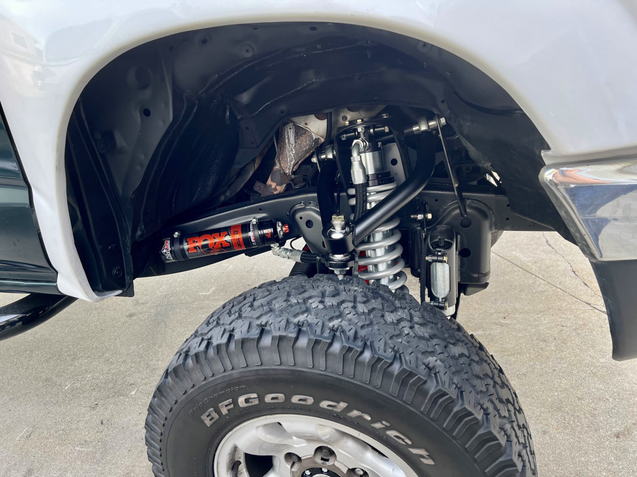

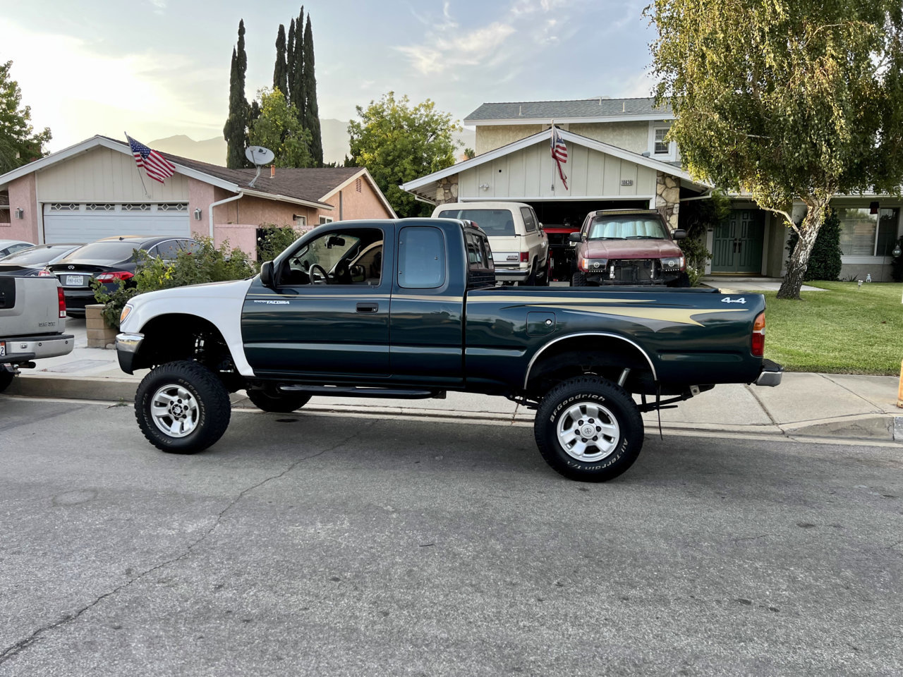

    After waiting a few days in Houston and dealing with a lot of BS from the shipper/broker, I was able to clear customs myself, pay $0 in customs duties/taxes and drive the truck away from the port on Friday, July 15th. There were so many vehicles there but mine was parked right by the office kind of in the most convenient spot possible and right next to two 90's Defenders that were imported from South Africa (they were really nice).

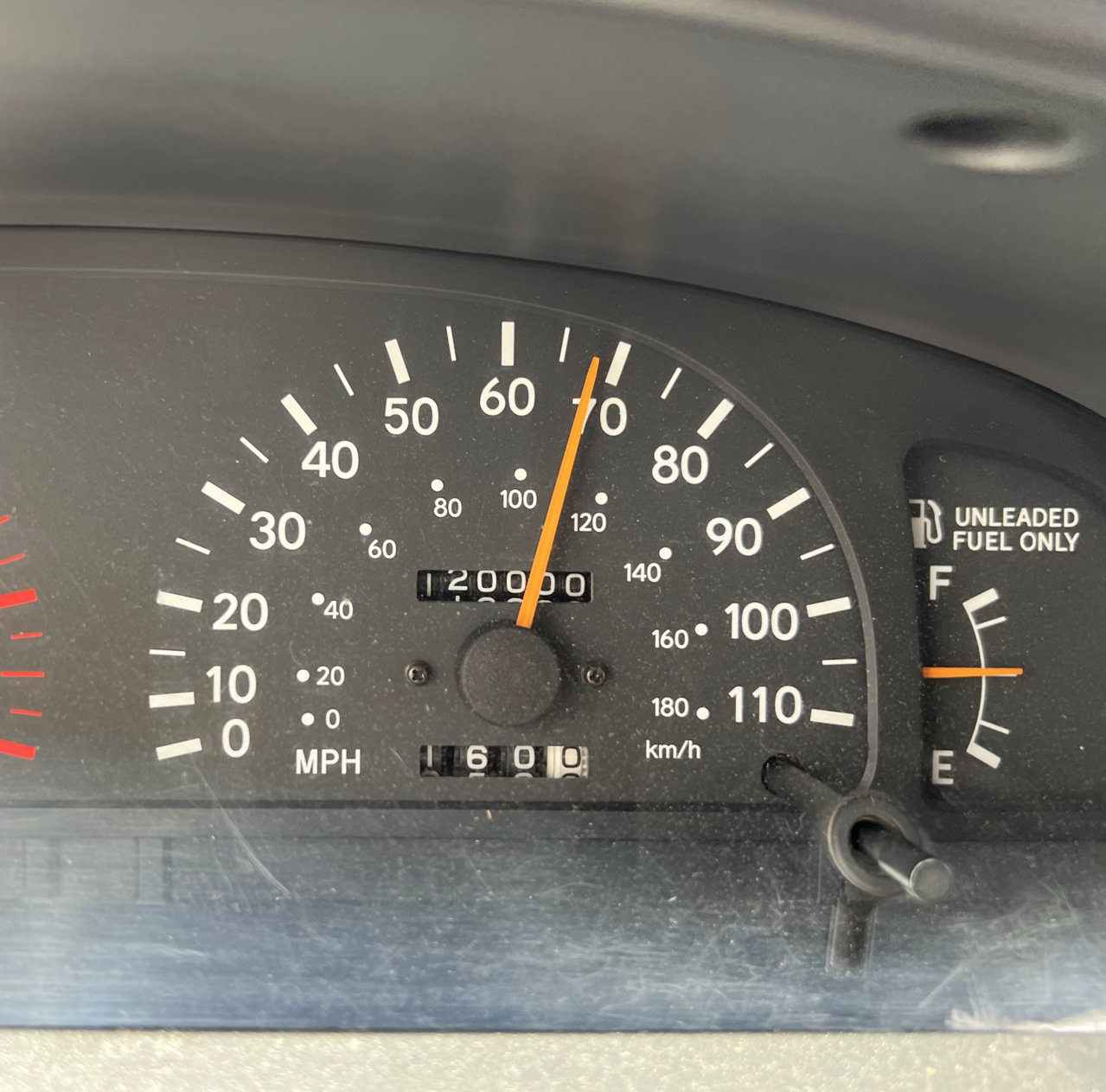

    I immediately started driving it and after a couple hours I hit the 120k milestone and by Friday evening, I made it all the way to Ozana, TX. It was close to 100 degrees outside and that's when I noticed that the temperature needle was going back and forth between normal and RED. That's when I got off the first exit I found (Ozana) and stopped to figure out a plan. I searched all the shops in town and they were all closed but I went to one anyway. Luckily, the two mechanic's numbers were on the door. I called one and explained the situation to him and asked if he knew any private mechanics who could take a look at it now so he gave me a number and the man said to come right over. He was a nice guy and we flushed the coolant and filled it back up with some new Peak stuff we got at a gas station. I was so exhausted from everything that I ended up sticking around the guys house and drinking and talking until 3 in the morning. I also learned that my mechanic believes that the earth is flat and has seen UFOs before. I learned many interesting things about Ozana and it's safe to say that I won't be back for a visit.
    By Saturday evening, I made it all the way to Florence, Arizona. I had originally intended on meeting the owner of the Jeep TJ forum but for whatever reason he was unresponsive so I just grabbed a motel, had some terrible tacos and margaritas, and went to sleep.

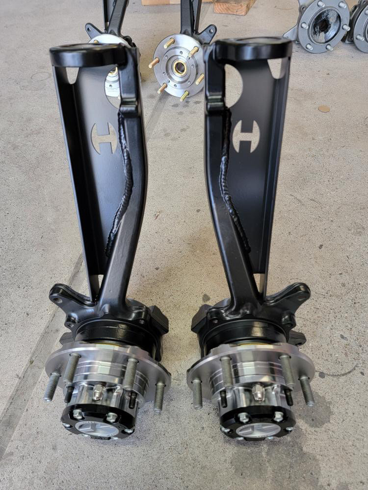

    Sunday afternoon, I made it to Vegas, where I met Javier, the spindle guy (Heavy Friction Works - on Instagram) to pick up my spindles with new hubs and dials. These things turned out amazing. Pictures don't really do them justice. He really puts in a lot of time and does quality work. That said, they aren't cheap. Mine was actually the first set that he used powder coating on. All previous sets are Steel-It. Upon my arrival, he was even nice enough to press in my UCA slugs for me which is ultimately going to save time on my install. I then visited the Gold & Silver pawn shop from the show Pawn Stars and bought a Roman coin that I'll give to my father-in-law later, probably for Christmas. The rest of the night was spent at a bar in MGM Grand and then I gambled for the first time in my life on some stupid machines. It took me about 30 minutes to lose $60.

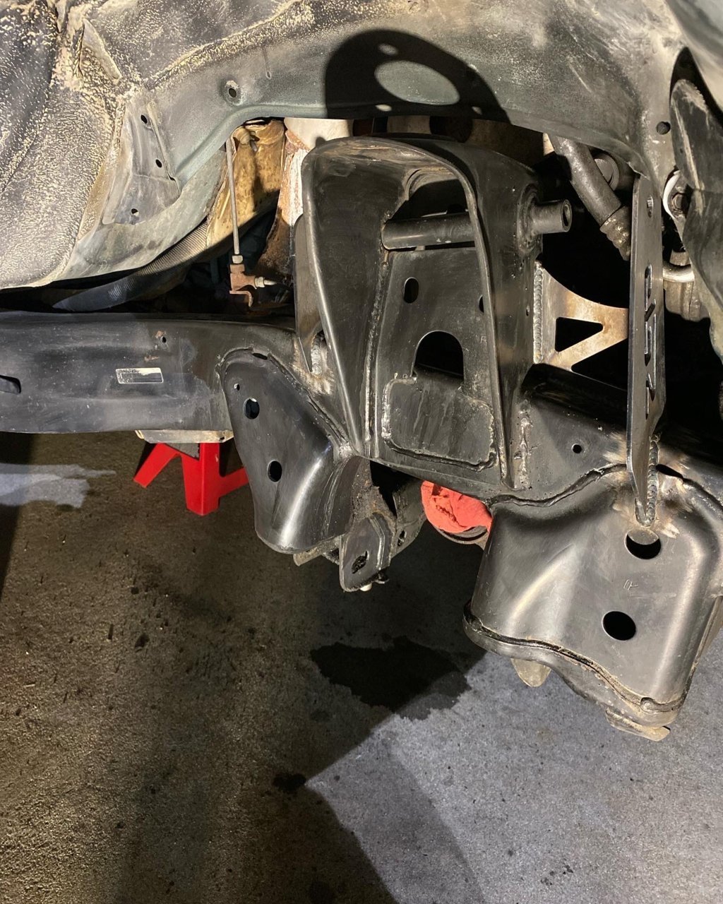

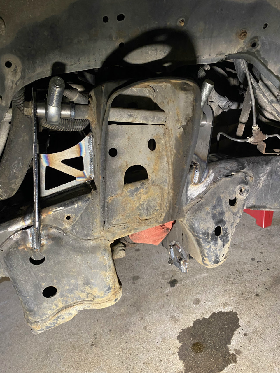

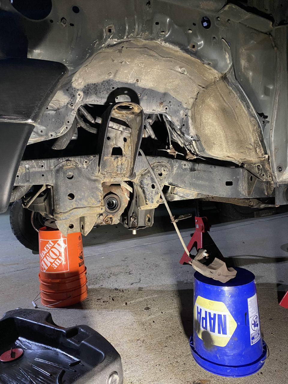

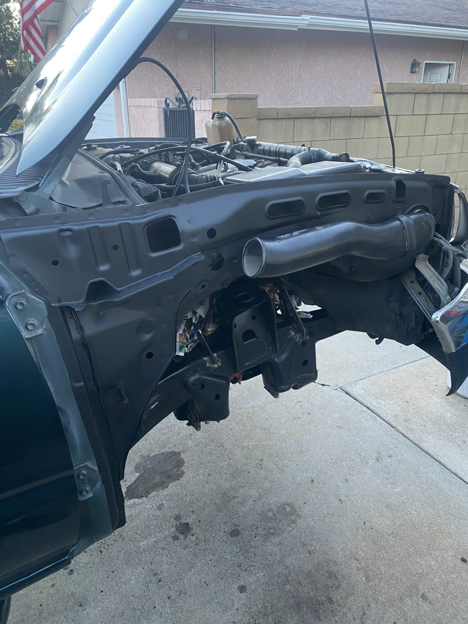

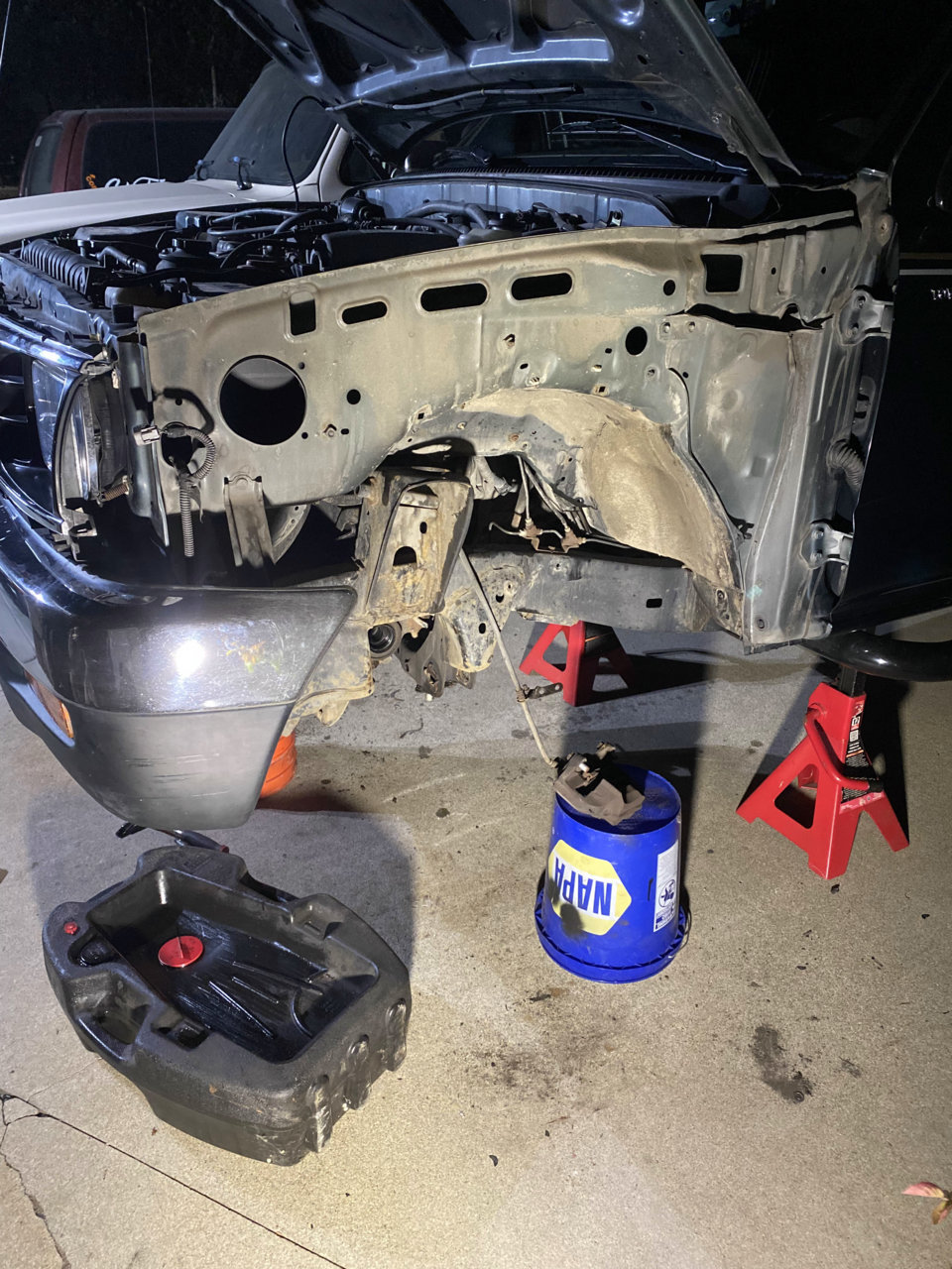

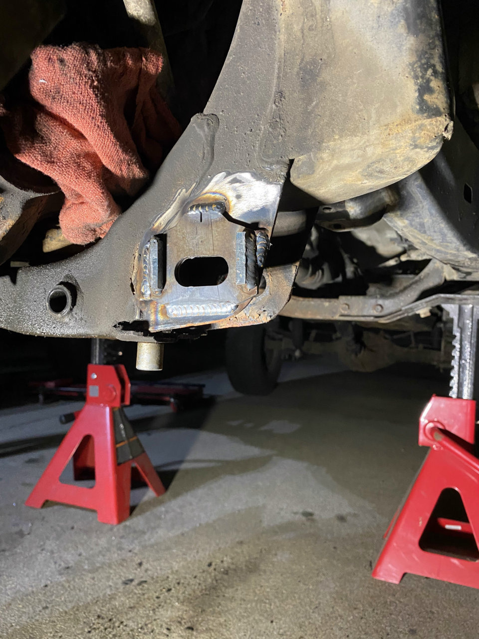

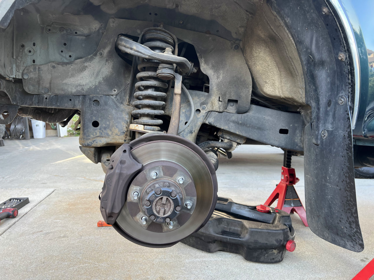

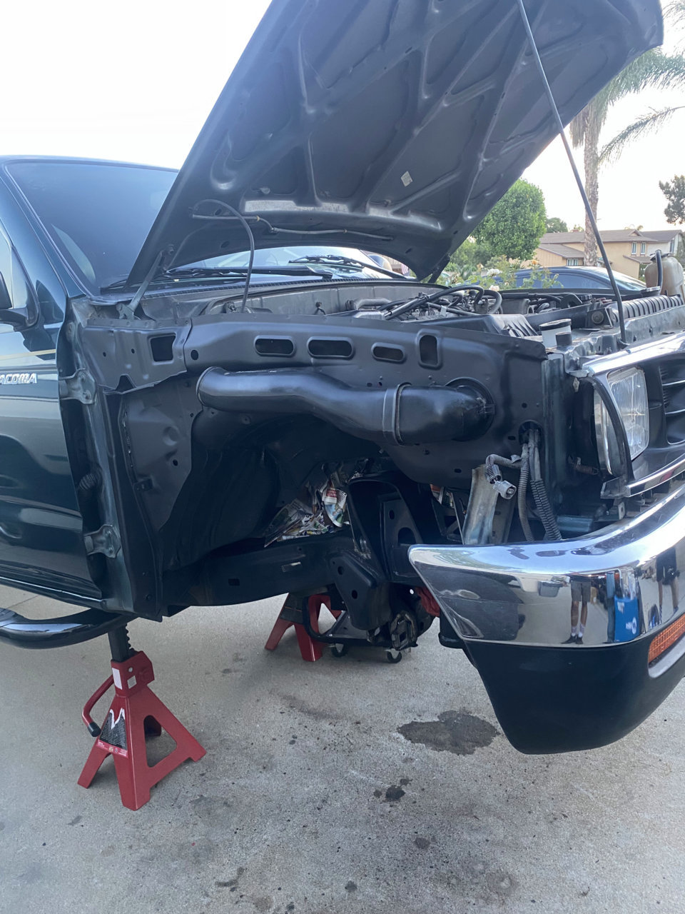

    It appears that every single part on my front end is original. (except for rotors and pads and maybe the struts, but those might be, too)
    Monday around 6 PM. This can serve as a before pic.
    After the strip down, probably around 9 PM.

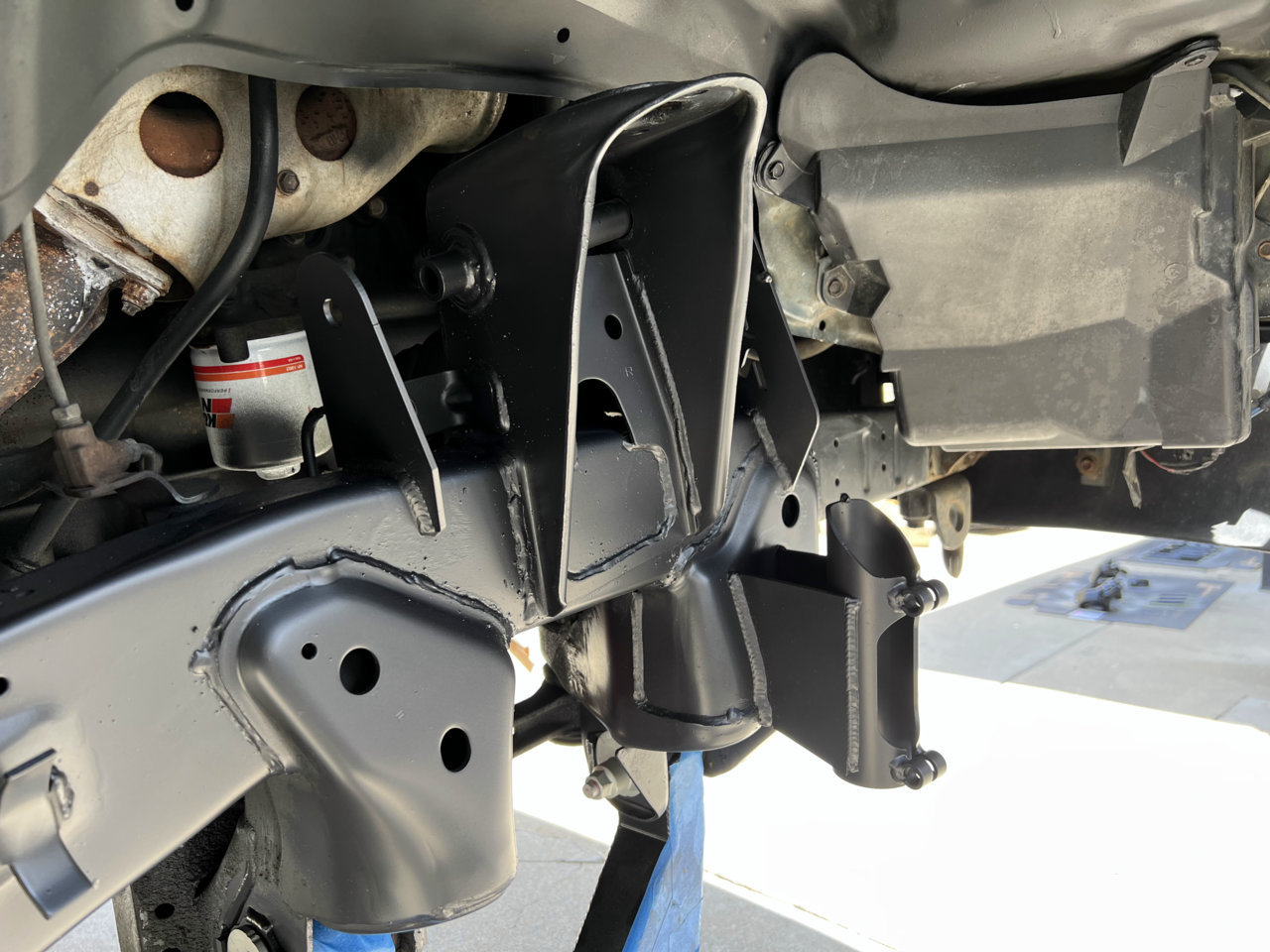

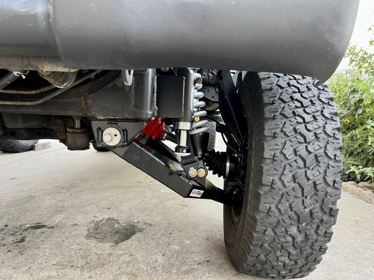

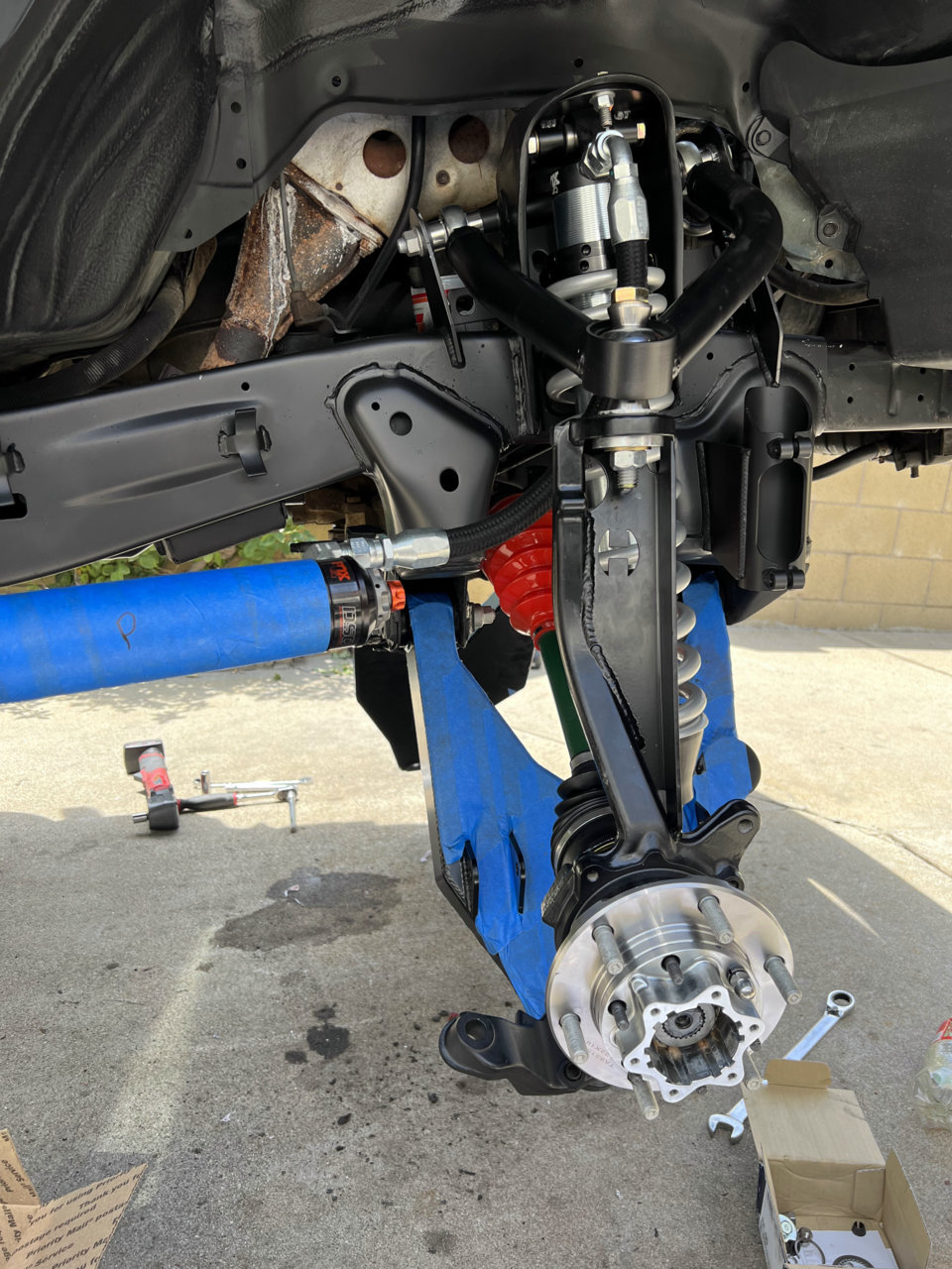

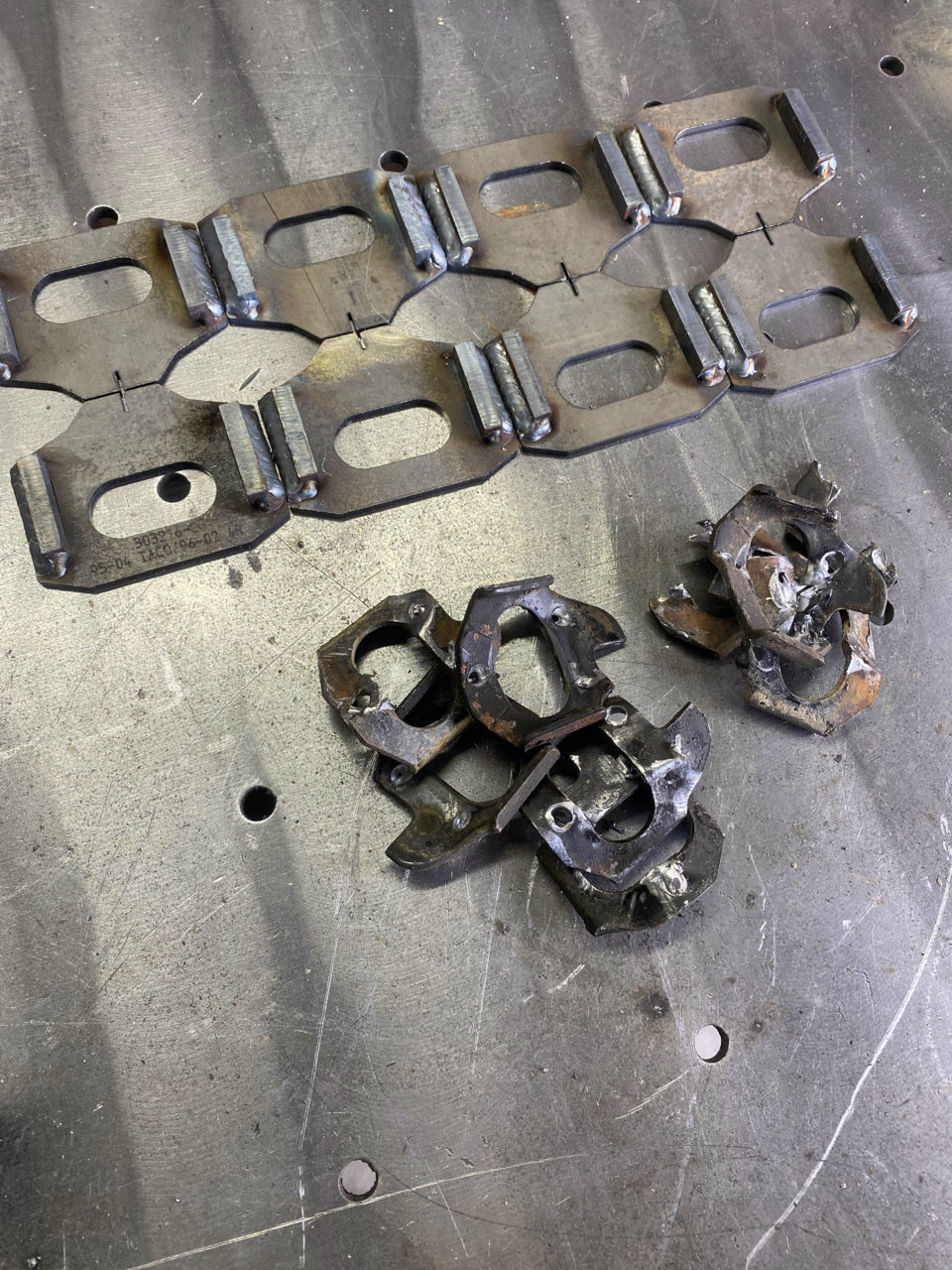

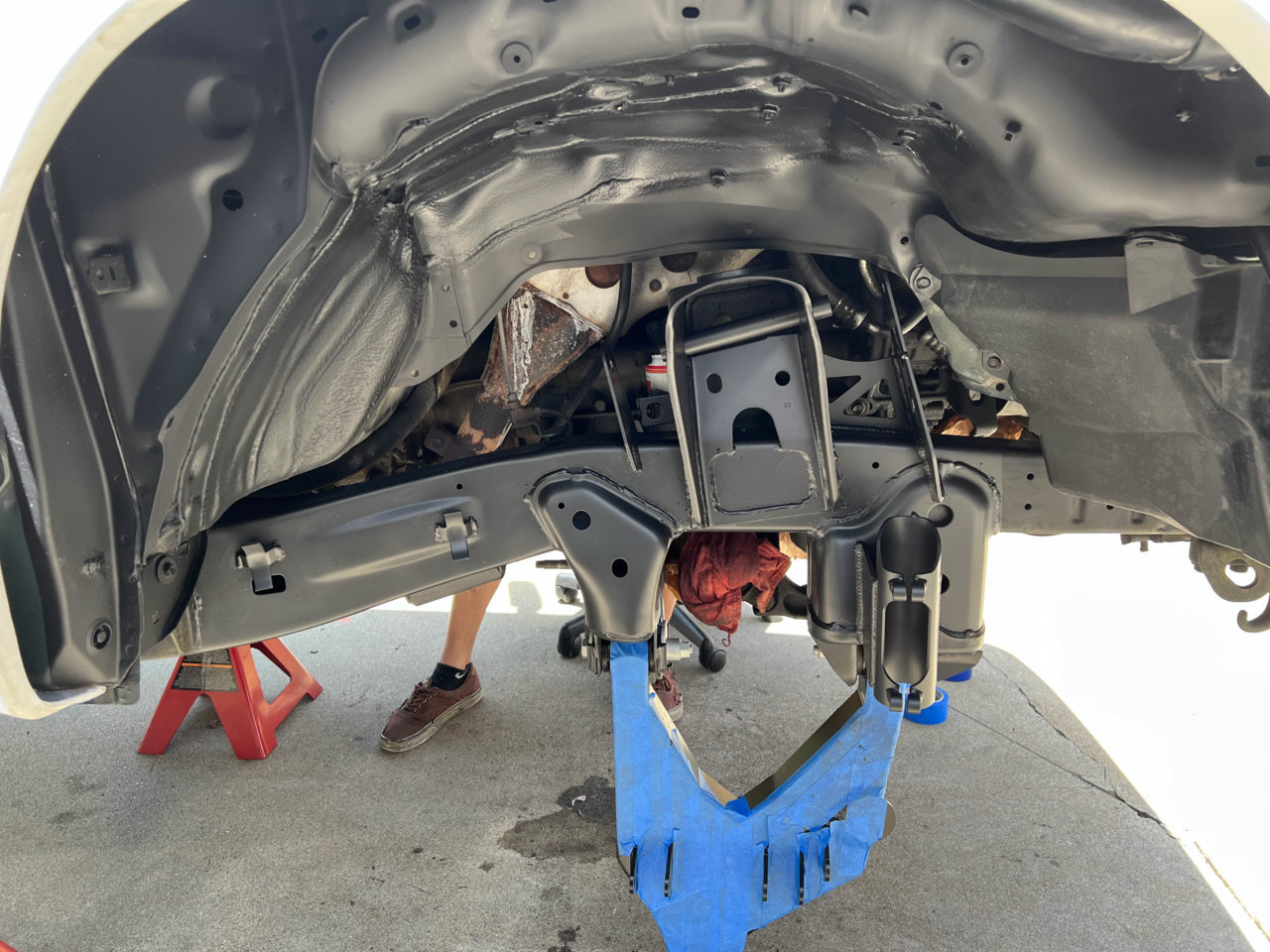

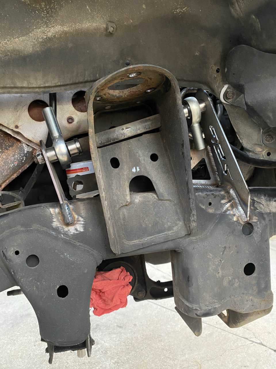

    By Tuesday, most of my parts (minus LCAs and brake lines) had been dropped off to my installer.
    All-Pro cam tab gussets welded on
    Solo W.I.Y. UCA double-shear kit welded on
    Frame cleaned up a little bit
    Bandido likes this.
  9. Jul 20, 2022 at 10:22 PM
    #49
    CharlieTaco
    CharlieTaco [OP] '95 long travel - Korea to Kentucky
    Jul 9, 2021
    #370807
    94
    Charlie
    Lexington, Kentucky
    95 Tacoma Xtra Cab 2.7 L 4X4
    Solo Motorsports LT & UCA double-shear Fox Factory Series 2.5X8" coilovers and hydro bumps Anonymous Fab uniball-converted LBJs Heavy Friction Works gusseted spindles All-Pro cam tab gussets Advanced Fiberglass 3.5" fenders OME Dakar leaf pack and OME bushings OME greaseable Tundra shackles Bilstein 5125 10" stroke in factory location BFG KO2 33X10.50R15 Husky front floor liners ACC carpet - Oak color '01-'04 style side-view mirrors black door handles Hella H4 E-Code headlight housings/Philips X-treme Vision H4 bulbs BH3D Printing double cup holder Siless sound deadening 72 sq ft Noico Red 72 sq ft Custom stereo - removed

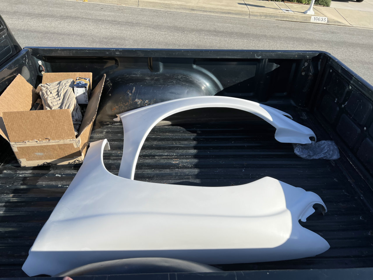

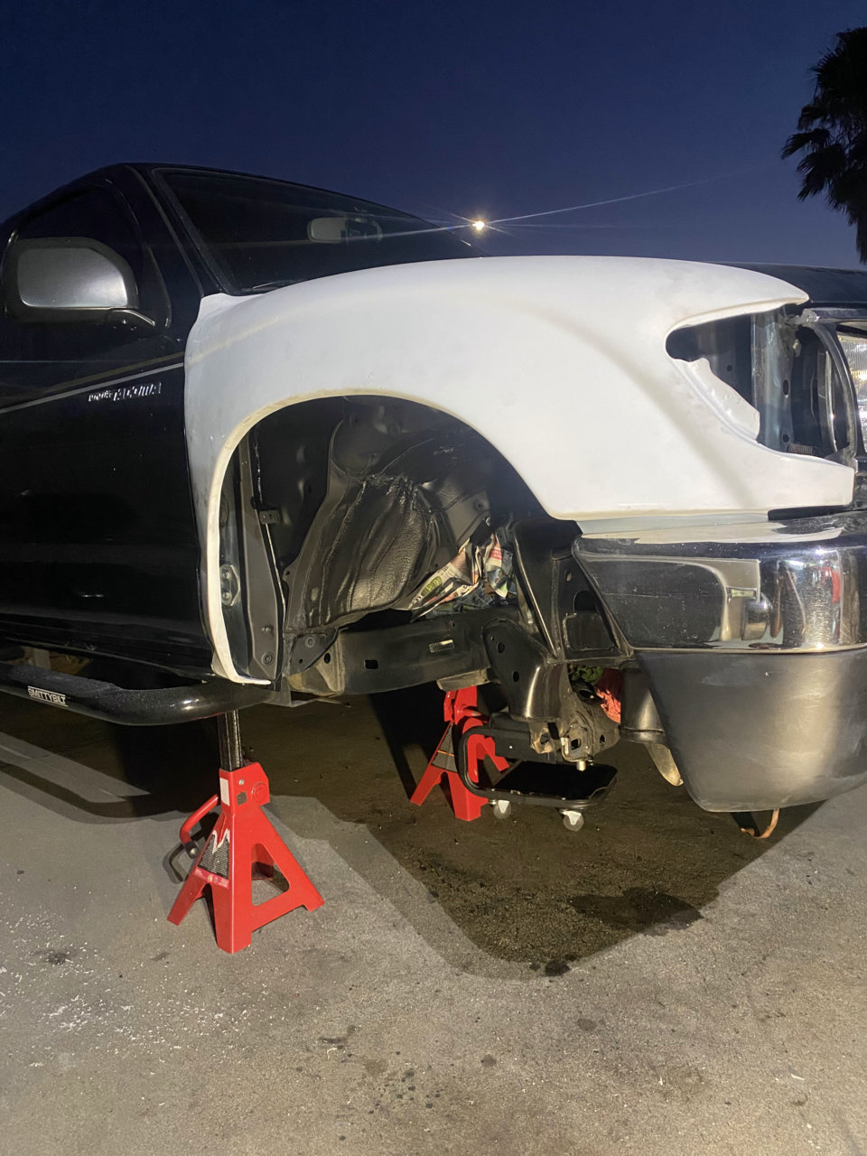

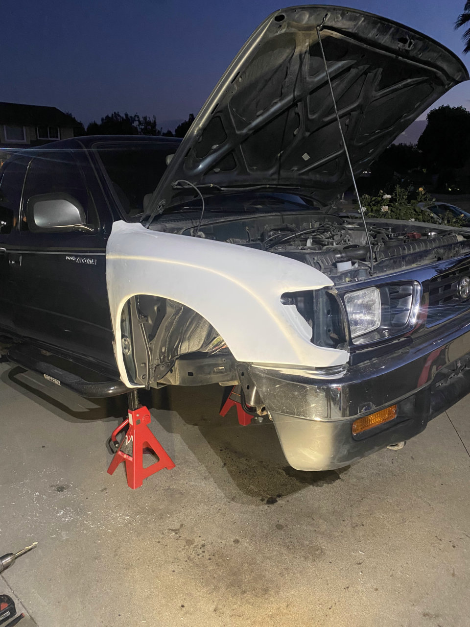

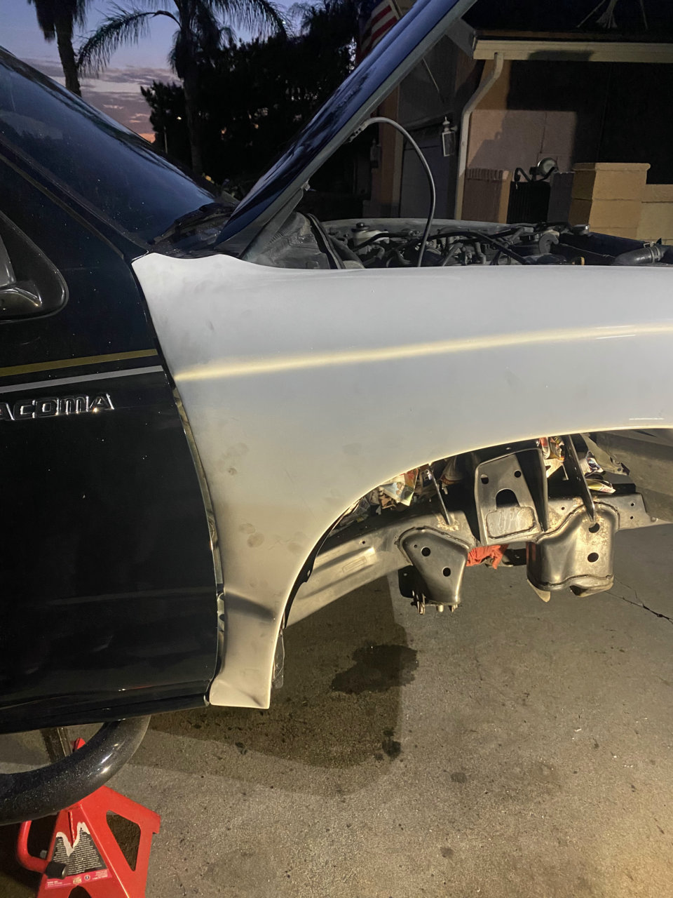

    Day 3
    painted
    Advanced Fiberglass fenders fitted up mostly. (probably have to get some body shop work done later before painting)
    Bandido likes this.
  10. Jul 23, 2022 at 1:17 PM
    #50
    CharlieTaco
    Jul 9, 2021
    #370807
    94
    Charlie
    Lexington, Kentucky

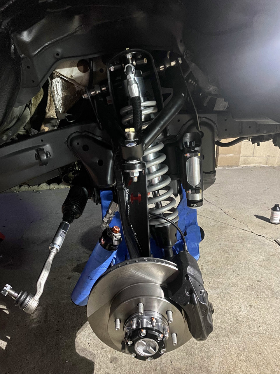

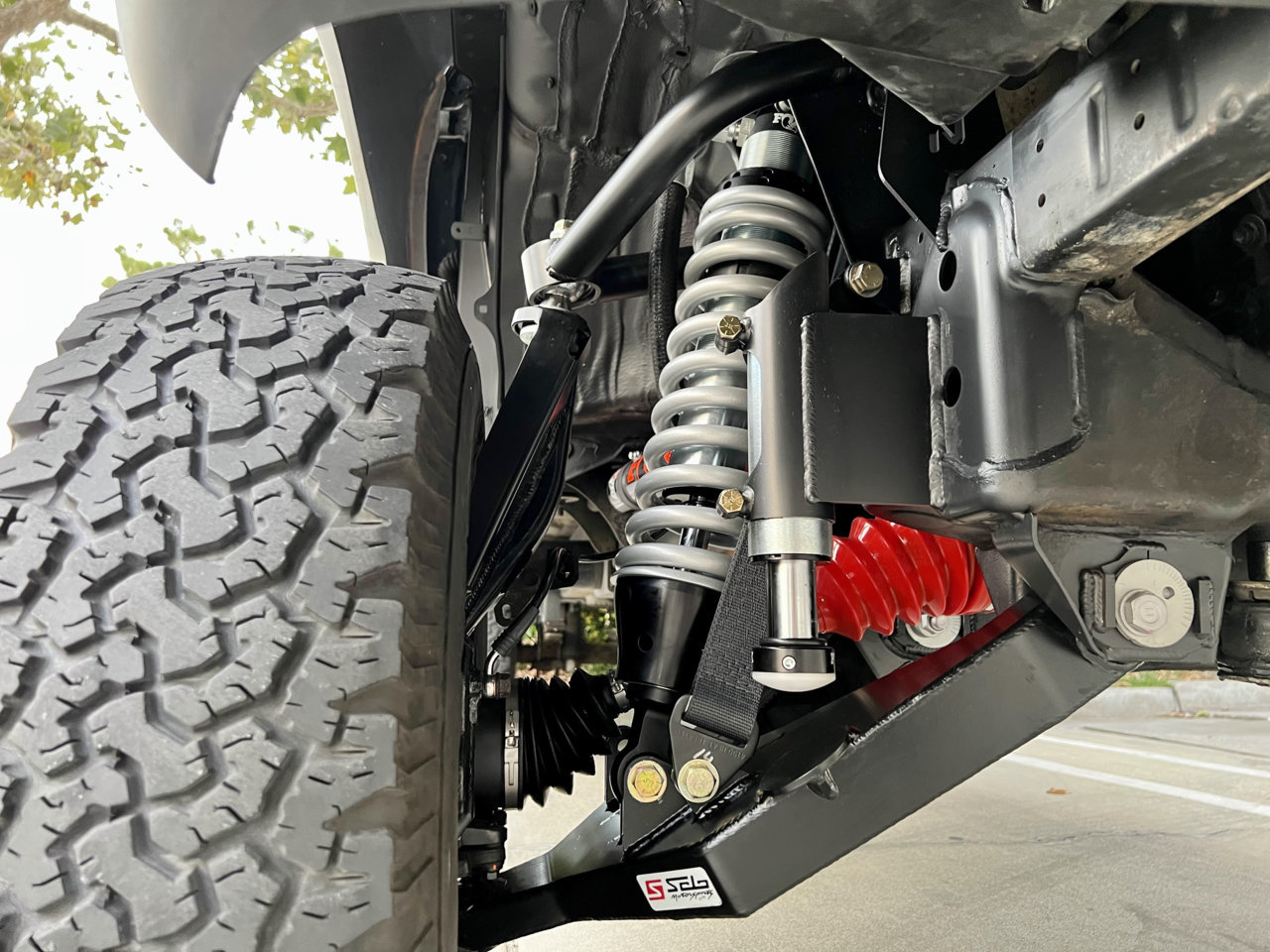

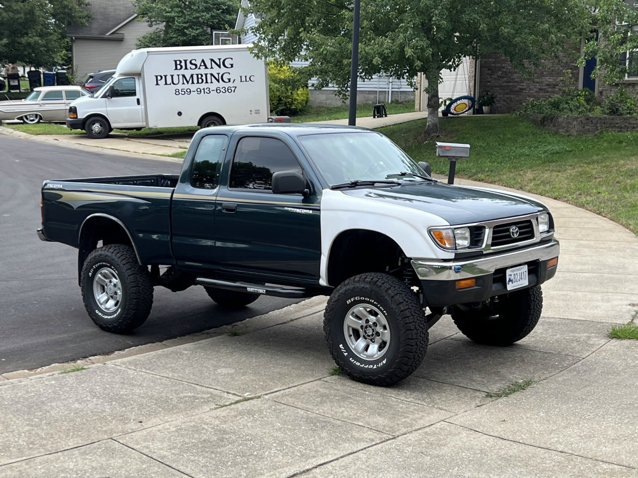

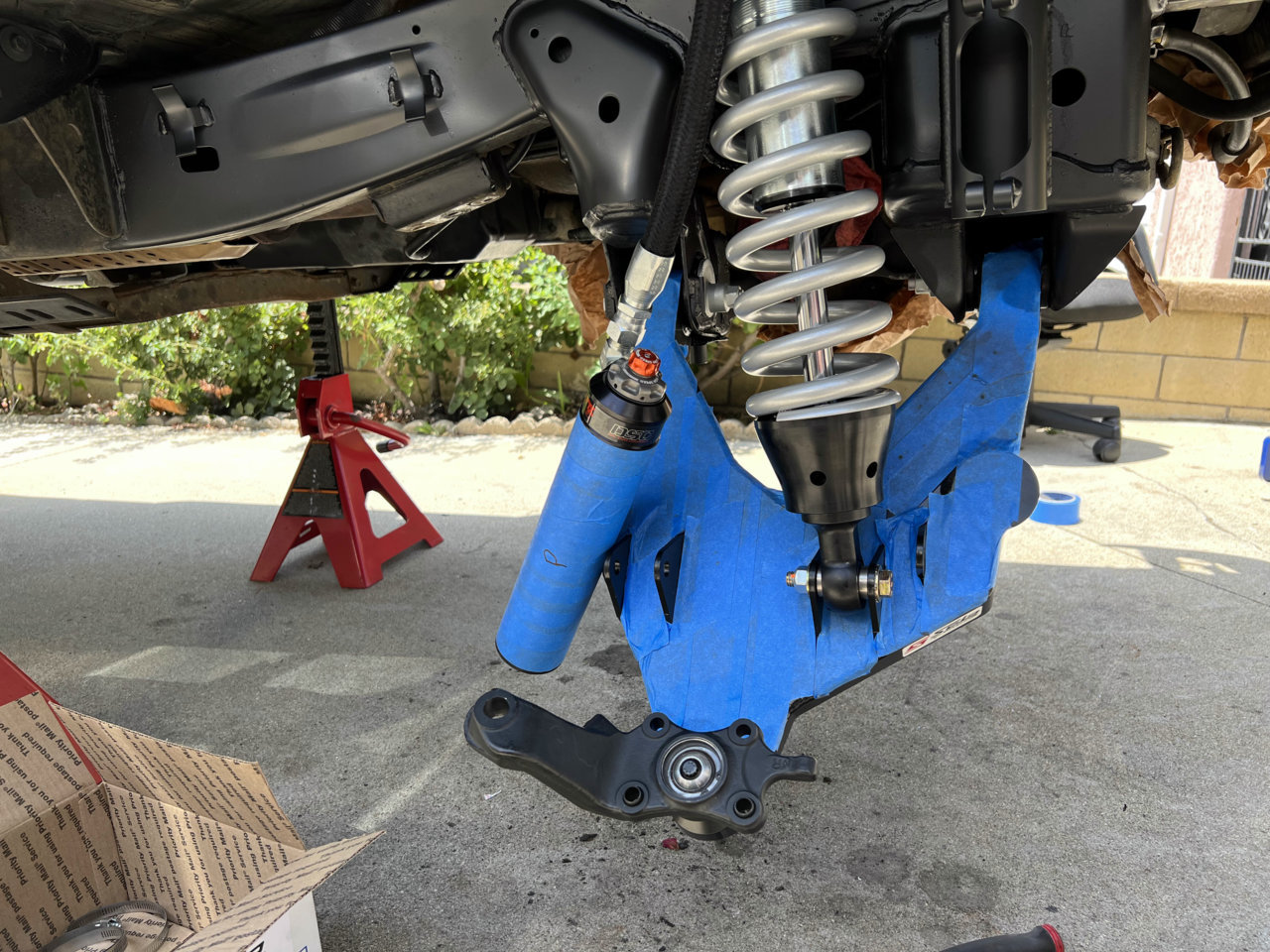

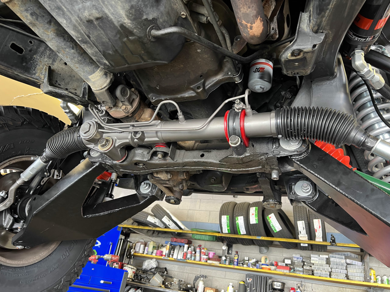

    Day 4 & 5 updates (July 21/22, 2022)
    B.A.M.F. BPV relocation bracket installed finally. Set at 4" of lift. When I originally lifted the rear in Summer 2021, I measured 6" but it's been about a year. Hopefully this setting turns out to be about right.
    Wheelers extended stainless rear brake line installed
    As of now, on both sides of the truck:
    All-Pro cam tab gussets, bump sleeves, reservoir tabs, Solo UCA double-shear all welded on
    Wheel wells have been cleaned and painted in Rustoleum flat black
    Front portion of frame/coil buckets cleaned up and painted in Steel-It
    Heavy Friction Works gusseted and powder-coated spindles installed (with new DuraGo hubs, extended lugs, ASIAN hub dials)
    CVJ 3.5" long travel axles for manual hubs installed
    Anonymous Fabrication uniball-converted lower ball joints installed
    Fox coilovers in, Fox bumps in
    Control arms in
    Brake calipers sand blasted and painted, new NAPA rotors and pads
    Still left to do:
    driver's side fiberglass
    diff drop? maybe.
    limit straps
    durobumps diff bushings
    bleed brakes
    bleed steering, steering lines
    resi hose adjustment
    new tires and alignment
    remove shittybuilt side steps?
    remove lower portion of front bumper and wire parking lights to turn signals?
    go home

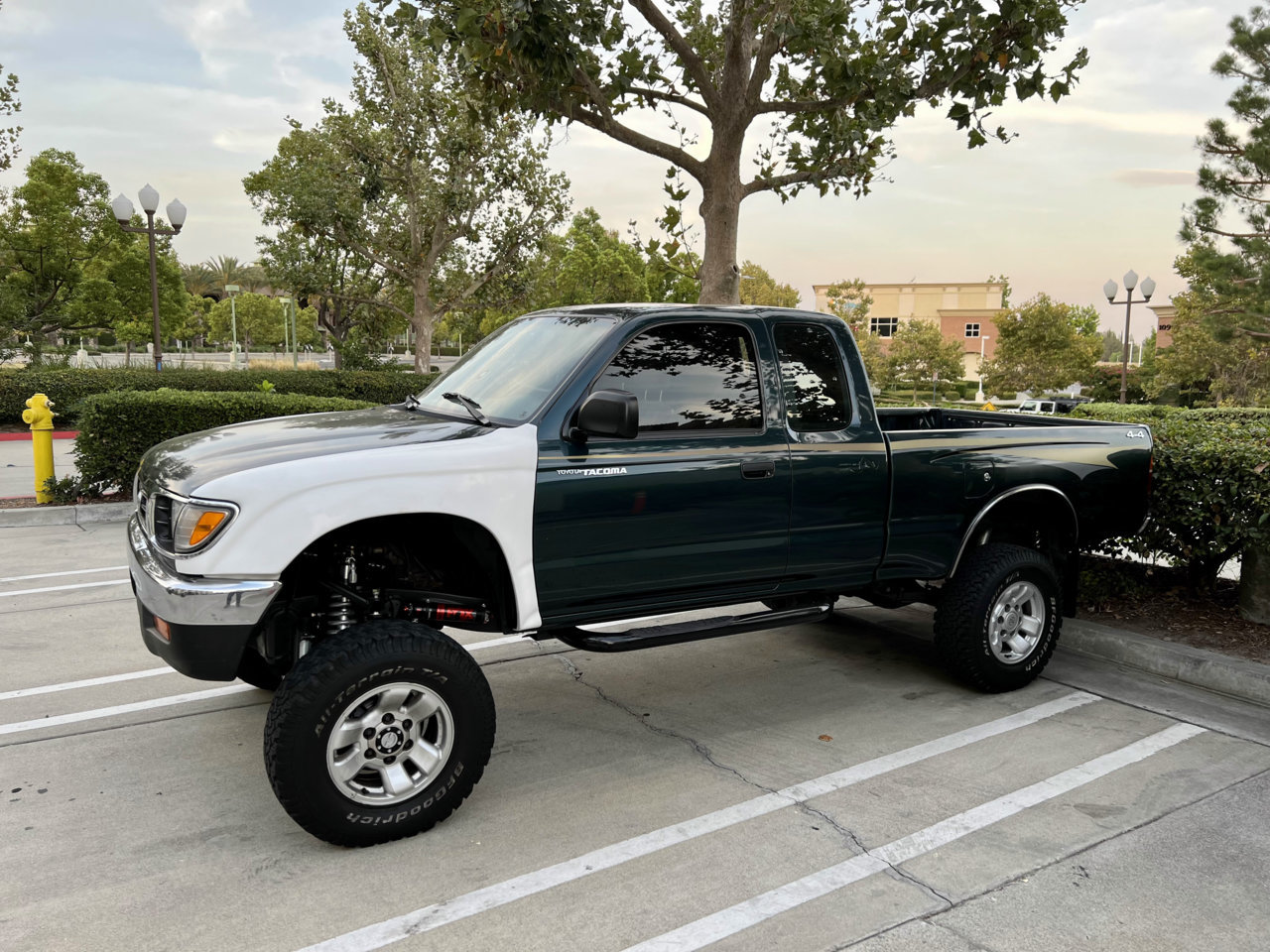

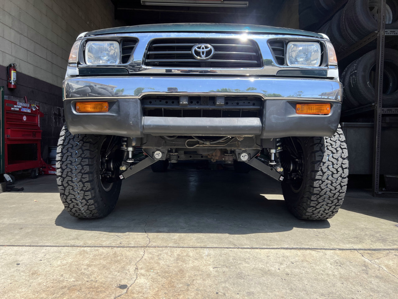

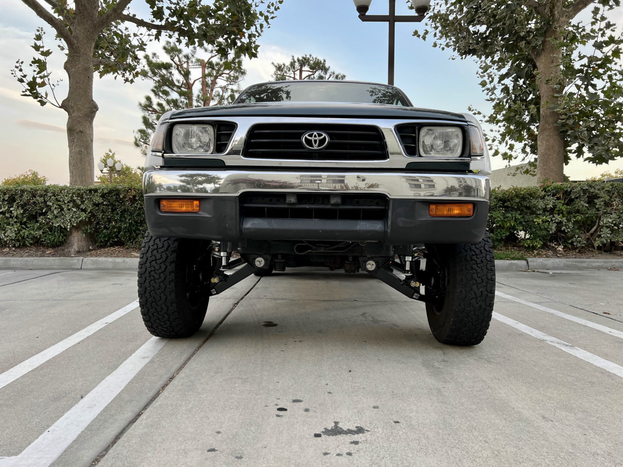

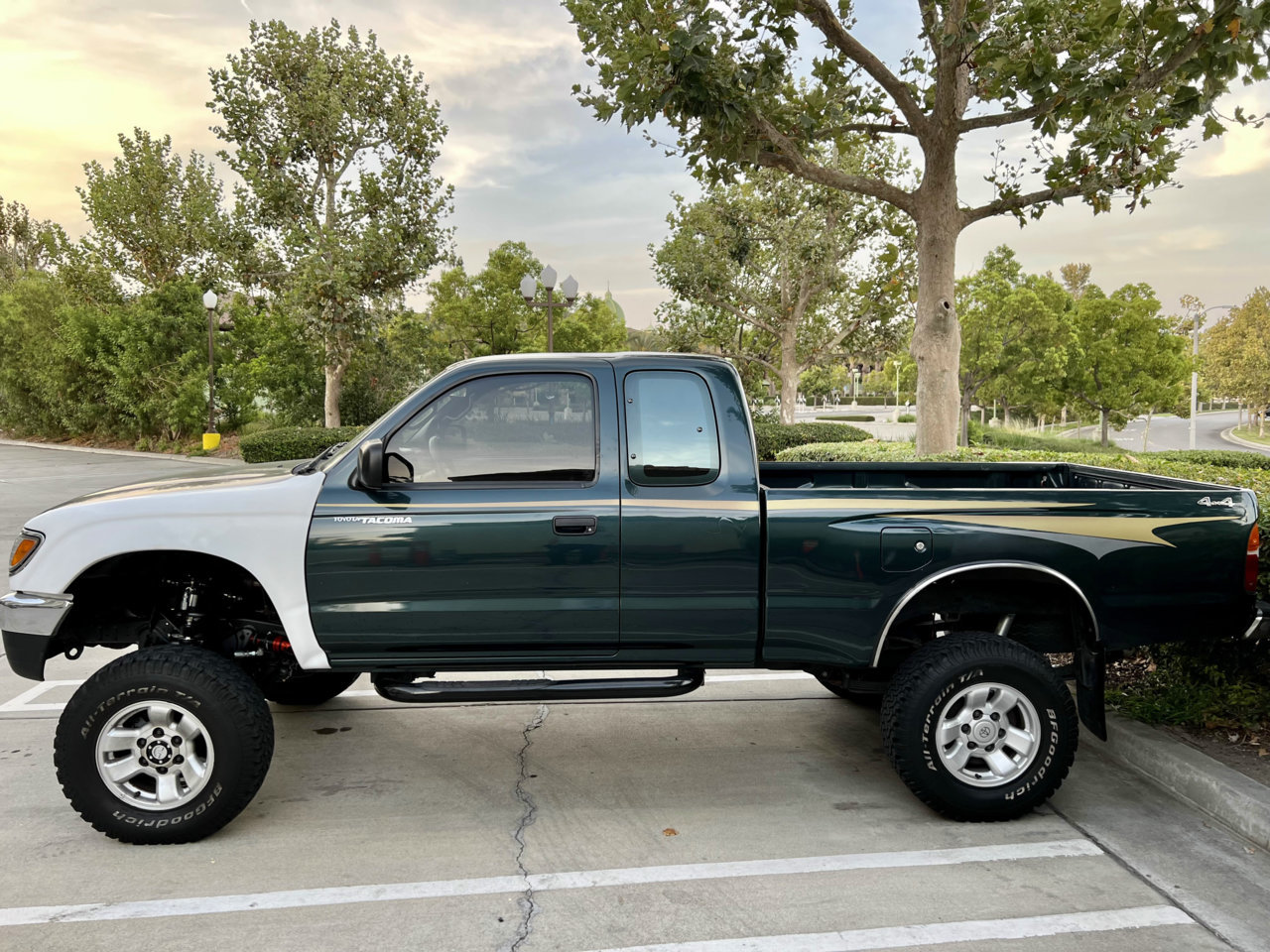

    Day 7 - 6/24/2022

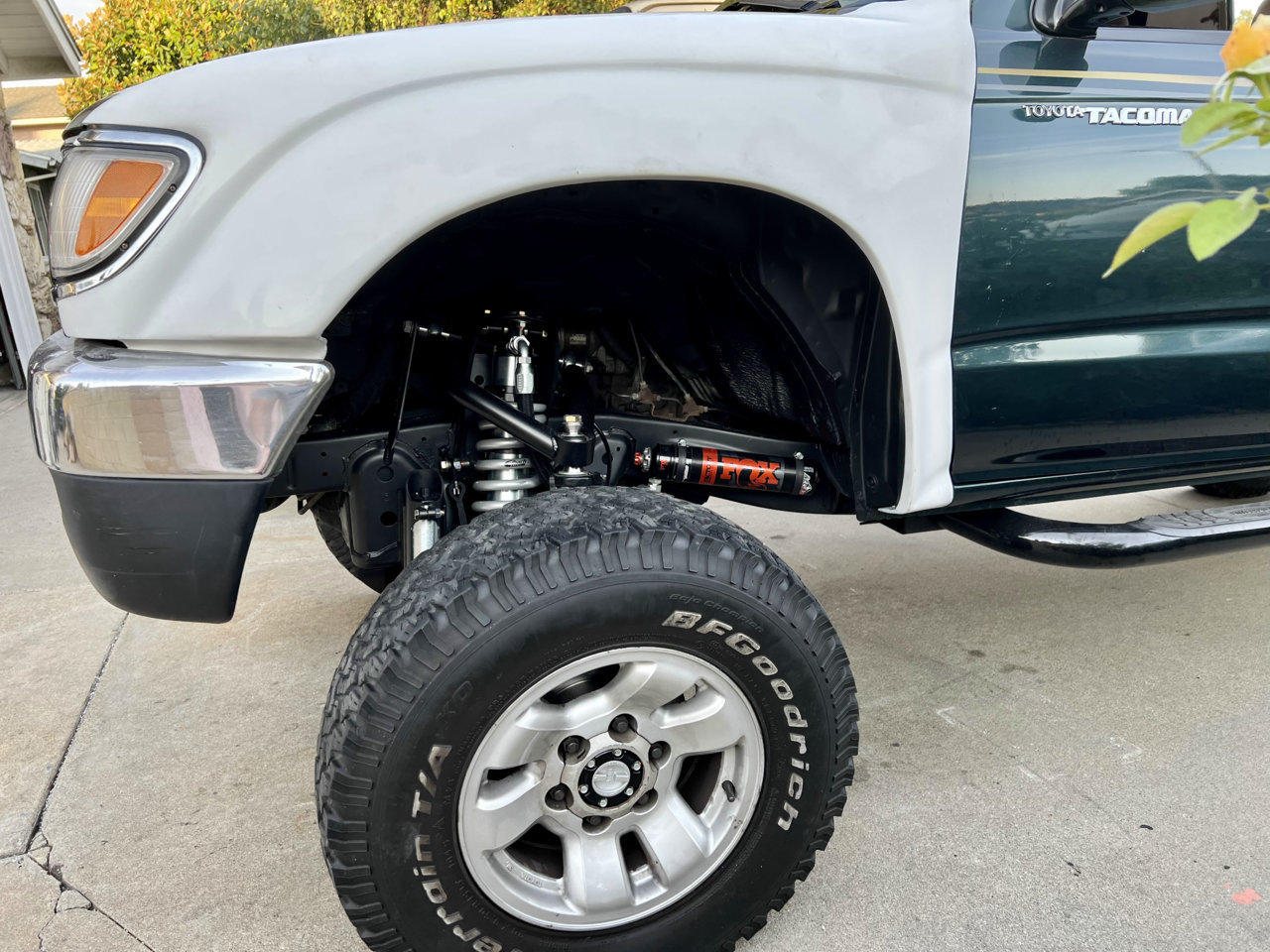

    I went to pick up the truck today and it's made quite the transformation.
    It's scary as hell to drive right now. So I just drove it a few miles to my hotel. First thing in the morning, it's going to get 33" KO2s mounted in place of these old 30" KOs and then off to get an alignment. Then back to KY! I miss home and this trip ended up costing more than I expected, as it usually does.

    good lord, lower the preload too. You are like maxed on down travel. Probably rides like shit. You want the CV axles to be almost level, a bit angled down. You want to try and split you up and down travel at ride height so that your suspension can cope with a bit bump or a big hole.
    I don' t have the best close up but this will give you an idea.
    [​IMG]DeTour-32.jpg by Monte Nickles Photos, on Flickr
    Do not get it aligned with it that high. you'll be wasting your money. Lower it first.

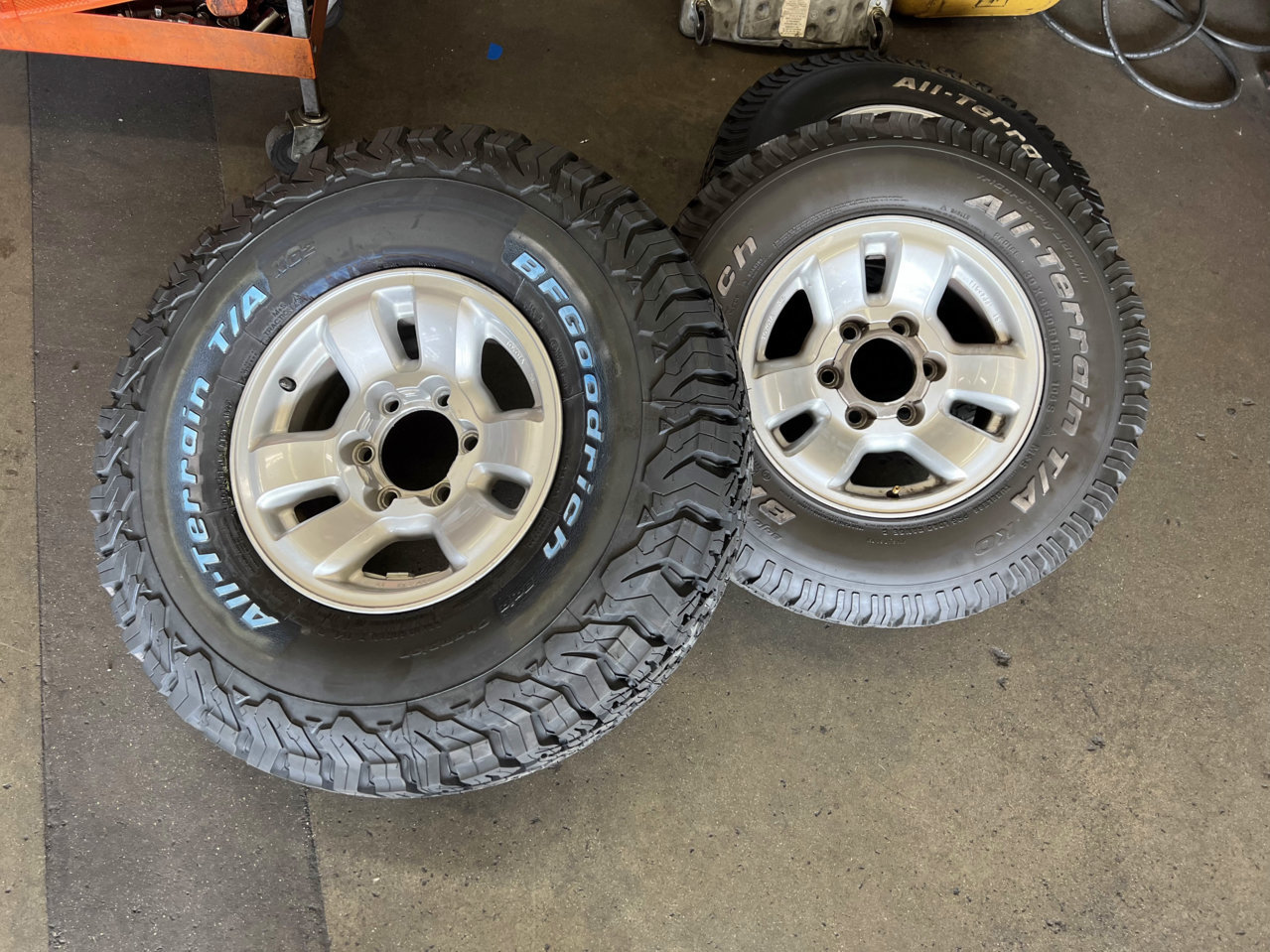

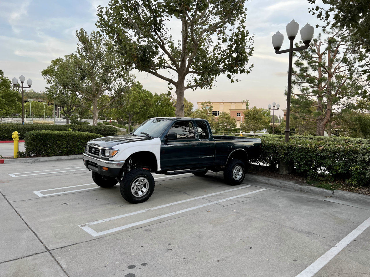

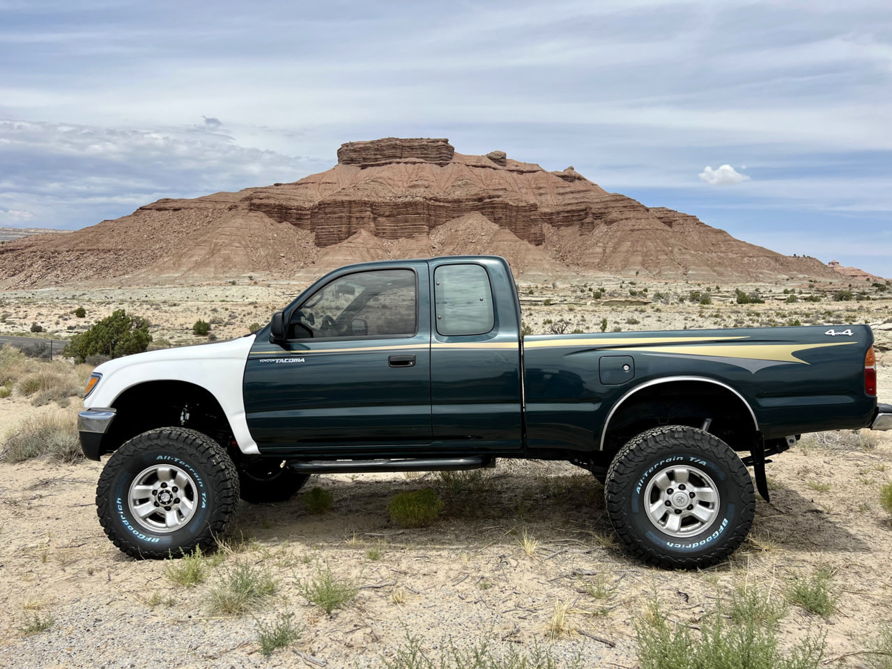

    7/26/2022
    five new tires - BFG KO2s 33X10.50R15
    (previously BFG KO 30X9.50R15)
    and a couple pics I took in Utah on the drive back from So Cal to KY.

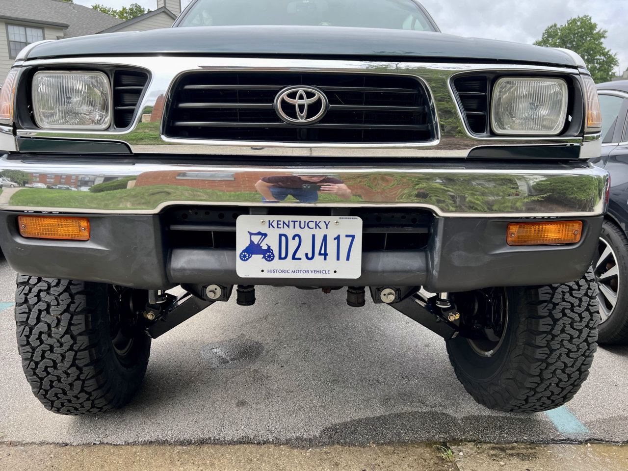

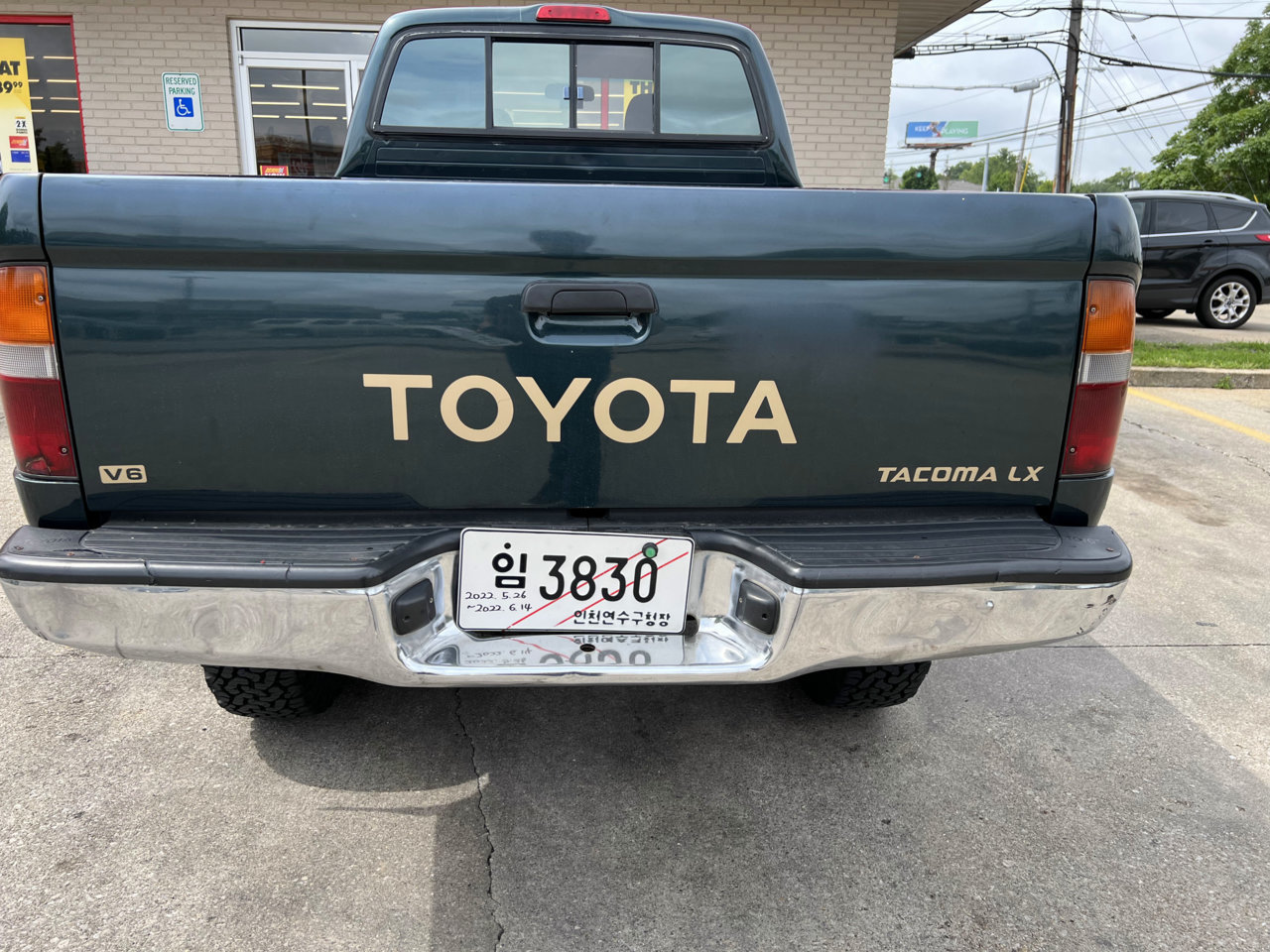

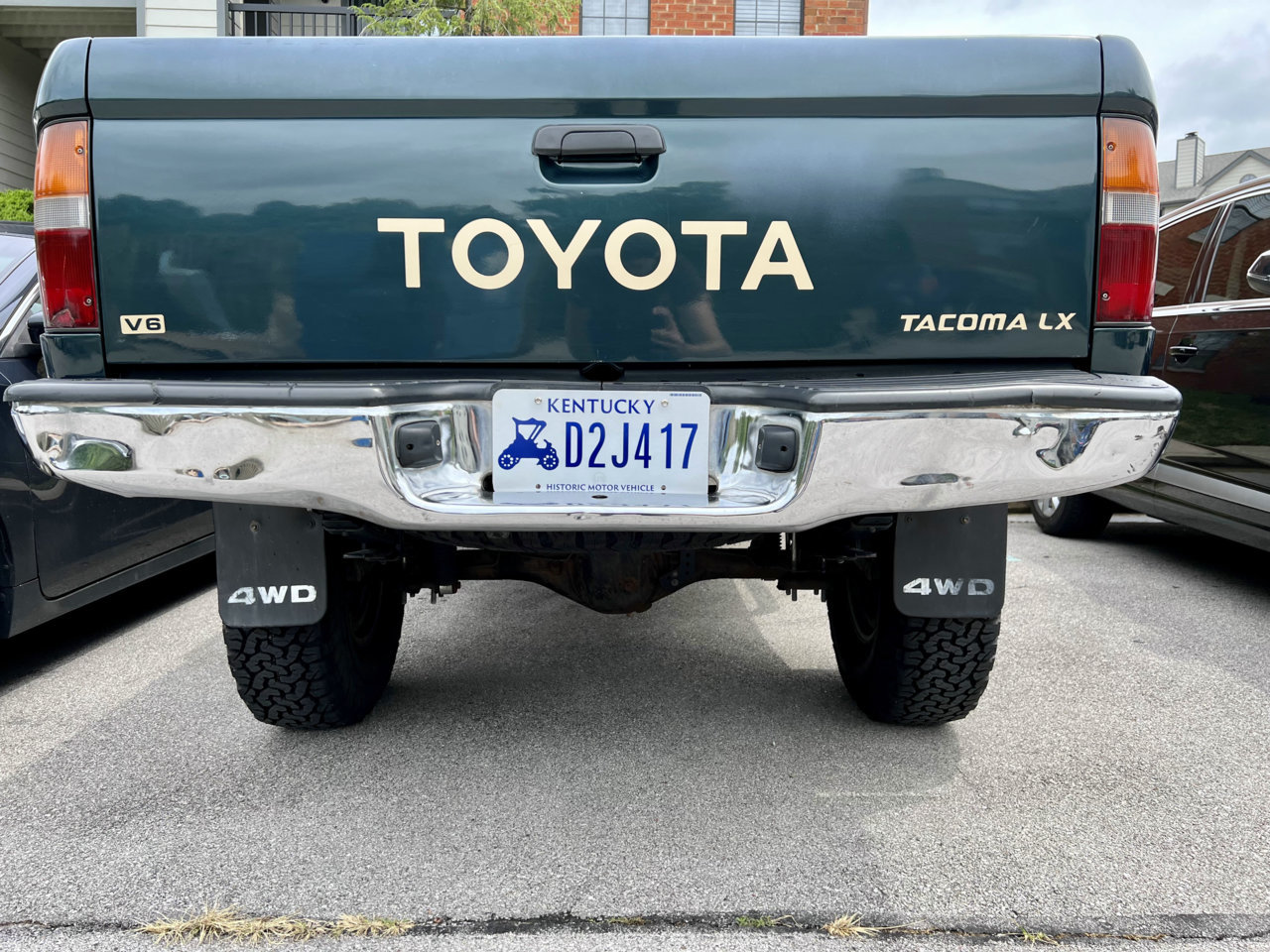

    7/28/2022 - arrived home in KY!
    7/29/2022 - titled/registered and plated in KY - got historic plates!
    new wipers put on - 17" RainX Advantedge
    now over 124k miles on the odometer. I put ~4,200 miles on the truck in 2 weeks :(
    Here is the Korean temporary plate I was issued before importing the truck. The DMV in Korea took both original plates :( At least I got to keep one of the temporary plates as a souvenir.
    New plates
    Before/After

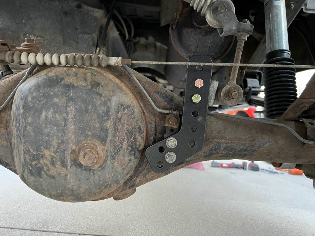

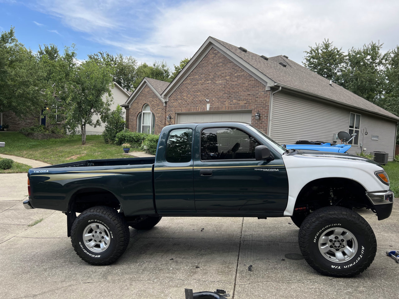

    8/21/2022

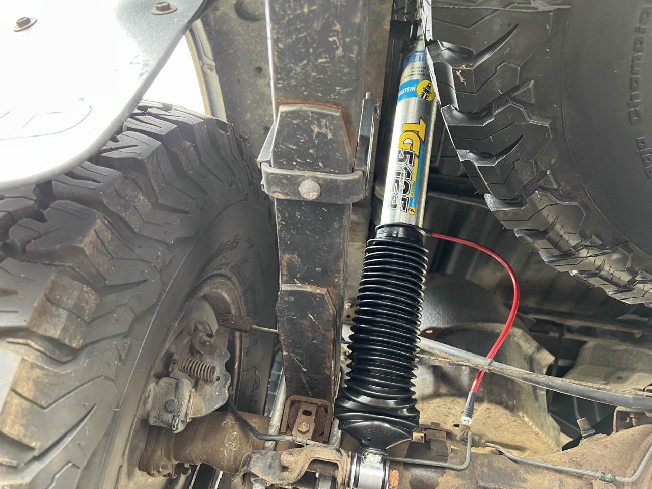

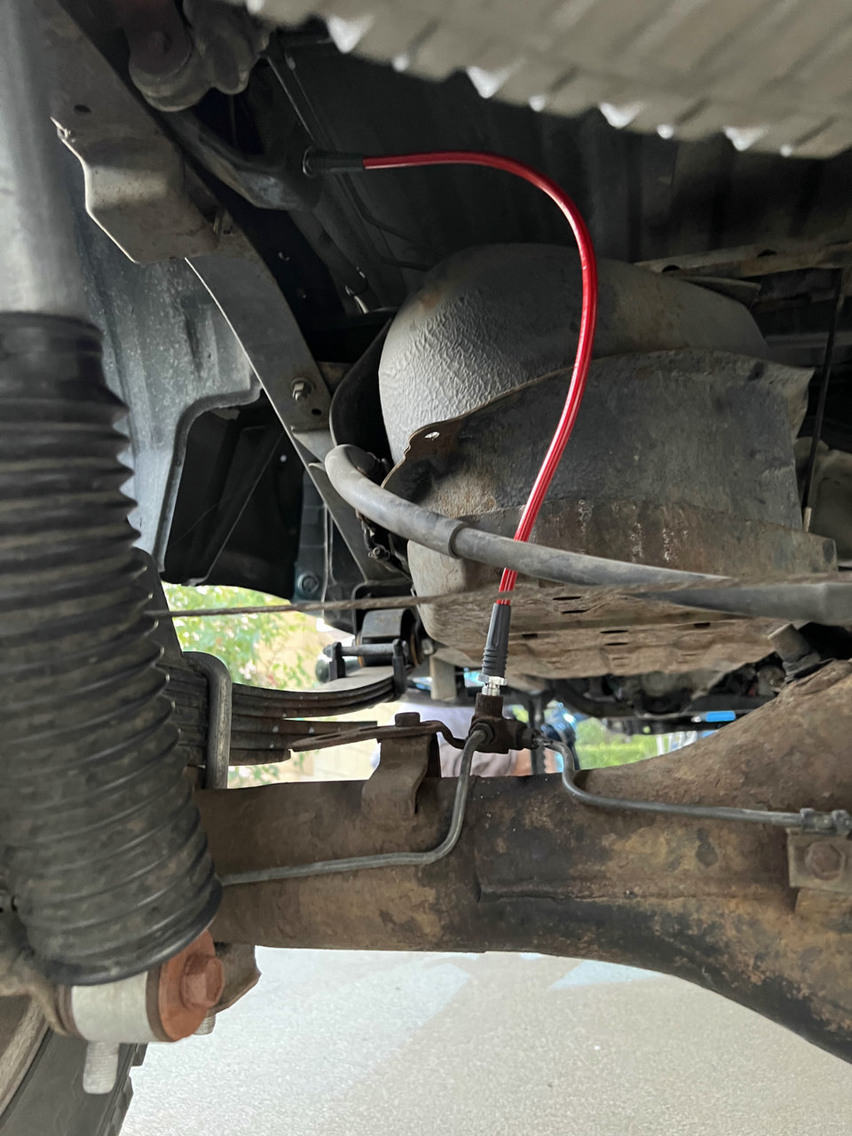

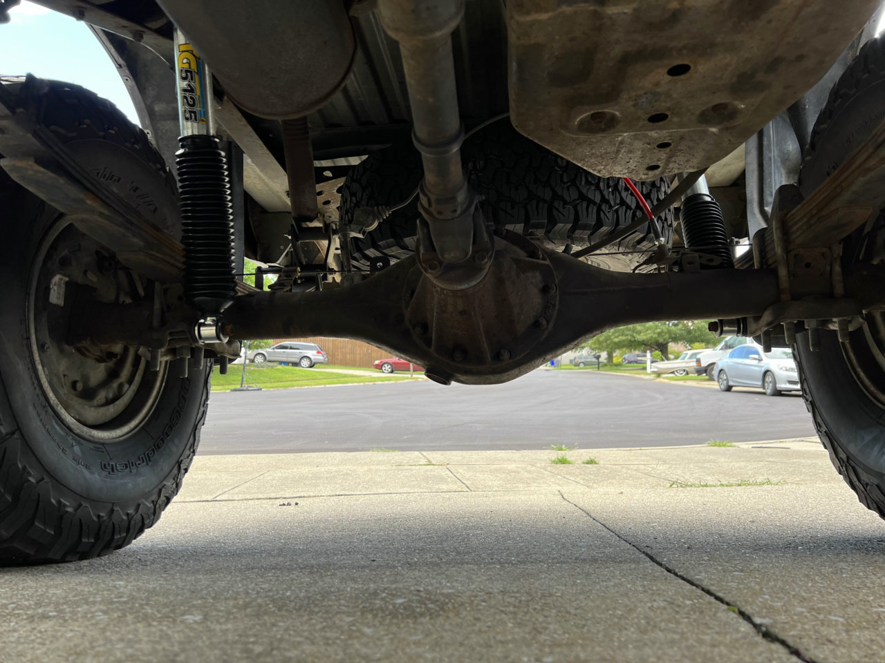

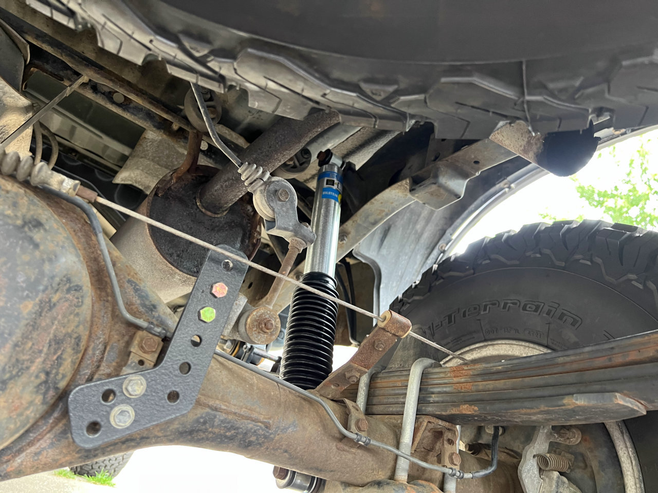

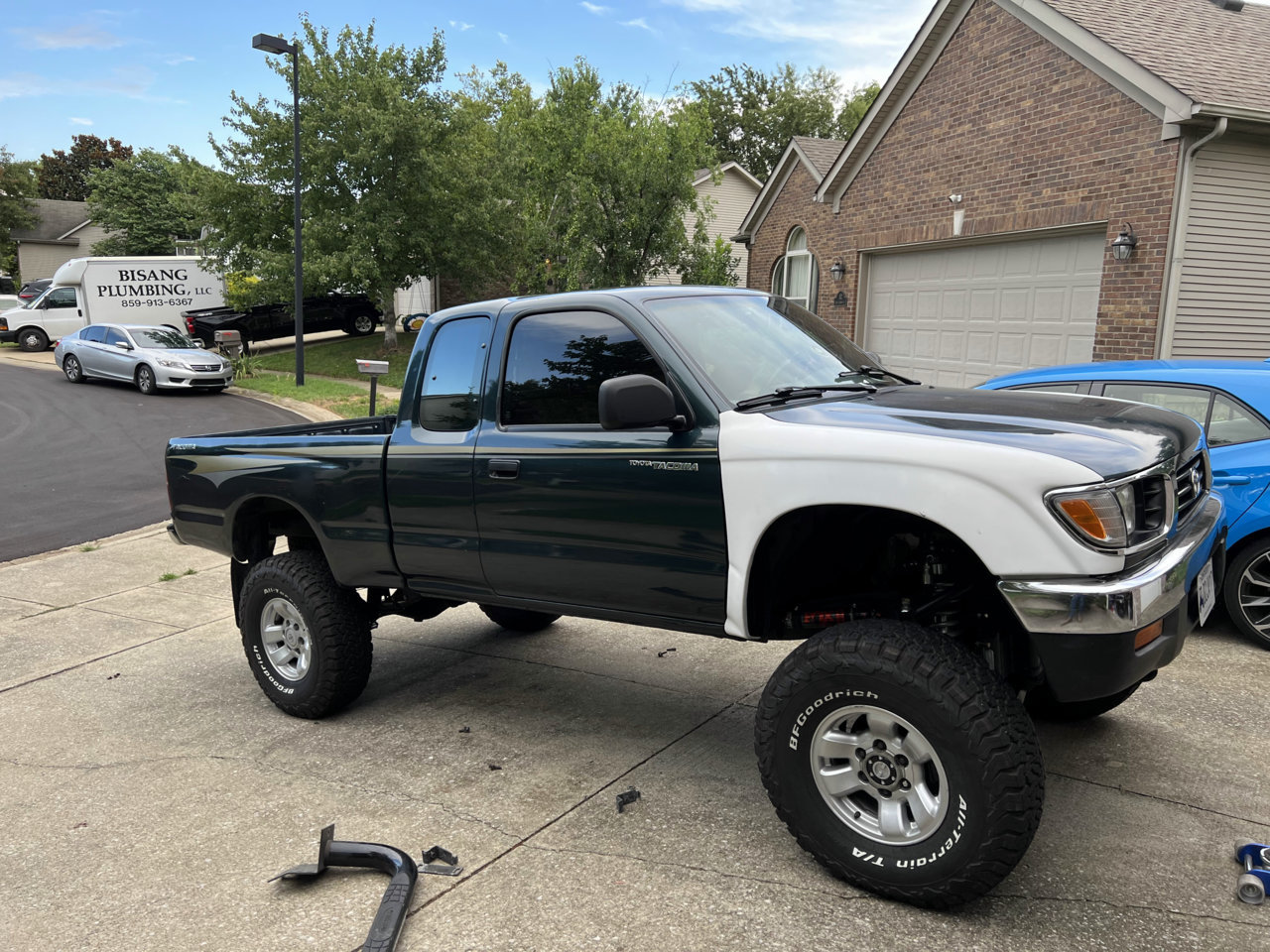

    After dealing with a really rough ride in the rear, I measured the 5100s at ride height and confirmed that they are almost fully extended.
    Measurements at ride height, I believe, were 20.5" driver and 21.5" passenger so I ordered:
    Bilstein 5125 10" travel shocks
    Energy Suspension shock bushings - two sets of part no. 9.8108G - these have the correct I.D. (0.75")
    Toyota washers - part numbers 9094803011 (4X) & 9094803020 (4X)
    I also removed my rear fender flares and the Smittybuilt sidesteps. The truck looks better, I think, and rides much better. Front still needs to be dialed in, though.
    thanks to @Bandido for the assistance, tools and company today!
    Before flare and side step removal
    and After
    Bandido likes this.
