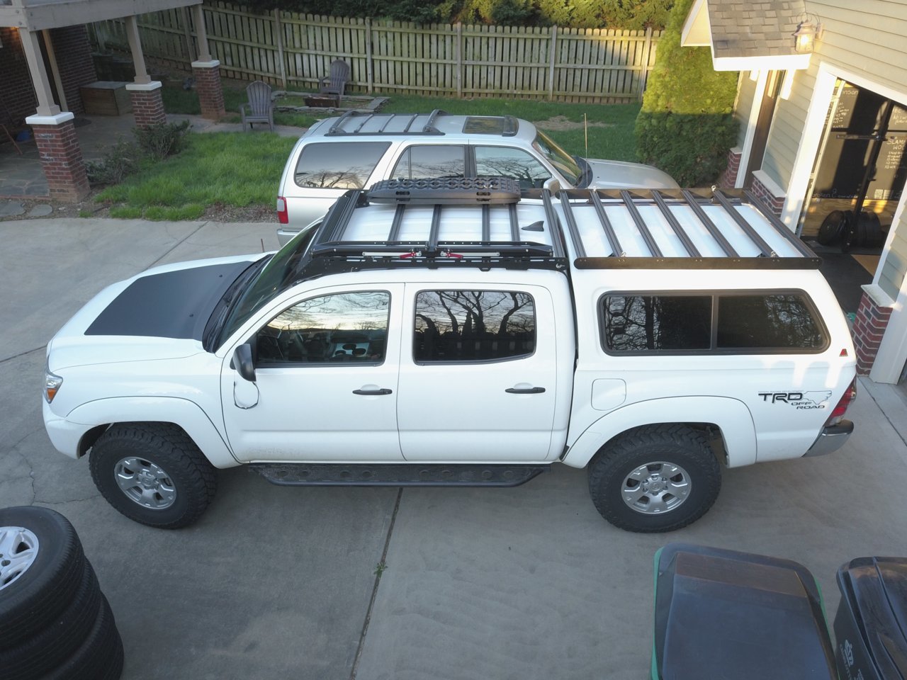

    No I've had it for almost two years i think, it's subtle which is why I like it. Got it from a member on here, think he was out of Hawaii. EDIT: got them from @CBoy808

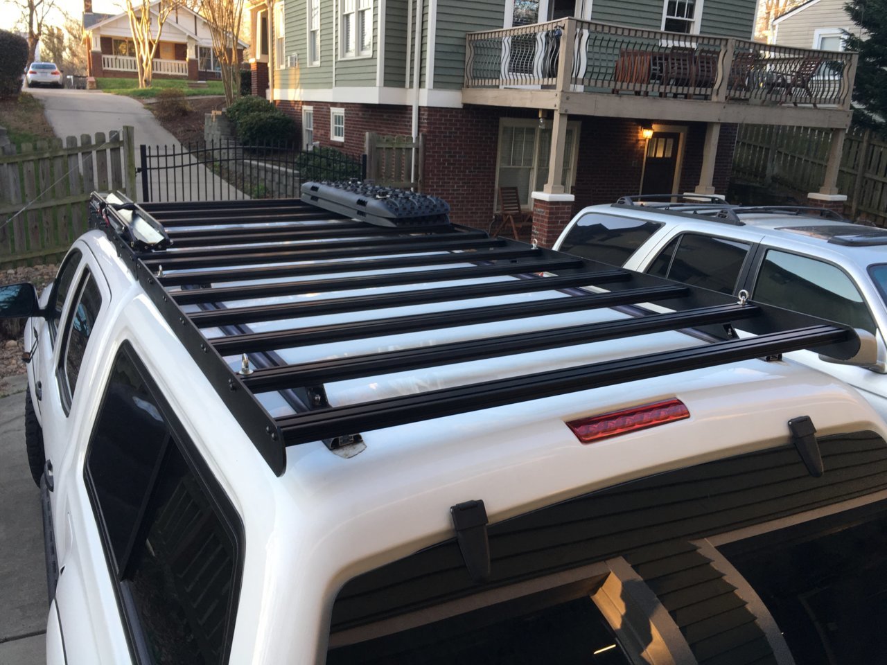

    just the rack on the cap.

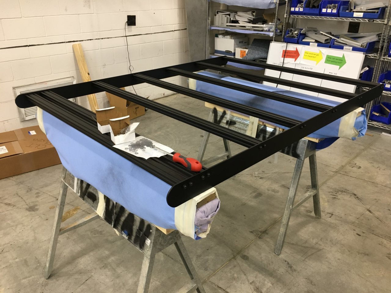

    1/16" x 1.5" steel square tube, mitered, similar to yours. Do you recall what size bolts you used in the tracks on your camper shell?

    1/4" Carriage bolts, I think they are 1" long but that is longer than they need to be. I wanted to use something a little beefier but that was that largest that would fit in the track. I want to lift my camper shell on and off by the rack, but I think it will be strong enough with 8 bolts.

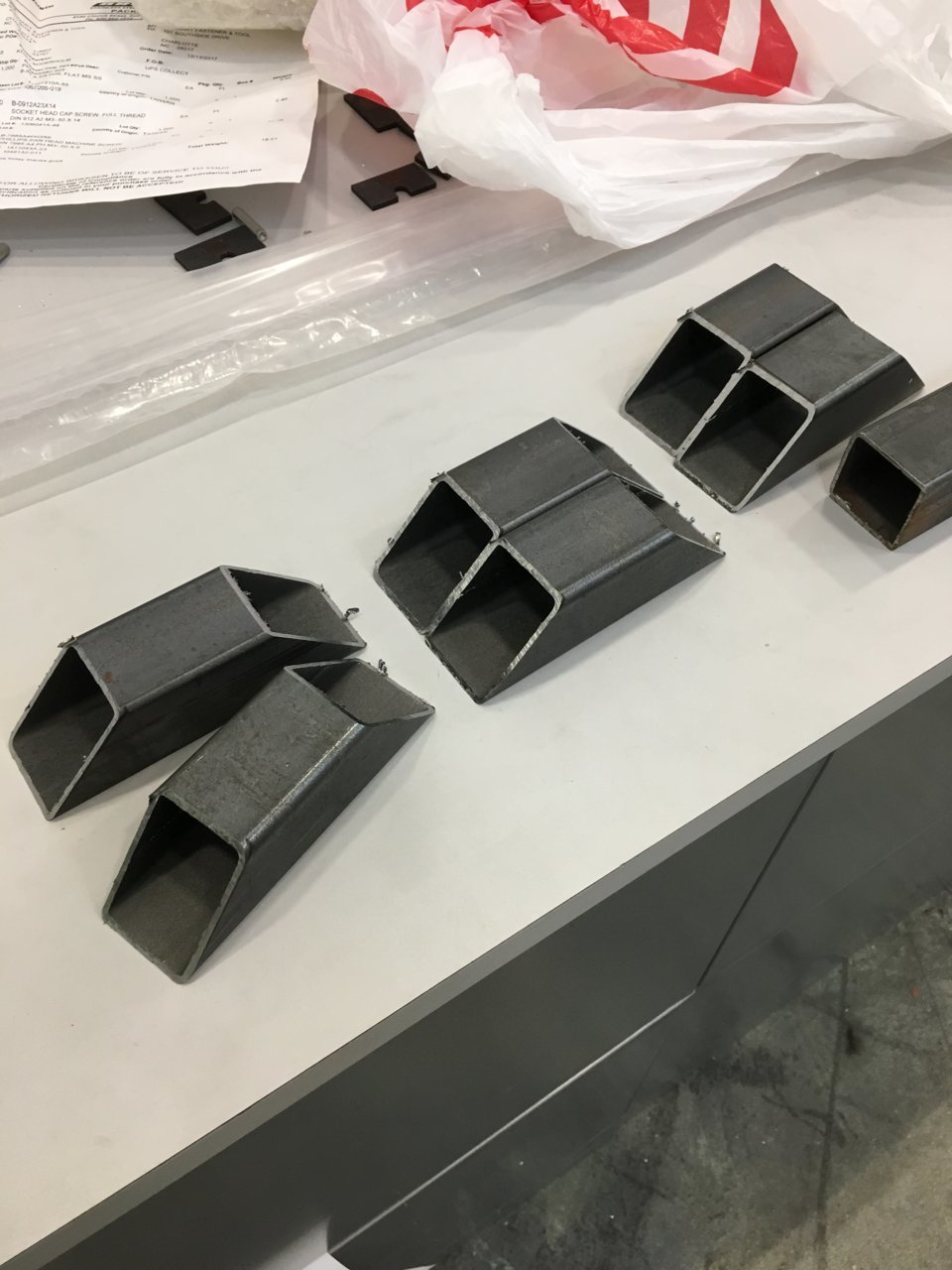

    Got my mounting feet cut and the grade five 3/4” bolts came in for the shell rack. Just need to drill and paint the feet.

    Is that aluminum Andy? Looks like carbon steel.

    It is carbon steel. I wanted a little more strength in the feet vs. aluminum.

    That rust tho! :annoyed:I feel like my square tube feet are still the strongest part of my rack, even being aluminum.

    I'm going to paint them, not worried about rust for a while. You are probably right about the strength, I'm just trying to beef it up where ever I can. That awning weighs 53 lbs. and is made to work without poles, it will place a lot of stress on the rack.

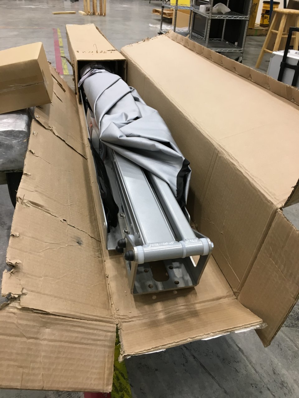

    OH MY DAMN! I didn't see the price. @ajohnson is made of money

    I have wanted one for a long time. It is built really well, and takes literally one minute to set up and put away. If it is really windy, it takes longer to set the one pole and guy lines.
