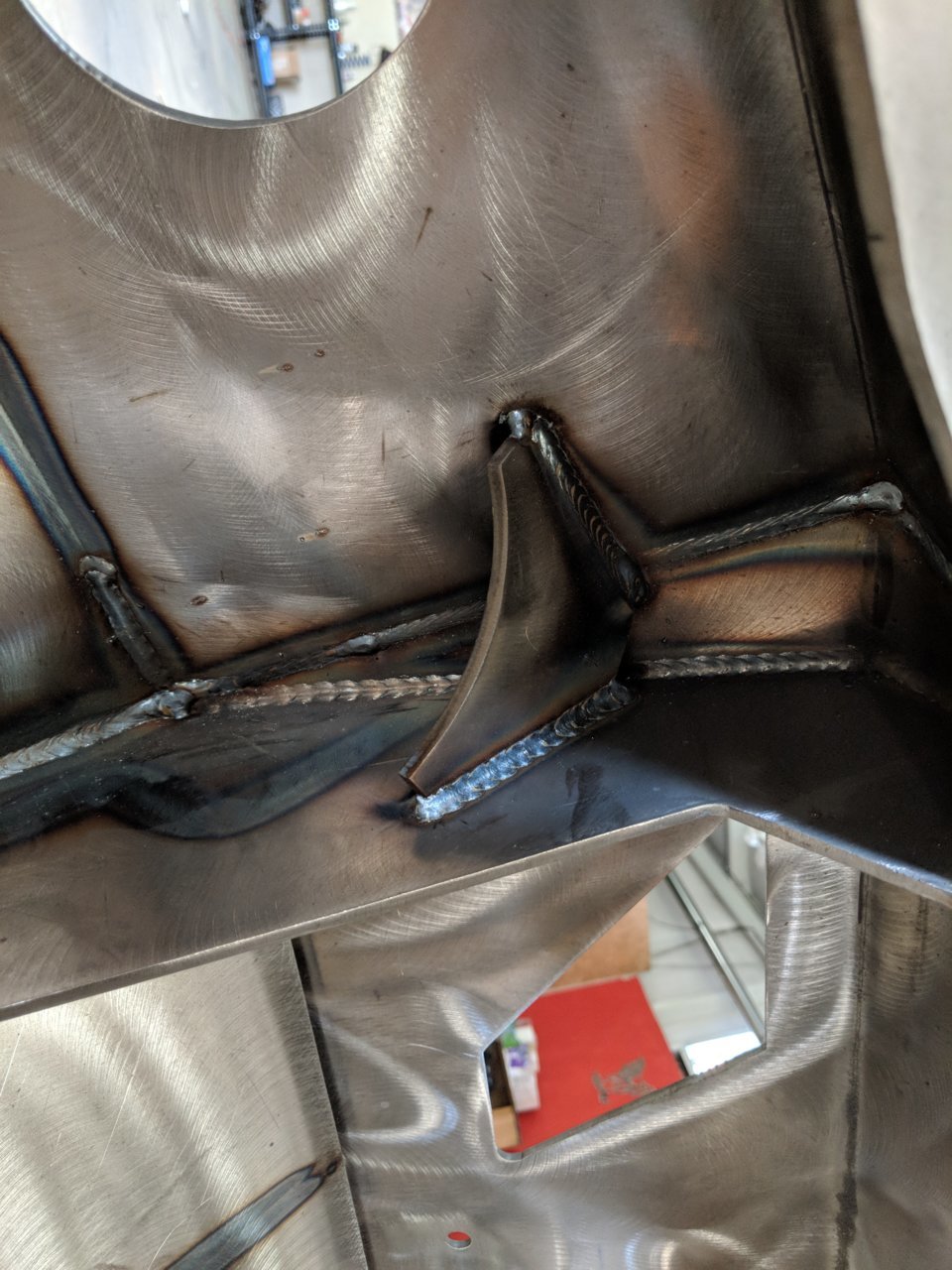

    I think he sent Jimbo a message. They are guessets. Like so. But different models have different stlyesMVIMG_20180414_172614.jpg

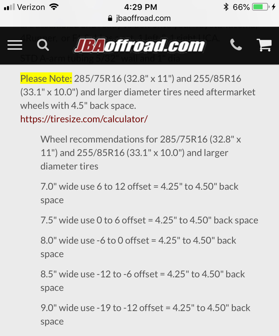

    Thanks for summarizing that. Definitely sounds like the JBA is the right choice. According to their website I can’t run them with 255/85R16 without 4.5” of backspacing. Anybody know how much the stock OR wheels have?

    There is much more than just backspacing for clearance like your wheel width. If you only have a 7.5" wheel which I believe is the stock OR wheel width and run 4.5" of BS then your wheels will be pulled in closer to the UCA where less BS or -offset sets the wheels outboard away from the hub. There is always the test fit and check method or you can mock something up to check to see if you need spacers or not. Tires have no affect of what rubs it's all about the wheel it's width and then BS or offset that locates the tire in relation to the truck and possible rub points.

  10. Apr 15, 2018 at 1:42 PM
    #2930
    ovrlndkull
    ovrlndkull STUKASFK - HC4LIFE
    Jan 7, 2017
    #206806
    37,785
    Skip
    Burlington, NC
    2005 DCLB Silver
    63s, XD Machete, Beat not Babied
    All they are saying is you need to check your clearances. If you have more BS then they'll hit if you have less BS then don't worry about it they kind of made that confusing. A better way of putting it would of been you need a max. of 4.5" of BS to clear less and you are golden. Also their BS is taking into account an additional 1/2" of lip that the wheel weights hammer onto this is not an industry std and some wheels don't have those lips. Offset is based on the centerline of the wheel and IMO a much better way of doing wheels because of that lip issue I spoke of earlier and IMO more accurate (bc metric system!).
    You can easily measure your BS by taking your wheel laying a straight edge across it and measure from the mounting surface to the straight edge.
