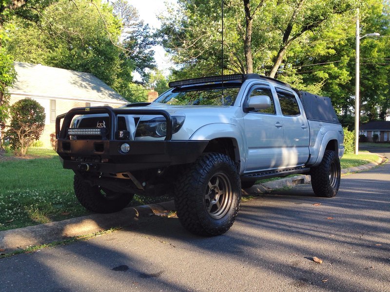

    :woot: I used to struggle to park on my curb, but now with ferbahfer convert it is too easy

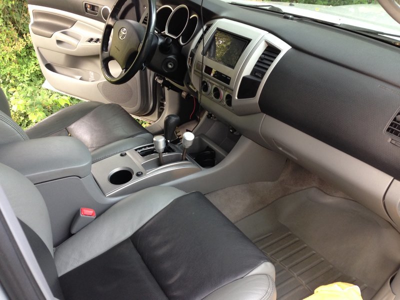

    A shop cut the rear tube section and added a 1330 slip yoke and spline stub, and shortened the front section with a flange yoke to bolt to the tcase flange. It's hard to find a DCLB driveshaft so this was best for me.
    Look at your carrier bearing crossmember, there should be another set of holes in the frame behind it, if you wanna go to the trouble of cutting the rivets out you can move the crossmember and should be able to bolt up a 4x4 rear shaft. Other wise you will to do what I did or modify each section of a 4x4 shaft.
    ahspurlock[QUOTED] likes this.

    Oh, and...
    I need to paint the sticks and have a leather boot made.
